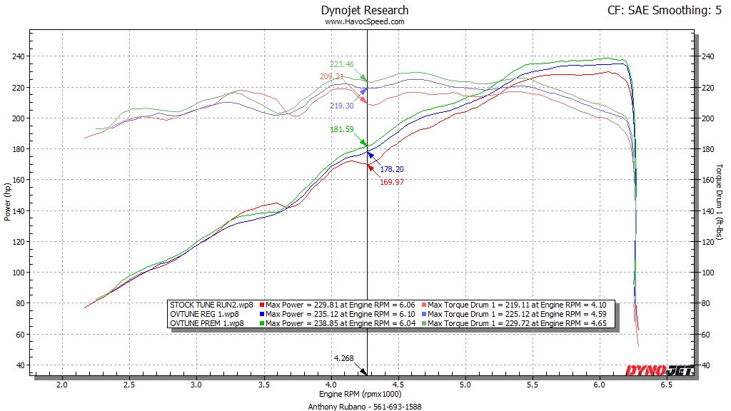

    Frankly both dyno's posted in the last two pages were using "std" calibration, which doesn't account for weather. This is a chart of ovtune using SAE calibration on a stock 2016 with 265-75-16" tires on stock wheels.
    Not saying STD isn't useful but there's been companies out there that will test a product and use a heat soaked car, then retest at night when it's colder so show massive gains.
    I wouldn't expect tunes to vary much in peak numbers, and peak numbers don't mean much anyways.

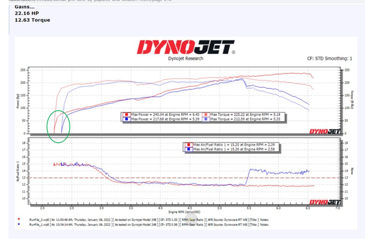

    Hi Guys. OK, here's my question... is the gap between the red and blue curves at the beginning actually speaking to the improved responsiveness / overall drivability of the KD Max Pro tune vs. stock tune? It does seem to suggest that as everything takes off from a lower initial RPM (the response time must be faster), but whereas no one has made this statement yet, I thought I'd go ahead and ask as the engineer in me is still looking for an objective piece of data to go with the many subjective accolades that have been put into the public domain about this Tune. :pccoffee:
    Thank you.

    Sorry, I meant to paste this in (with the gap I asked about circled in GREEN. Thx.

    One run was just started at a couple hundred RPM's less than the other

    Yes the overall responsiveness and drive ability is enhanced with the Pro tune over stock. I think we have many members state in reviews coming from stock to KDMAX-Pro how much better there truck responds and what a pleasure it is to drive. I don't think you will be disappointed!
