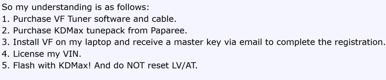

    Is there a thread or a reply somewhere that explains the process of doing the tune DIY?
    I’m just generally curious how it’s done.
    Thanks!

    First post
    If you want to do it yourself
    Go to @tonered's thread for ECU TSB updates to get up to date first.
    ECU TSB Update | Tacoma World
    Then go to www.vftuner.com and buy the $389 Software with cable.
    Then, PM me or Dave (@PapaRee, or @TWTaco) for tune-pack- $300
    In the VFtuner software>>>go to the Help>>>Installation instructions to learn how to use it.

    I gleaned this short version from within this thread as I remember.... (sorry I can't credit the author)
