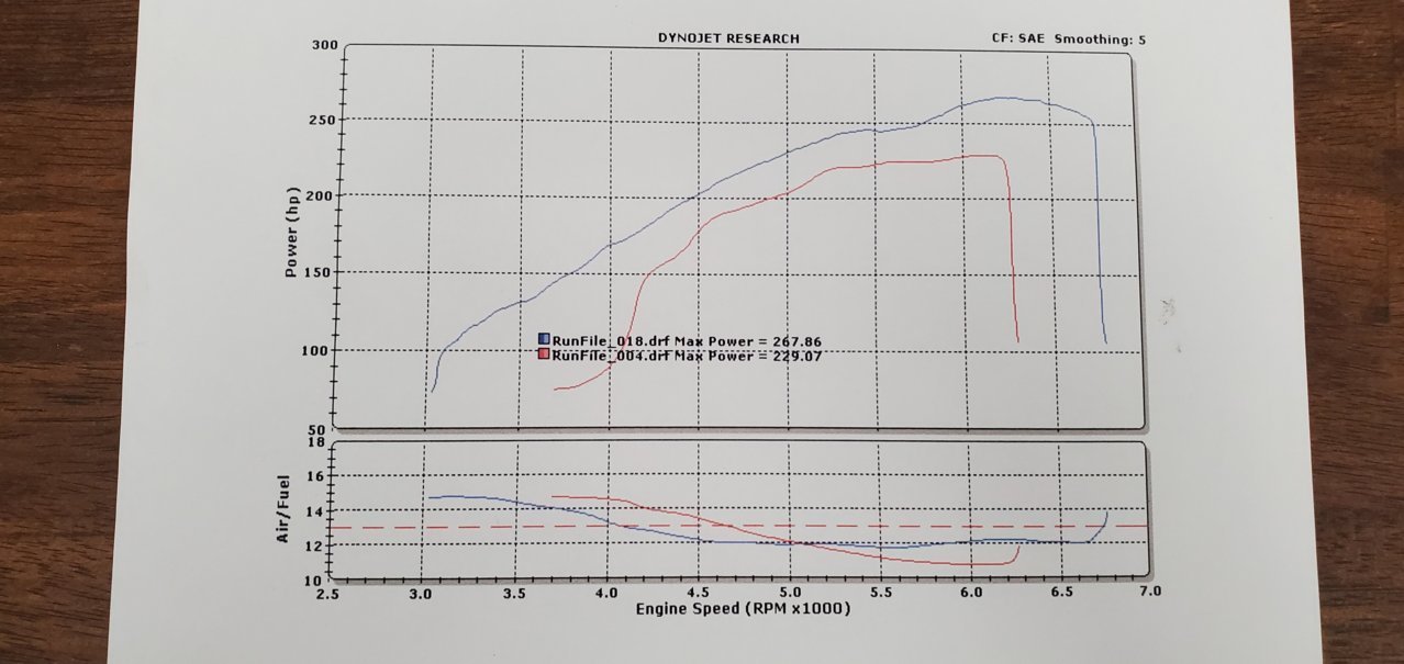

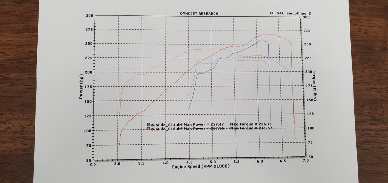

    Made it in for a dyno run today...I think this might be the first independent dyno done, and probably the first on stock gearing.
    First chart is intake/exhaust on stock tune vs intake/exhaust with KDMax Pro. Second chart is bone stock vs current setup showing AFR's...wanted AFR's for current setup stock vs KDMax but he printed the wrong one and I didn't realize it until I was home.
    Gains were +10.4hp/+14.9ftlbs, both runs done on 91 octane...slightly disappointed as I was expecting a bit more with a performance exhaust and intake compared to their posted dyno showing gains of ~22hp/13ftlbs (on 33-34" tires) and a previous dyno claiming +37hp. But while the top end didn't have big gains, there were definitely some good low end gains where it needs it the most...unfortunate that with the stock tune I couldn't gearlock to get numbers lower in the RPM range.

    I have done hundreds of dyno tunes over the years. I don’t want to offend you by saying this but the first graph is missing so much data it’s almost useless as a comparison. Second graph is a better comparison but also flawed unless the pulls were done on the same day or identical conditions. As much as they say they can normalize the data the engine still responds differently, heck even gas can cause some of it.
    all that said appreciate you sharing your results and that’s a nice improvement over stock. Please share your exhaust and intake specs.

    Thanks Derek, looks good, glad to see the gains with the tune.
    Looks like stock runs very rich at high rpms. KDMax-Pro stays around 12, which is good.
    Also it looks like you gained 38.79hp from bone stock to your current setup with KdMax-Pro+intake+exhaust. (267.86-229.07=38.79hp)
    Very nice! Glad to see the low end gains too!

    @758_Moto Same day test on the same Dyno? Curious how much atmospheric conditions might have changed? That increased low end power looks very nice!
    Can you share the city or your approx elevation of the shop where you got on the Dyno?

    I respectfully disagree. Same day back to back runs made sense 30 years ago with carbs and distributors but in the modern world of fuel injection and computerized everything, the ECU needs time to adjust and optimize any changes made, especially something as significant as flashing a tune...most of which take 1000+ miles to fully settle. That said, sure, of course there were slight variables as these tunes weren't available 2 years ago when my last run was done.
    RunFile_14 (stock tune): April 2020, 10kmiles on the truck, ~65 degrees, just rained/slightly humid, almost new 31" tires/stock wheels
    RunFile_18 (KDM tune): Mar 2022, 53kmiles on the truck, ~67 degrees, clear day/no humidity, almost bald 31" tires/stock wheels
    Has the engine lost a negligible amount of power/performance in 40k miles? Maybe. Transmission fluid and engine oil were just changed at 50K miles. Both runs done on the same dyno by the same tech, with clean air filters and Chevron 91 octane gas. A little humidity and heavier tires on the stock tune were the only real variable, both of which would cause power loss for that run. Would have obviously been nice to do the runs closer together but it wasn't an option. That said, I would bet that if I flashed back to stock tune and put it back on the dyno there would be hardly any difference in numbers, if not an increase with lighter tires.
    Running a modified URD exhaust and AFE Momentum GT intake. Last night I swapped the stock airbox back in with an HPS intake tube, I'll be back on the dyno Wednesday to see if that performs any better.
