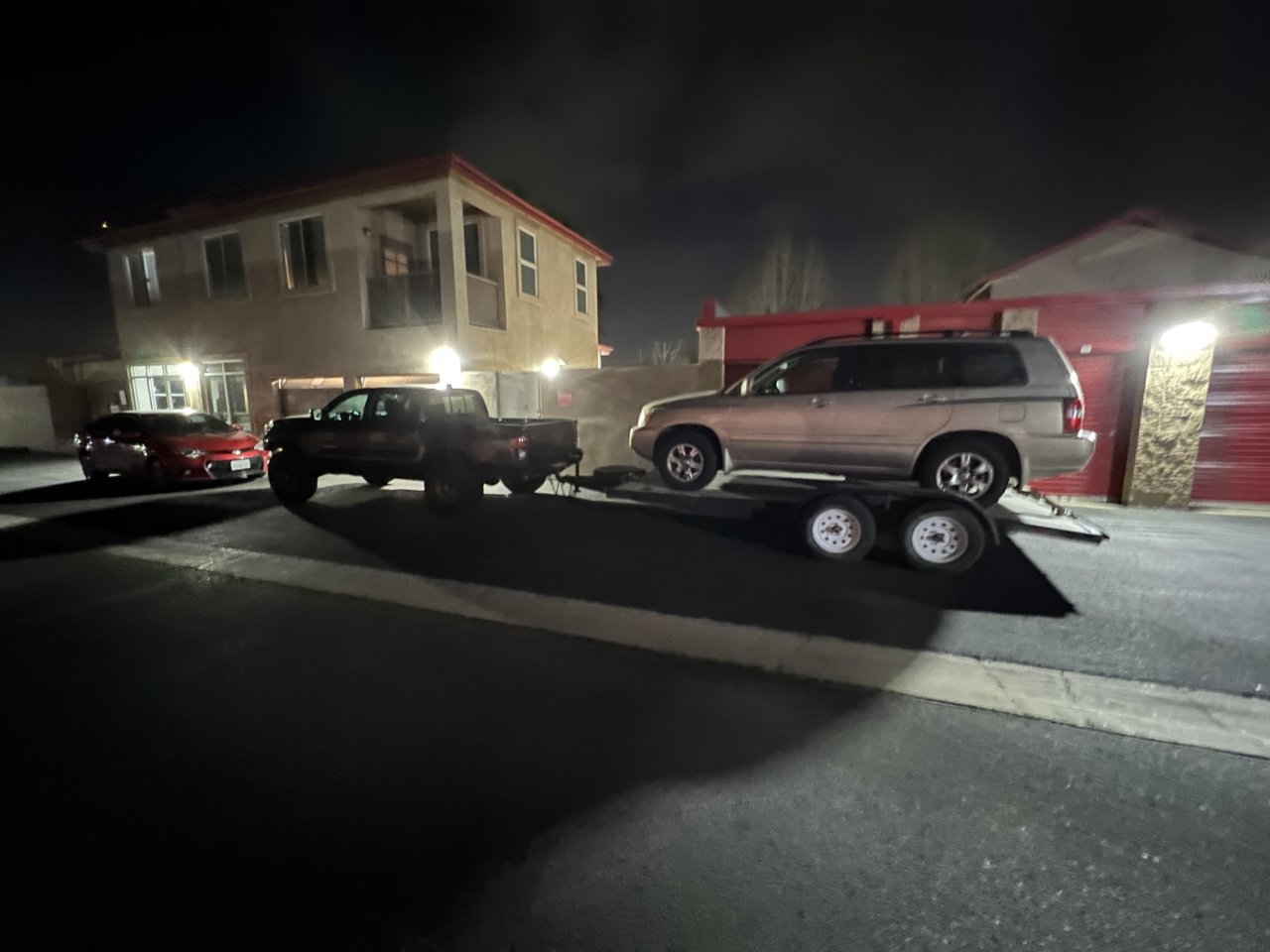

    Anderson5290
    Anderson5290 Well-Known Member
    May 30, 2018
    #254979
    758
    Brandon
    Corona, Ca
    2018 Tacoma TRD OR 4x4
    Tuned Fox 2.5 resi with dsc, JBA HD UCA, total chaos knuckle gussets, rear trd pro fox shocks, Deaver U402 stage 1 rear leafs, archive garage u bolt flip with fox 2.0 air bumps, White knuckle off road rock sliders, BAMF 1/4” steel skids, Magnaflow exhaust, Archive Garage Hammer Hangers, Cbi high clearance rear bumper, 285/75/16 tires.
    Just towed this baby 80 miles with the Pro tune. I’m guessing I was about 5,700 lbs, plus all my heavy armor and 35s. So max tow capacity for sure.
