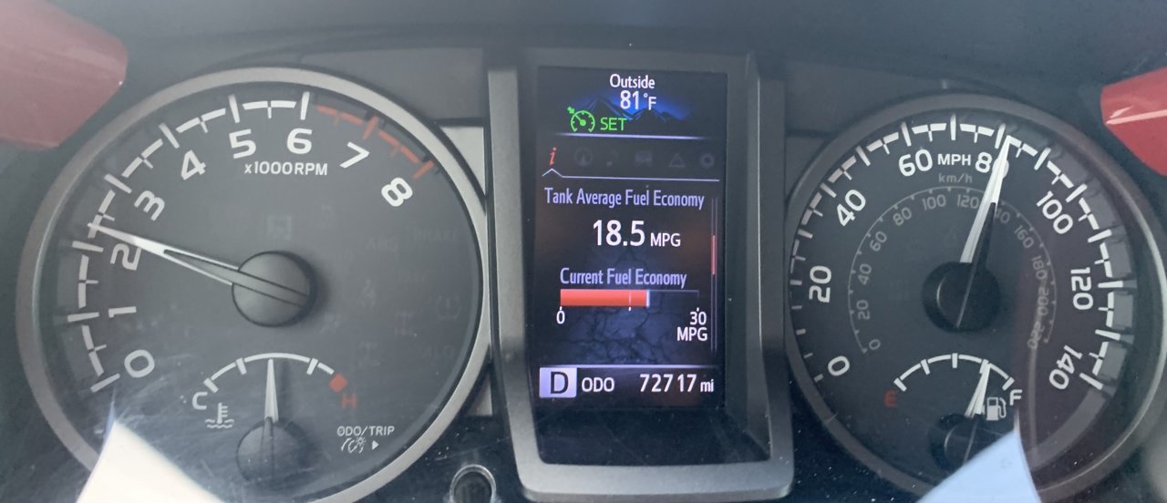

    Edit - Premium fuel (93)
    *Full disclosure, there was a nice tailwind.
    BUT I have made this drive literally hundreds of times with my truck on different tunes and with different size tires, etc, lots of variations with headwinds, tailwinds, no winds...
    It has never driven as smooth and held gear as well, especially in cruise control.
    This was on the way back from Corpus Christi to San Antonio.
    Cruise set at 81mph with minor slowing and speeding up to accommodate passing on I37 which is a two-lane highway, rolling hills, lots of very long, low grade inclines and declines, more inclines on the way back up from the valley area to hill country foothills. (speed limit is 75)
    176 miles, cruise control was on for about 140 of those miles.
    The pic was taken about 120 miles into the trip. Fluctuated from 18.2-18.6 while cruising.
    If I had not been on cruise I likely would have been near 20mpg. Pro+ is the real deal.

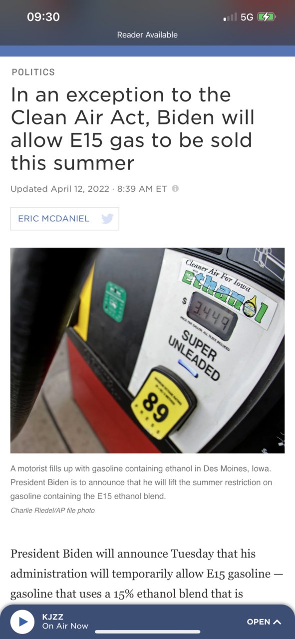

    Not being political at all, but curious if this will affect tunes, do the tunes have enough corrections to accommodate higher ethanol numbers?

    I had the same thought about my truck and my "fun car." Will be interesting to see. I found one gas station around me that provide 0% eth gas. I go there as much as is convenient. Especially for my fun car. Just runs so much better on it.

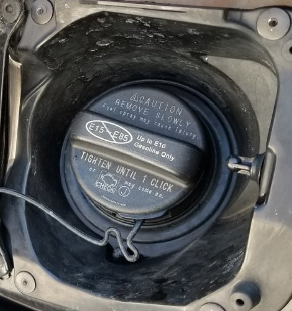

    When you go to pump your gas next time, look at your gas cap. It is a hardware/fuel system limitation.

    Ahh okay. I covered mine up with a label that says PREMIUM ONLY!! Just in case the gf fills up (never happens haha). Good to know buddy, thanks!

    Ah shit. My cap either says something else or my reading sucks. I put in like 2 gal of E15 because it was notably cheaper. Just to top off the tank prior to heading out into the desert. Is my truck gonna assplode? I did a quick Google and looks like some others have done a full tank of this and are still standing.
    Obviously I'll not do this again to save a few pennies. Just curious what I'm looking at.

    If you’re really concerned you can always siphon some out and top it off with regular.

    I'd think 2 gallons would be diluted and you'll be fine.

    I am sure you will be fine with that small amount. I have also read of a few people that have ran a full tank of it. I think it has long term affects on seals, certain plastics, certain metals, etc.
    The E15 is only 15% ethanol compared to E10 at 10% ethanol, so I would not worry about it.

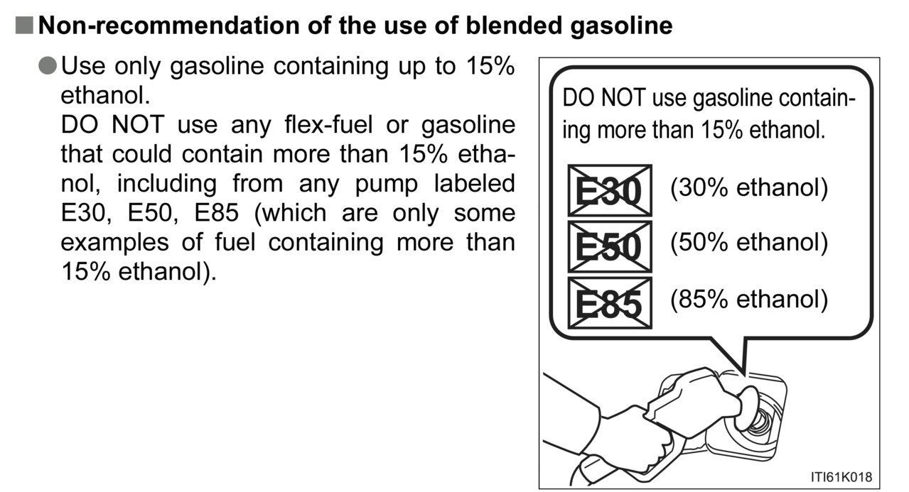

    Actually, take a look at the manual. It states not to exceed 15%. 2017 and 2020 both state the same (see attached).
    Note: I just downloaded the 2017 manual from online. I'm not sure if the online manual has been updated or not compared to the hard copy. Now I'm actually curious if the hard copy/paperback manual states this.
