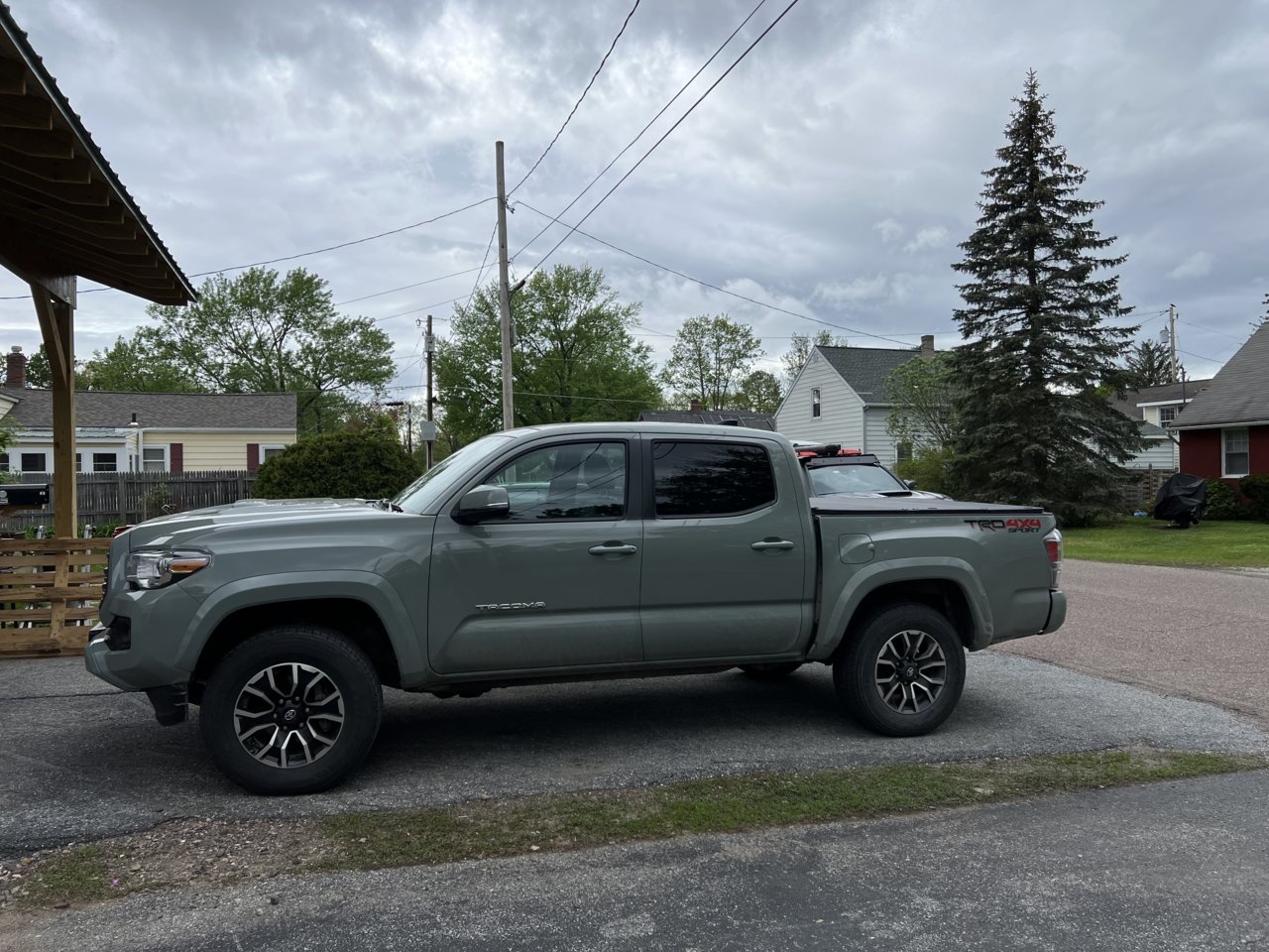

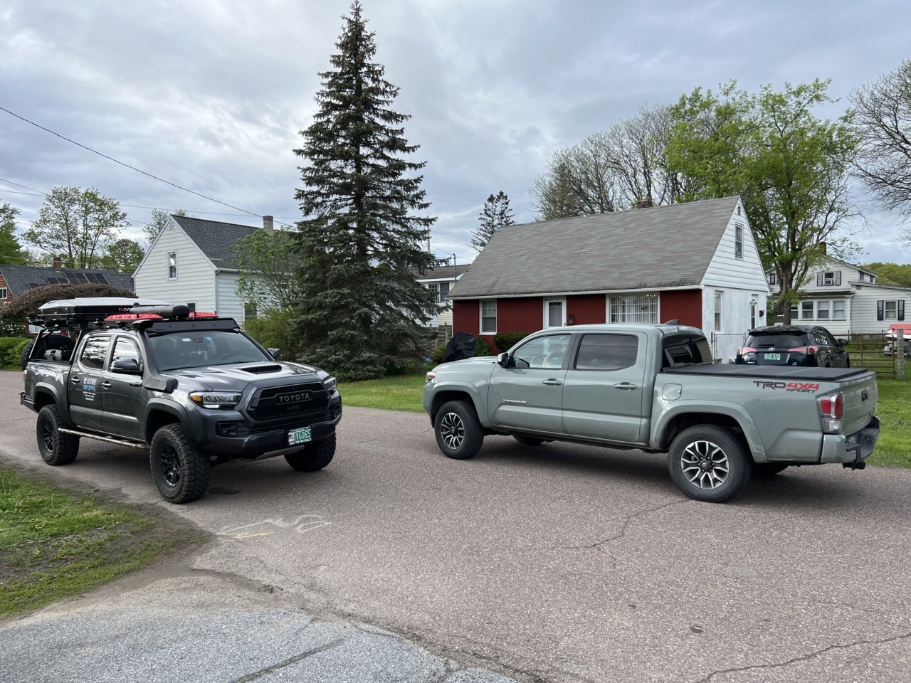

    Oh man…
    Pro+, normal throttle for a good friends 22 Sport AT. After some joyful swear words and a lot of giggling it’s good to hear “My truck doesn’t suck anymore!” Suck an awesome tune for these trucks!
