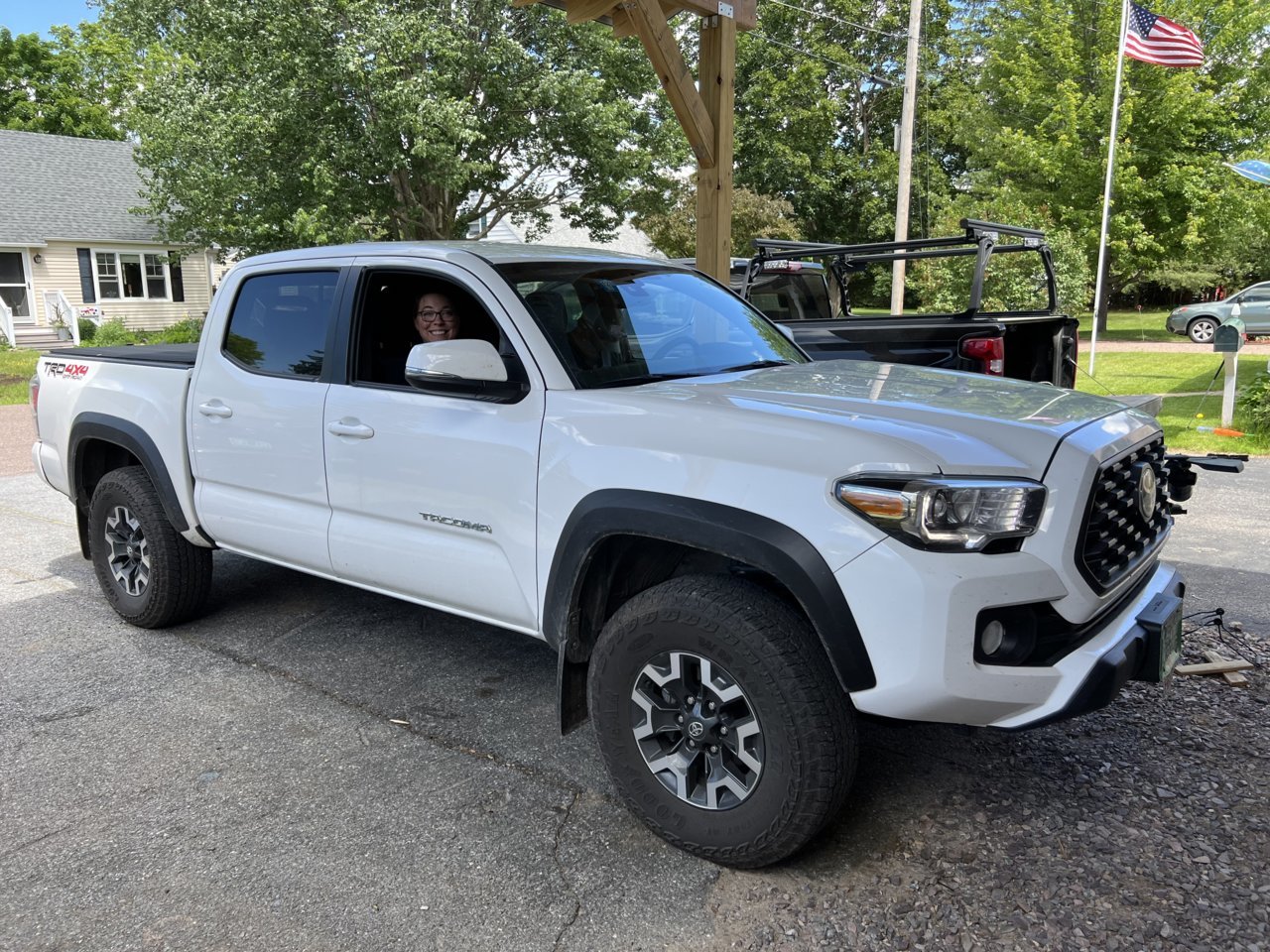

    Our neighbor surprised his younger brother with a tune for his 22 OR. Awesome to have the opportunity to tune a good friends truck and have good friends support the business! The test drive got a lot of smiles, even from the tuner :D

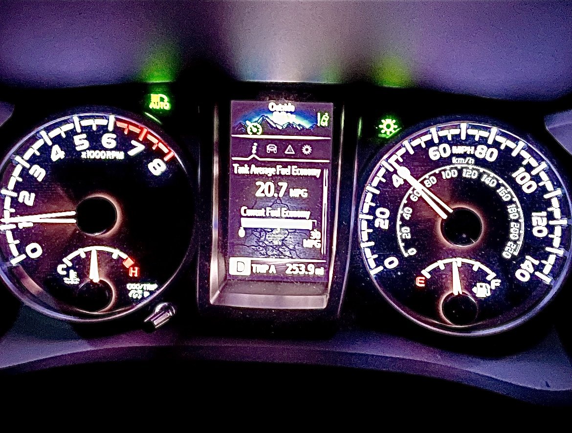

    @PapaRee @TWTaco Took a little camping trip over the weekend and thought I’d post my unscientific real world data from a 500 mile round trip on KDMAX Pro + XT normal throttle.
    Upfront I’m a KDMAX Pro tuner so there’s that. But I’m a tuned truck believer and expect a product to deliver on claims. And with that said KDMAX “does not claim MPG or Adaptive Cruise Control (ACC) improvement”. But here’s my test to see if what I initially “felt” wasn’t a placebo effect because I want it to be true
    My test trip consisted of a 287 miles one way North from Vancleave, MS to McCalla, AL (just south of Birmingham, AL.) And a one way reverse course heading South back to Vancleave, MS.
    Truck, 2022 all stock Toyota Tacoma (3rd Gen) except RCI sliders (95#). Three adult men average weight 195#, loaded with approximately 300# additional camping gear and items for a 3 day archery camping event. Total extra weight not including driver was #690 pounds.
    After tuning truck with the XT tune normal throttle I had tried ACC at home on I10 and it “seamed” to perform similar to standard cruise with the tune. Standard cruise to me had always followed tuning map scripts, ACC had its on way of thinking and continued to have the power downshifts that shot up to 3500 to 4000 RPM’s on slight to moderated grades. I live on the Gulf Coast so consider that when thing of our grades….pretty flat until turning North.
    On the trip heading north I didn’t use the cruise much (both standard and ACC), but did try them and again both appeared to have same shifting characteristics (improved). Both downshifted to 4th on the more moderate grades and would hit 3000 RPM’s but no higher. Long sloping grades or inclines the RPMs stayed at 2000-2100 In the past this would be 3500.
    On the trip North I did monitor my mileage but not hand calculated. I have checked my trucks information gauge readings to hand calculations and it is within .2 tenths of MPG if not closer. Finding a method to get exact amount of gas each time in tank can be tricky. I now stop fueling at first click and pump 1 gallon more to hand calculate.
    Leaving from my house to go pick up buddies I started with a half a tank and was reading 21.4 and turning North maintained this the 40 miles to pick them up and there gear. Once on the road loaded headed North the MPG’s bleed off to 19.2 to 19.6 with both cruise set on 72 for maybe 50 miles at most before switching off and just driving. Without cruise my speed modulated between 72 to 80 +. When I’m talking I’m like a yo-yo on the pedal, lol. Arriving to Tannehill Ironworks State Park for the weekend I was reading 19.2
    After running around the park and town over the weekend locating reliable internet for a customers tune it was at 18 by the time we left. There was considerable engine idling going on due to heat and seeking AC
    Return trip heading South and down. We initially stop 35 miles from the park at Tuscaloosa, AL to eat and fuel up. From there to home I monitor gas mileage and cruise control behavior in equal mileage spans of approximately 120 on Standard and ACC. I seen or felt no difference in the two I had the same improved performance the tuned brought to the standard cruise.
    I averaged 20.7 MPG with cruise set at 70-71 MPH over the course of the final 254 miles.
