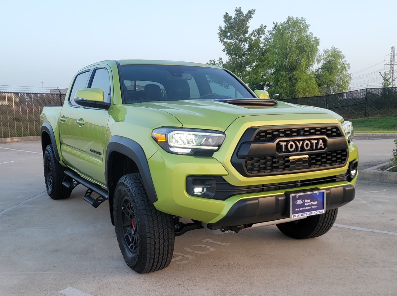

    POSTING A REVIEW FOR KDMAX PRO AND KDMAX PRO+XT ON A MANUAL TRANSMISSION
    1. KDMAX PRO+XT
    - LAMBDA (AIR/FUEL MIXTURE) OF THE ENGINE IS ALWAYS BEING CLOSE TO 1 AT ANY RPM
    - SHORT TERM AND LONG TERM FUEL TRIMS WAS GOOD
    - TORQUE IS OUTSTANDING THROUGH OUT ALL GEARS
    - LESS DOWNSHIFTING COMPARED TO PRO TUNE ( STEP ON THE GAS AND IT WILL PULL THE TRUCK )
    - MAXIMUM MPG REACHED AT 18MPG
    - THIS IS A PERFECT TUNE FOR BIGGER TIRE UPGRADE (YOU DON'T NEED TO RE-GEAR DIFF BECAUSE OF THE TORQUE THIS TUNE IS GIVING OUT)
    2. KDMAX PRO
    - SHORT TERM AND LONG TERM FUEL TRIMS WAS PERFECT
    - PERFECTLY SMOOTH RUNNING ENGINE (FEELS LIKE YOUR TRUCK WILL REACH 1 MILLION MILES WITHOUT A PROBLEM)
    - LESS DOWNSHIFTING COMPARED TO STOCK ( STEP ON THE GAS AND IT WILL PULL THE TRUCK )
    - MAXIMUM MPG REACHED AT 20MPG
    - THIS IS A PERFECT TUNE FOR AN ALL STOCK DAILY DRIVER BUT WANTS MORE POWER THAT IS FAR OFF FROM STOCK.
    ALL TUNES WAS GIVEN CLOSE TO 1000 MILES AND 2 TANKS OF DAMN EXPENSIVE FUEL EACH. HAHAHA
    MANUAL TRANSMISSION IS ALWAYS FUN TO DRIVE. YOU ARE THE MASTER OF THE CAR, YOU DECIDE IF YOU WANT TO BLOW IT UP OR NOT.
    THANK YOU @PapaRee AND @TWTaco [​IMG]

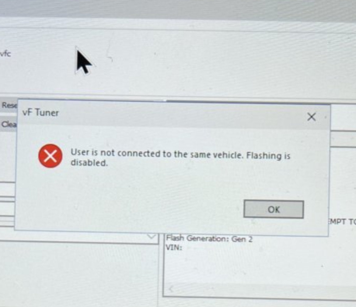

    Reminder
    If you have a HUD- Heads up Display from KTJO4x4, you have to disconnect it to flash a tune on your truck. It will give you an error “User is not connected to the same vehicle. Flashing is disabled”
    After it is disconnected, you can flash the tune to the truck without any problems. Then you can re-connect the HUD.
