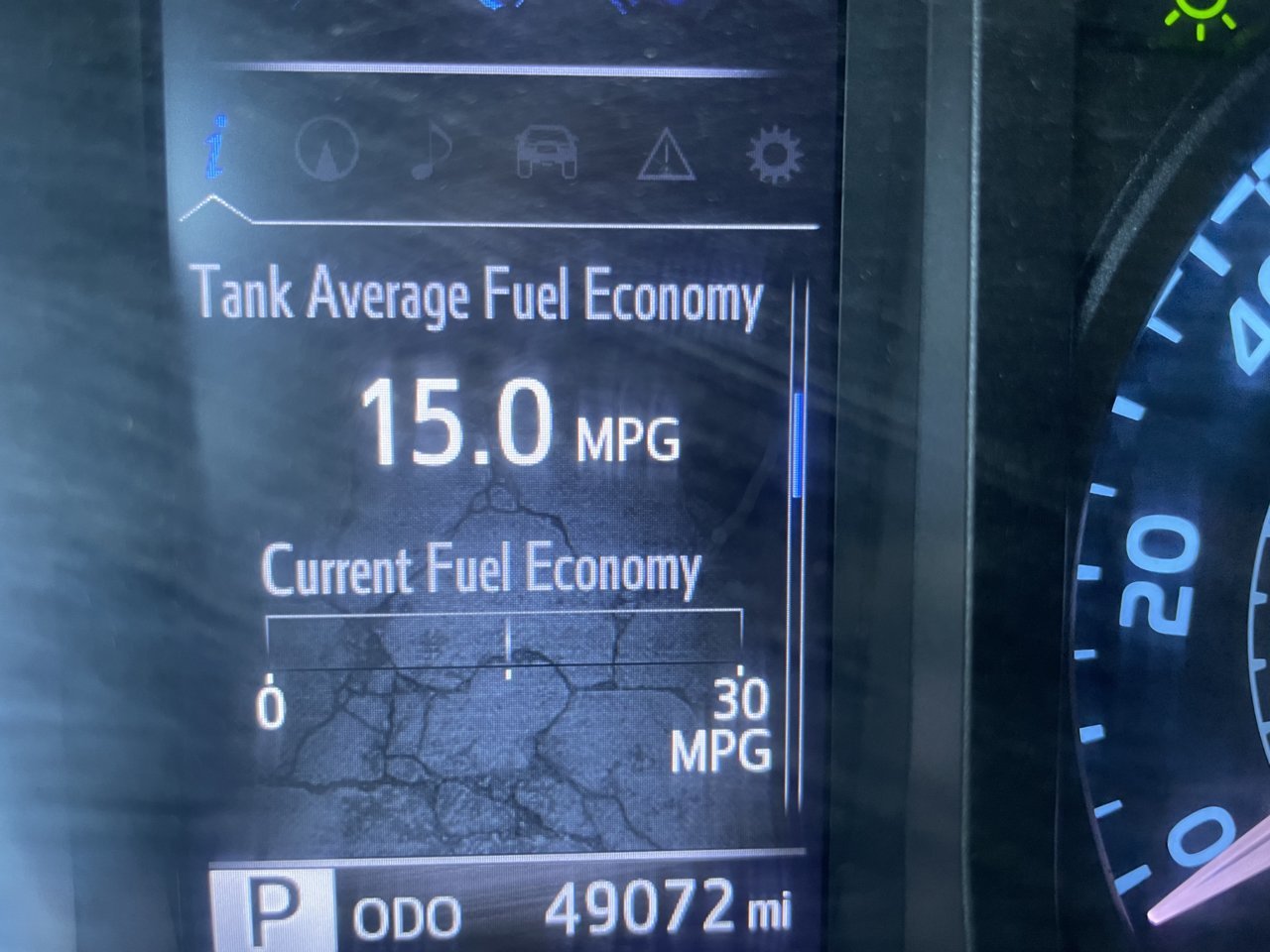

    Updated from KDMAX original to KDMAX Pro+XT about a week ago. I’m only getting this:

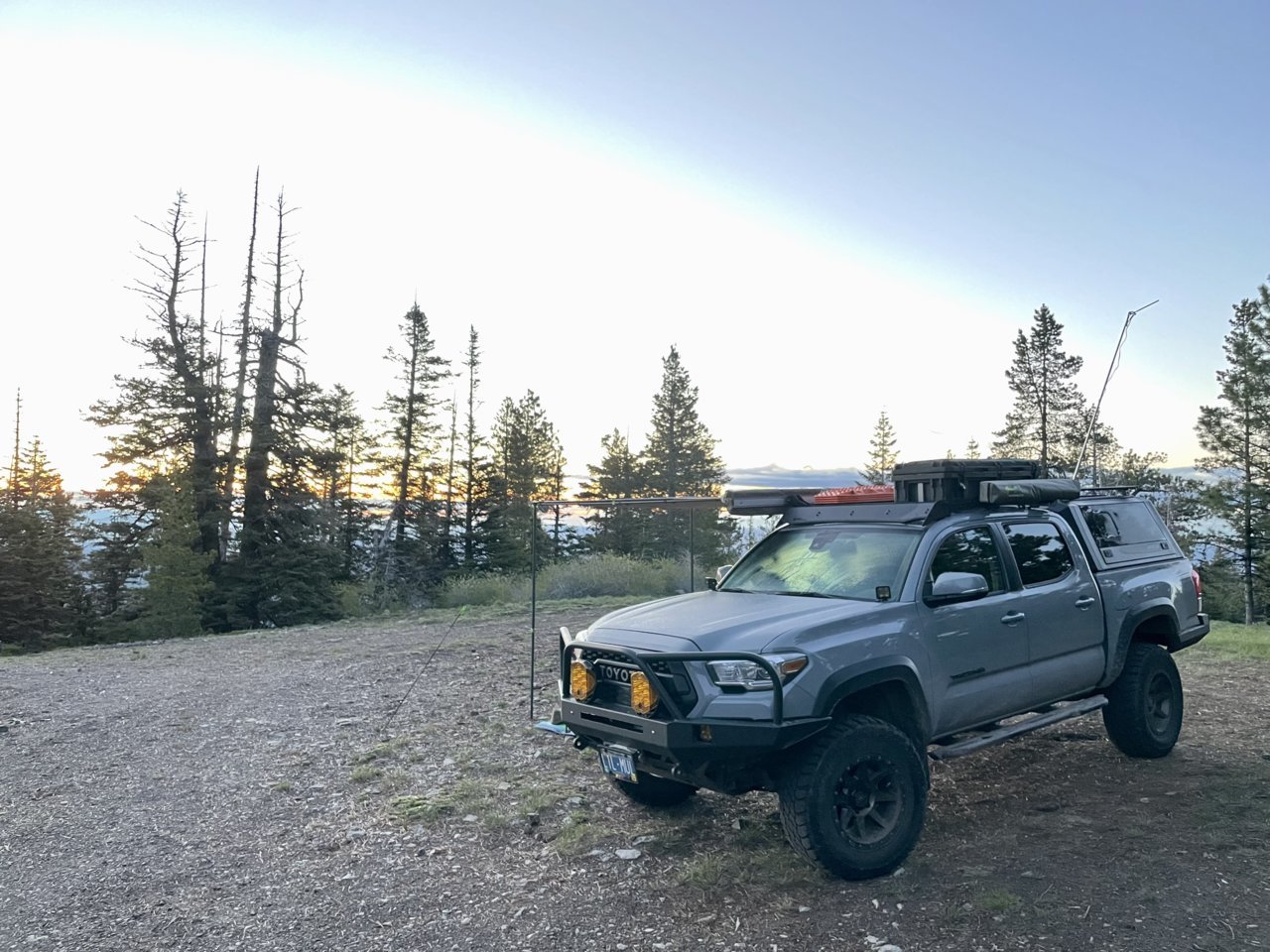

    But the truck looks like this:
    She’s a little on the thick side. Steel bumpers with swingout, sliders, skids. 13gal water tank, RSI topper, camp gear, 33s. I was getting MPGs in the low 13s before the new tune. Now it’s up to 15 mpg on the new tune. Pretty happy with that given I live in a hilly and mountainous state.
    Man, I am liking this newest iteration of the KDMAX offerings. The truck drives really nice on the highway and up long hills without me having constantly give her a little more pedal to keep speed. The XT tune keeps the truck moving no matter where I am in the power band. No more flooring it just to get it to down shift. Really smooth movement through the gears. I think my mpgs improved just because I don’t need to mash the pedal to get up hills. Just imagine how good my mpgs would be if I didn’t drive like a jackass! Excellent tune.

    Yeah she is a heavy girl! What are you weighing in at about 6600lbs loaded?

    I really should find out. I’m not sure if I’ve passed the GVWR. I’m scared to check.

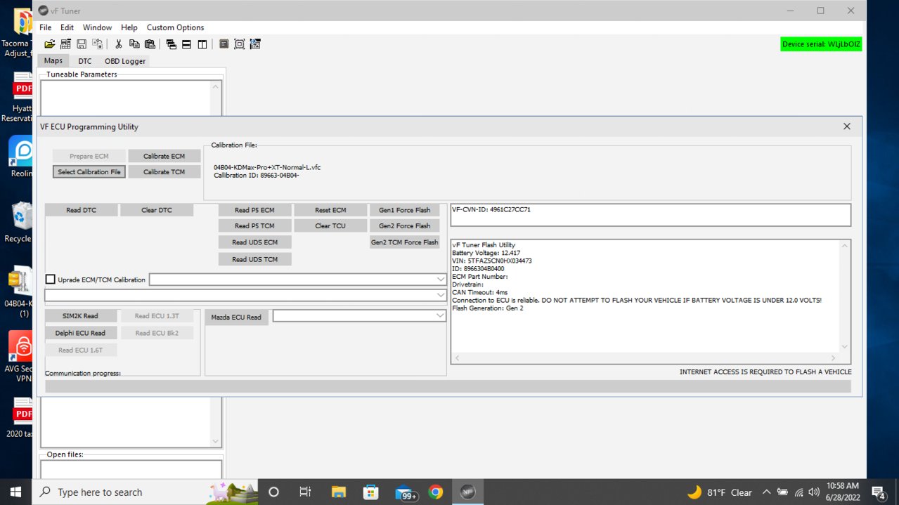

    Just upgraded from the OV Tune program to the VF Turner program. Just prior to flashing the KD Pro XT to my 2017, I noticed the text in the turner notes reads, Gen 2. Did not see any information about the Gen 2 notations in the download instructions.
    See the attached pic.
    I'm guessing that has nothing to do with Gen 2 or 3 trucks, maybe some type of software note?
    Just in case, I decided not to flash until I could get the opinion of someone with more knowledge about this.
    Thanks!

    To flash your truck.
    1. Prepare ECM
    2. Select Calibration file
    3. Calibrate ECM
    Gen 2 is used for recovery only.

    Ha! Yes, that Gen 2 is about the software, not the Tacoma Generation.
    The size of the files is the Gen 1, Gen 2.
    Gen 1--If your ECU is a gen 1 (file size of the calibration file 1mb or less)
    Gen 2--if your ECU is a gen 2 (file size of the calibration file is 1.25mb 1.5mb or 2.0mb)
