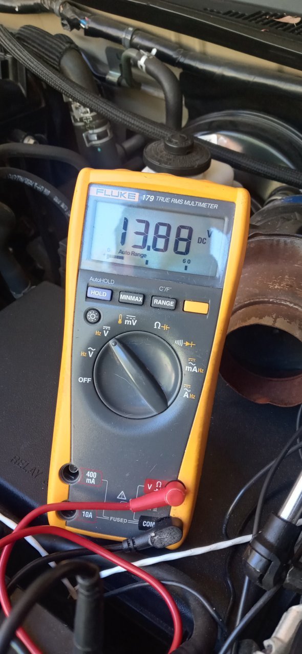

    Question.
    Im going to be replacing my battery to a AGM, will unplugging my battery erase my tune?
  11. Jun 30, 2022 at 3:47 PM
    #6131
    PapaRee
    PapaRee [OP] Pro Tuner
    Oct 31, 2015
    #168275
    3,250
    Kreg
    Prairieville, Louisiana
    2016 Black TRD Sport, Tuned, BHLM OEM LEDs
    GTS Dobinson's lift, 33"-Wildpeak Atw3-18x9 -6 Offset ,265/70/18 tires, Raceline Assault wheels, Backflip G2 bed cover, Magnaflow exhaust, Pro tail lights, Pro fog lights, Pro grille, Raptor grille lights, Predator side steps, RedLine Hood Struts, Toyota bedmat, tinted windows, Retrofitted-BHLM-Amber Halo-Amber DRL-HID headlights, LED Highbeams, LED Hood Scoop lightbar, LED hidden bumper lightbar, LED under hood light, LED Bed lights, LED license plate lights, Tacoma tailgate 3d letters, Tacoma glovebox 3D letters, removed air dam, Custom TRD Sport emblems, Pro Shift Knob with Meso ECT Stealth button, Meso LED dome and map lights, Meso V3 smoked mirror turn signals, Meso Stage 2 Tail lights, Meso Mirror Puddle lights, Meso KC-5 Brake/Cargo light, Meso center console bucket with OG lid, Tailgate PNP kit, Garage door opener button in overhead console, Meso Minimalist keyfobs, Matte black Pro hood decal, KTJO4x4 Led door handle LED lights, Pioneer 6x9 3 way front speakers, Rockford Fosgate 6.75' rear speakers, TacoTunes tweeters, AJT black vent rings, JDM Gas cap cover.
    No sir.
    And if you want to change your tune to the AGM tune (increased alternator output to 14.2-14.7v), let us know.

  14. Jun 30, 2022 at 4:30 PM
    #6134
    Jerry311SD
    Jerry311SD Well-Known Member
    Jul 20, 2016
    #192481
    1,648
    Jerry
    Ramona Ca SAN DIEGO
    2019 tacoma TRD Quicksand
    KDMaxx tune K&N drop in AFE catback Oil catch can Bill's 6112/5160 Dynomat whole inside of cab TRD skid plate
    Cool
    Cool. Thank you ill reach out to ya when. Its time to bump up the voltage im at 13.88v stock
