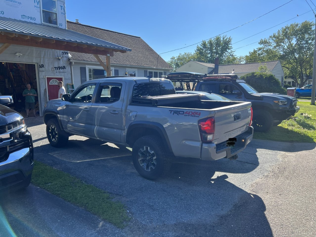

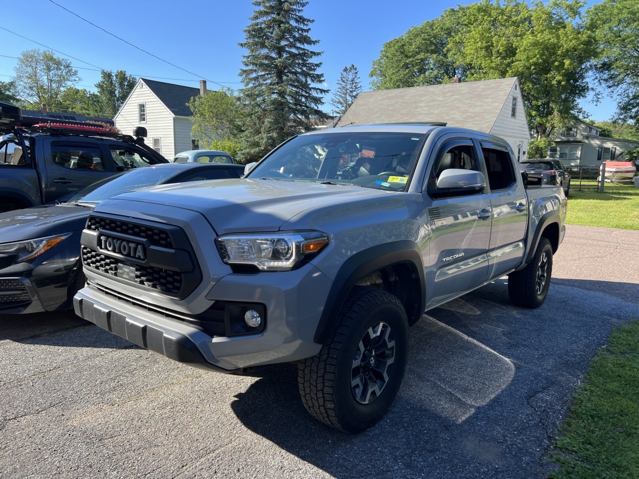

    Word of mouth from happy customers goes a long way! Pat heard nothing but good things about the tune from my neighbor so he decided to come by and make it happen on his 18 OR yesterday. We talked about throttle settings and after test driving my neighbors 22 on Sport, he decided that’s the setting for him :cool: Great meeting him and growing the local Tacoma community!
    61EBBC1A-5082-46B7-B243-8DCF96DBFC96.jpg CB18AC1A-B274-4443-BC79-0B97992A1C1E.jpg
