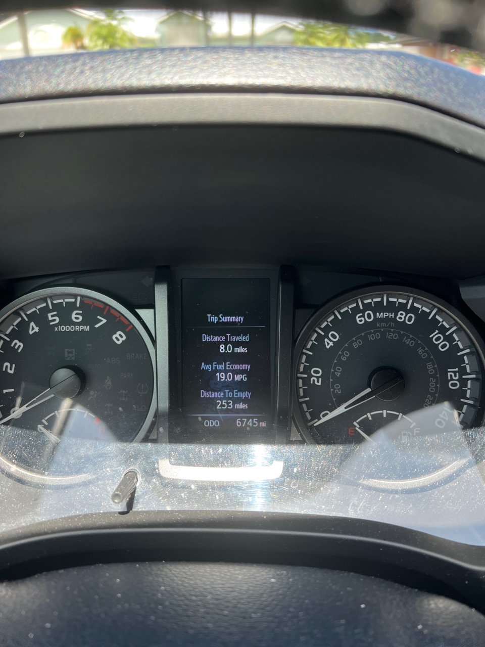

    This was my trip home from my local BJ's Wholesale last weekend. It's in-town driving but there aren't a lot of lights on this route:
