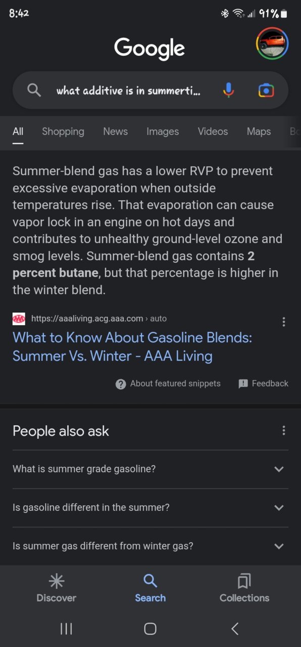

    Is there a additive we can get to for the gasoline to simulate summer fuel???

    No. Octane booster would help some but not enough to justify the additional $10/bottle/tank. I keep a bottle with me when I travel, just in case I need to fuel up at a sketchy gas pump. Winter blend fuel is like daylight saving time, here to stay til spring.

    So is it really butane that kills our mileage in the winter ???

    No, the air temperature is what causes the biggest change in mileage. colder air = denser = more power = more fuel to hit Stoic (14.7:1). Also, warming the engine up (short trips) uses alot of fuel. Also, running A/C uses 10% (or so) more fuel, which you don't typically run in winter.
