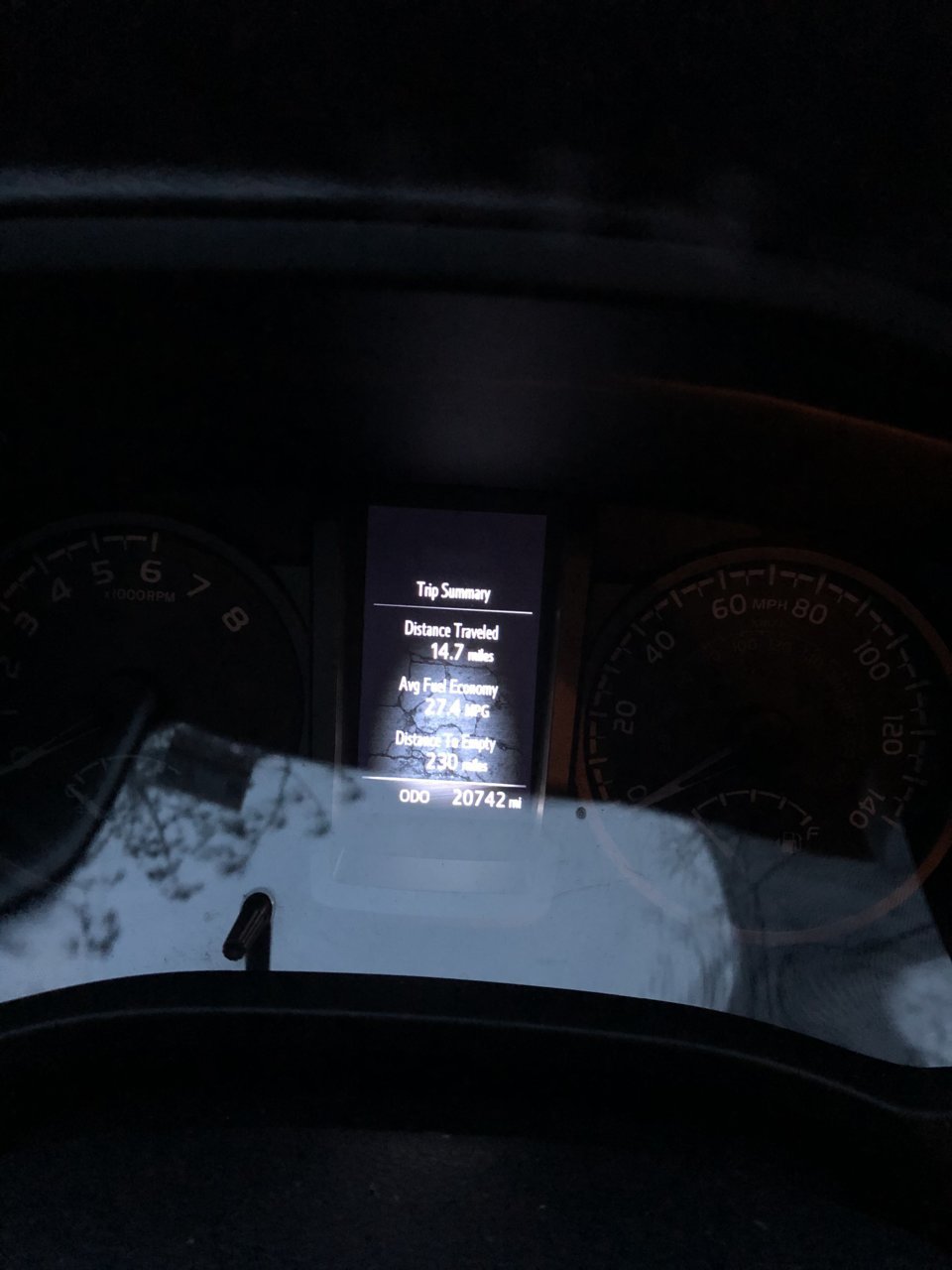

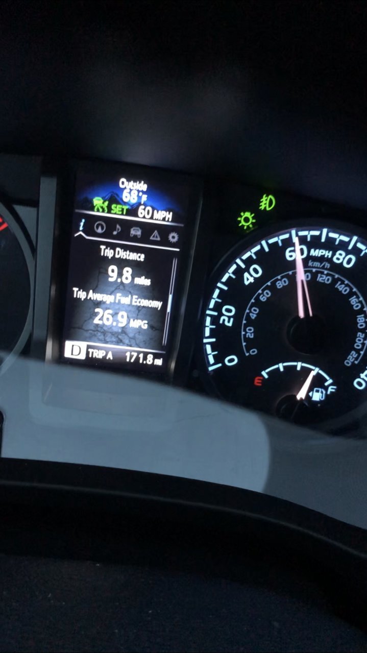

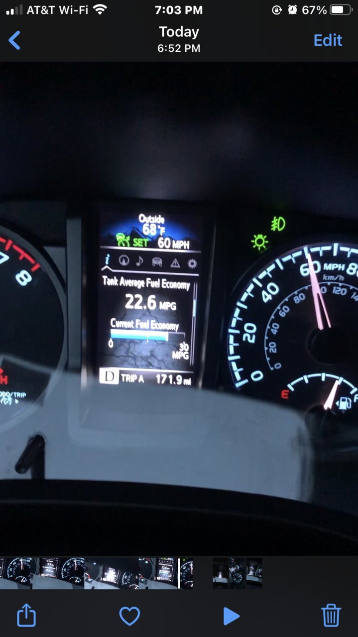

    KDMax is nice for fuel economy. Admittedly, there’s a ~3 mile-ish chunk of this mile route that’s a 45mph speed limit on the highway and another small chunk that goes down hill for probably 700-800ft or so - but still - cruise control shifting is about as pristine as I’ve experienced thus far with any tune - superior to the more tame OV2.0 dare I say. I bet I can average 24mpg on an entire tank. The 22+mpg displayed below is NOT 5.0 all 170 miles - it’s only ~20 miles KDMax. It’s a mixed bag of various tunes at the moment ranging from stock up to KDMax. I have been doing mpg testing.
    To put this route in perspective, the best I usually get when trying to is ~24-25mpg after nearly 15 miles. This time I averaged 27.4. KDMax is about a 10% improvement on fuel economy for me.
    It's worth noting that you won't get this being heavy on the pedal. I was trying to drive conservatively (with a performance tune lol). I didn't baby it per se to see if I could get over the moon or anything (I promise I can peg 30mpg if I tried but it would just be a meme, not realistic). I stayed 60mph for about half of the 15 mile route with a mix of mostly cruise control and some manual pedal work - which is to say I drove it like I've trained myself to drive under regular driving conditions. My truck is stock minus my aftermarket cat-back and I was on the regular octane version of KDMax.
    KDMax is super smooth. The auto shifting is very nice. Obviously, you can squeeze phenomenal fuel economy out of it while also having all of that extra throttle and power at the ready from KDMax for quick acceleration if you need it. For our Tacoma's that are so under tuned from the car lot - this is exactly what our trucks need. You can get power and you can get fuel economy. What more do we need from our Tacoma's?
