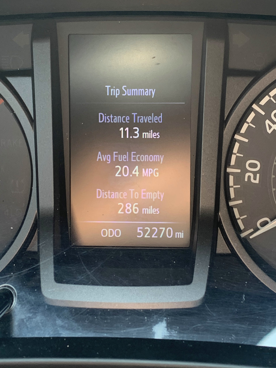

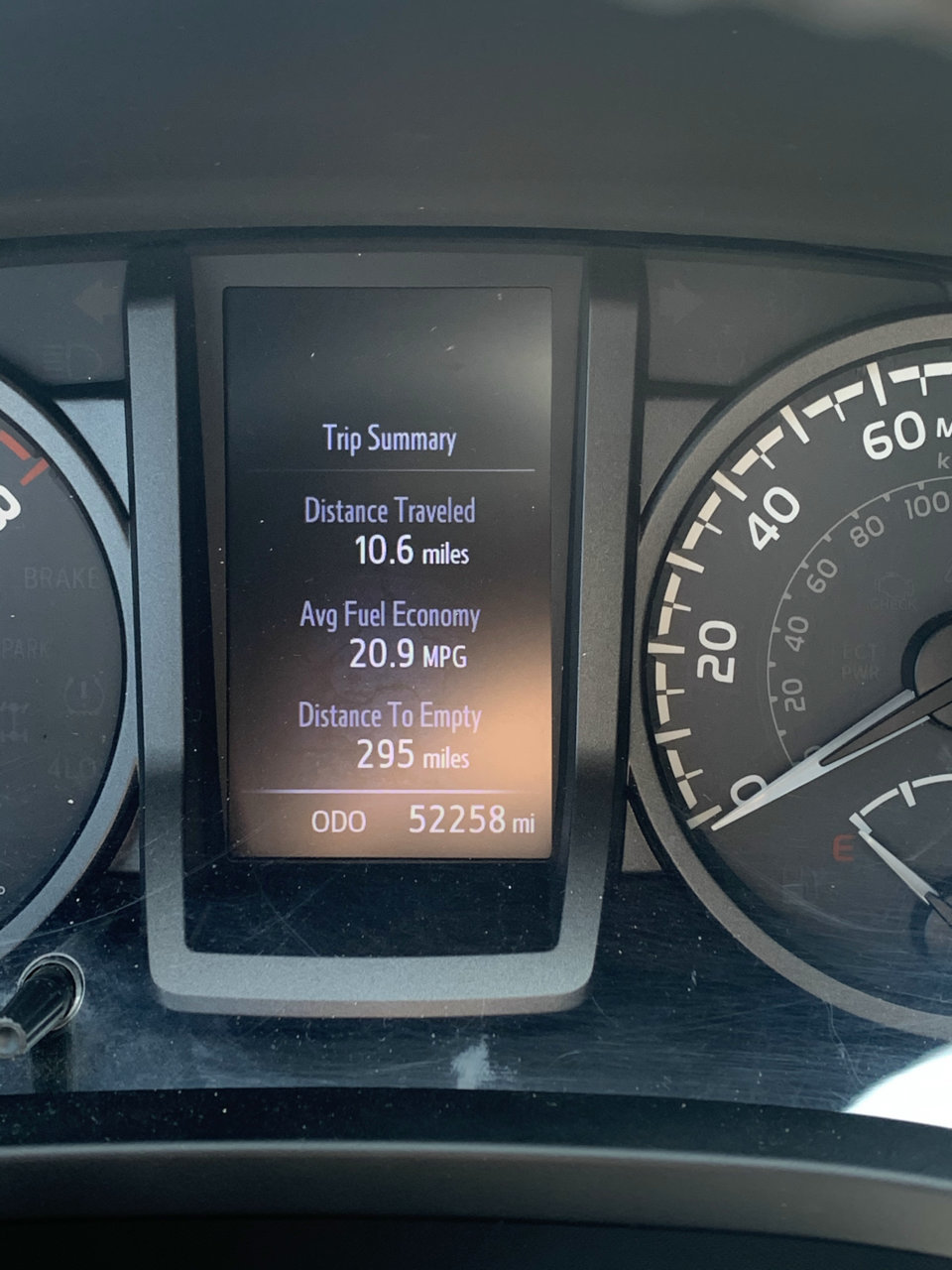

    Just a little KDMax 6.0 mpg report.
    4.88, 265's, LT throttle, truck is slightly heavier than stock, 3ish" lift
    Drove to Red McCombs Toyota to pick up some manifold gaskets. I have made the drive to and from that dealership quite a few times.
    I was on OVTune 2.0 (19800) for a long time. My best mpg on that drive on OVTune was around 18ish on a good day.
    On the way to the dealership I drove normally, simply kept up with the flow of traffic, mainly 60-70mph most of the trip 40-50mph for the rest.
    On the way home I got on it a few times then got stuck in a little stop n go traffic for about a mile.
    *0.7 miles trip difference is because you have to go all the way down the access road and take the turnaround to head back.
    Just highlighting another real-world benefit of the best tune out there :cool:

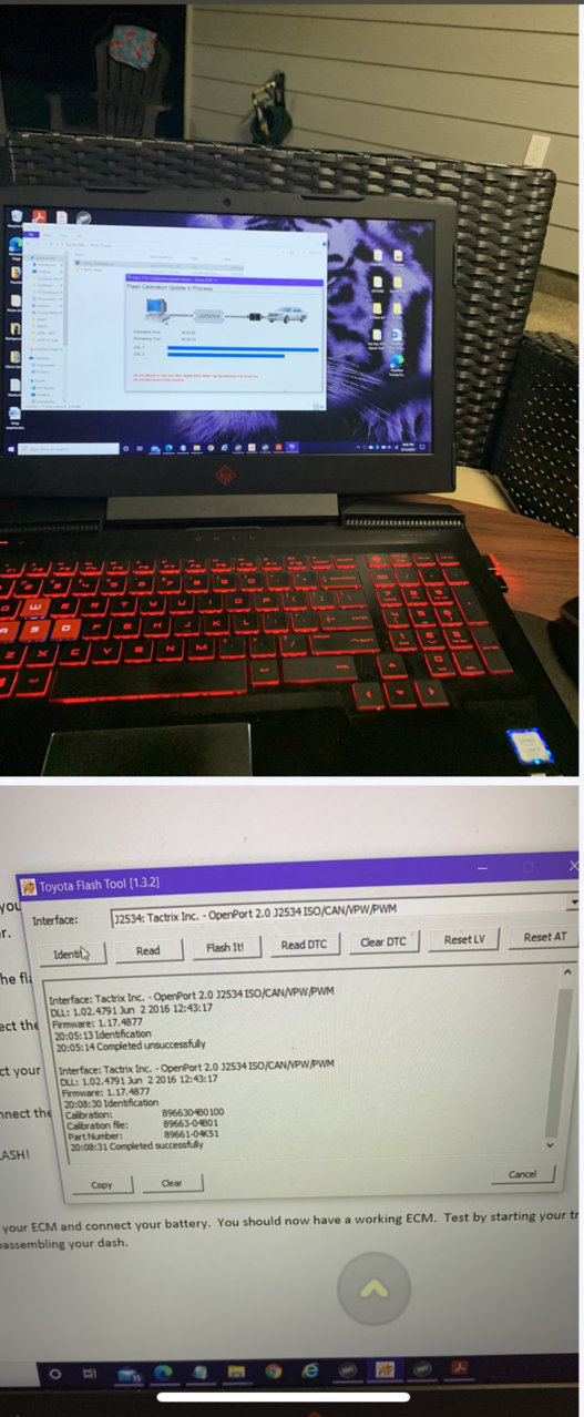

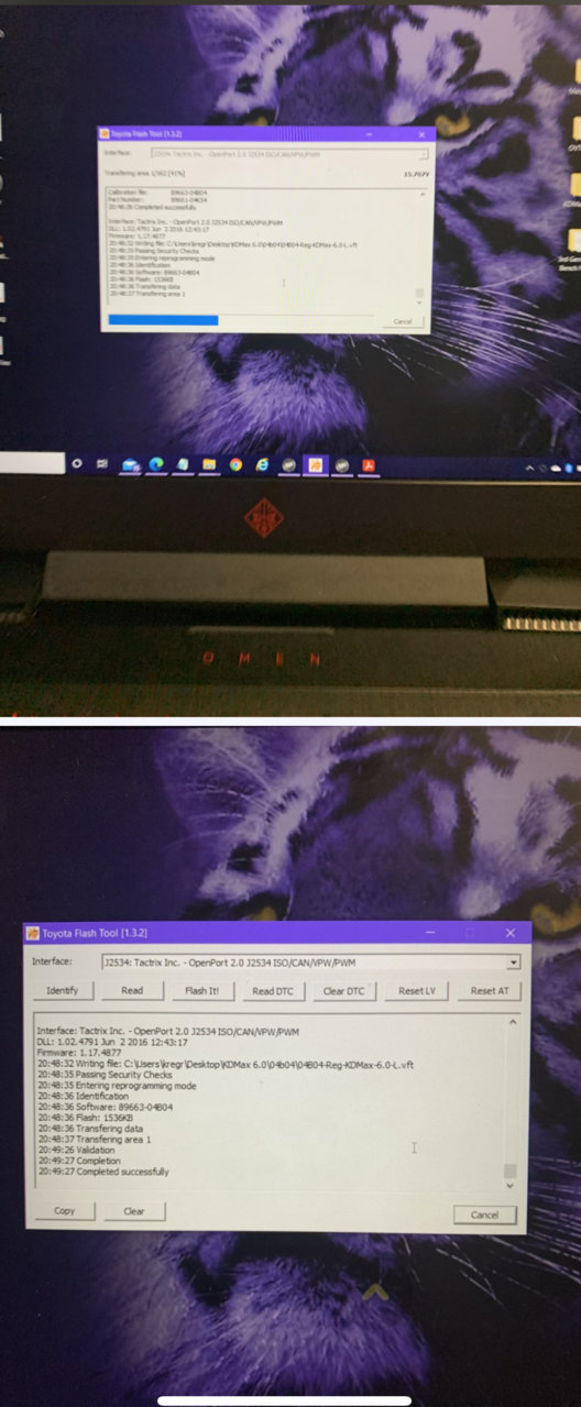

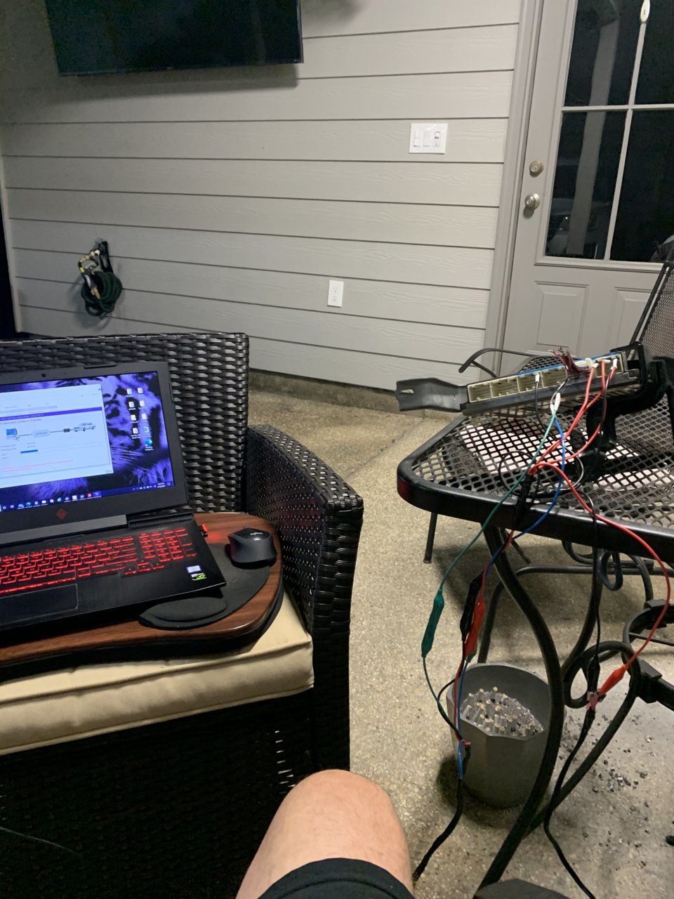

    I bought a used ECM off of eBay and bench flashed it with KDMax tonight.
    It was 04b01 (Old software), so I identified it, then updated it with techstream to 04b04, then flashed KDMax 6.0 on it.
    Finally, I wrote my VIN to this ECM to have it as a spare.
