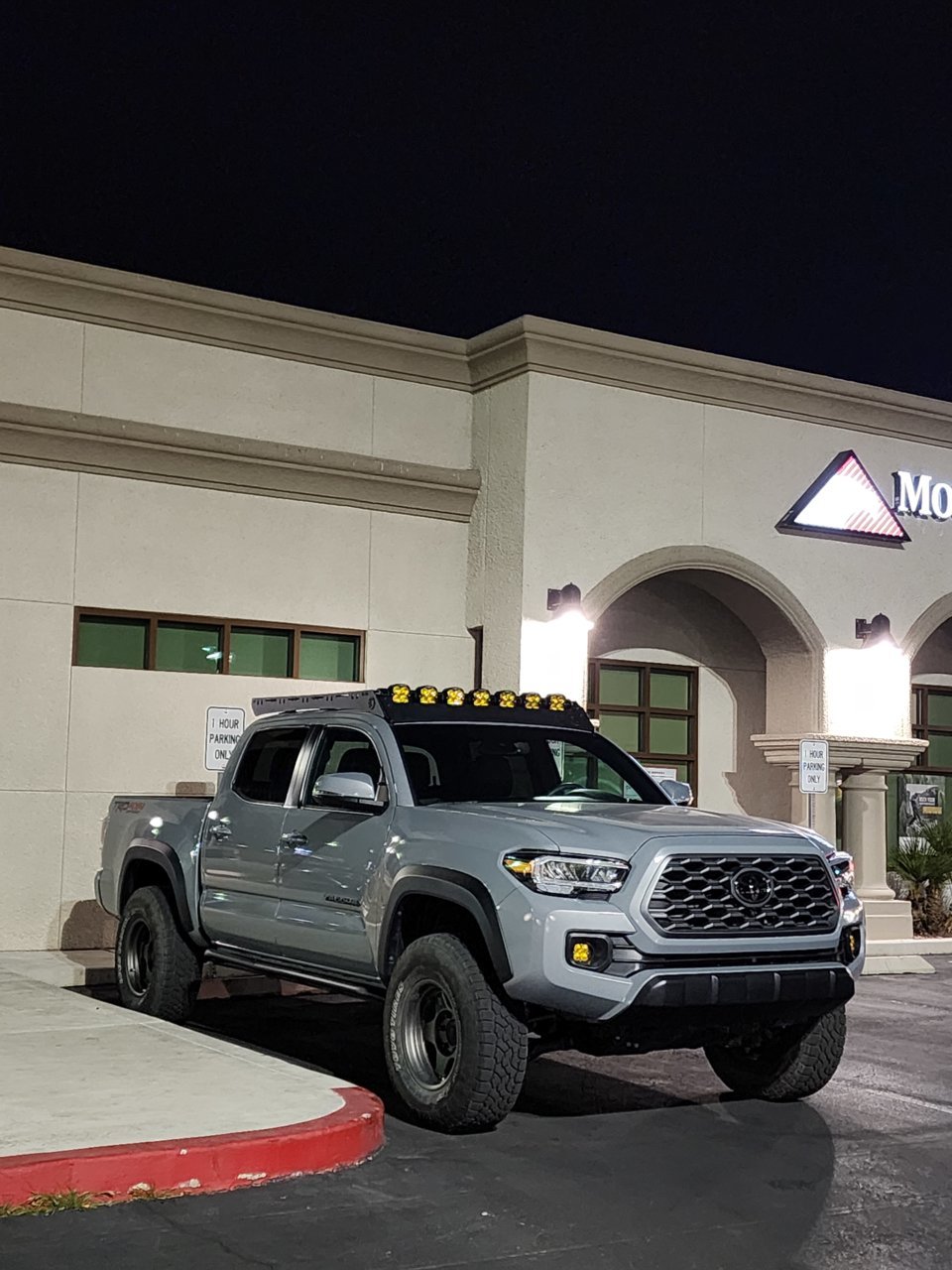

    Just completed a 500+ mile round trip from Vegas to SoCal to pick up some parts for my car and kept track of the mileage and fuel consumption. Total mileage according to the trip computer was 526.4 miles and both fill ups totaled 23.993 gallons which equates out to be 21.94MPG. Pretty solid in my book . I've been on the KD Max train since v6/v7 and it has improved with each iteration. Much appreciated guys!

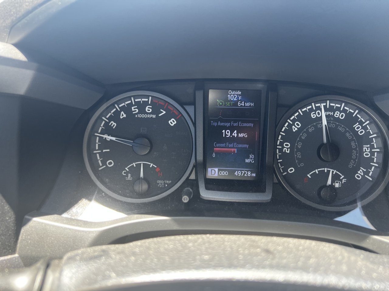

    #94017
    1,397
    Automatic, 5.29’s, 35” Tires, Speedometer Corrected, V10 on 91.
    Tacolife5, PapaRee[OP] and TWTaco like this.
  11. Jul 1, 2023 at 5:57 PM
    #8451
    TWTaco
    TWTaco Well-Known Member
    Dec 19, 2015
    #172601
    5,975
    Dave
    :D Damn that looks like some good MPG's on 35's and 5.29's thanks for sharing!!
