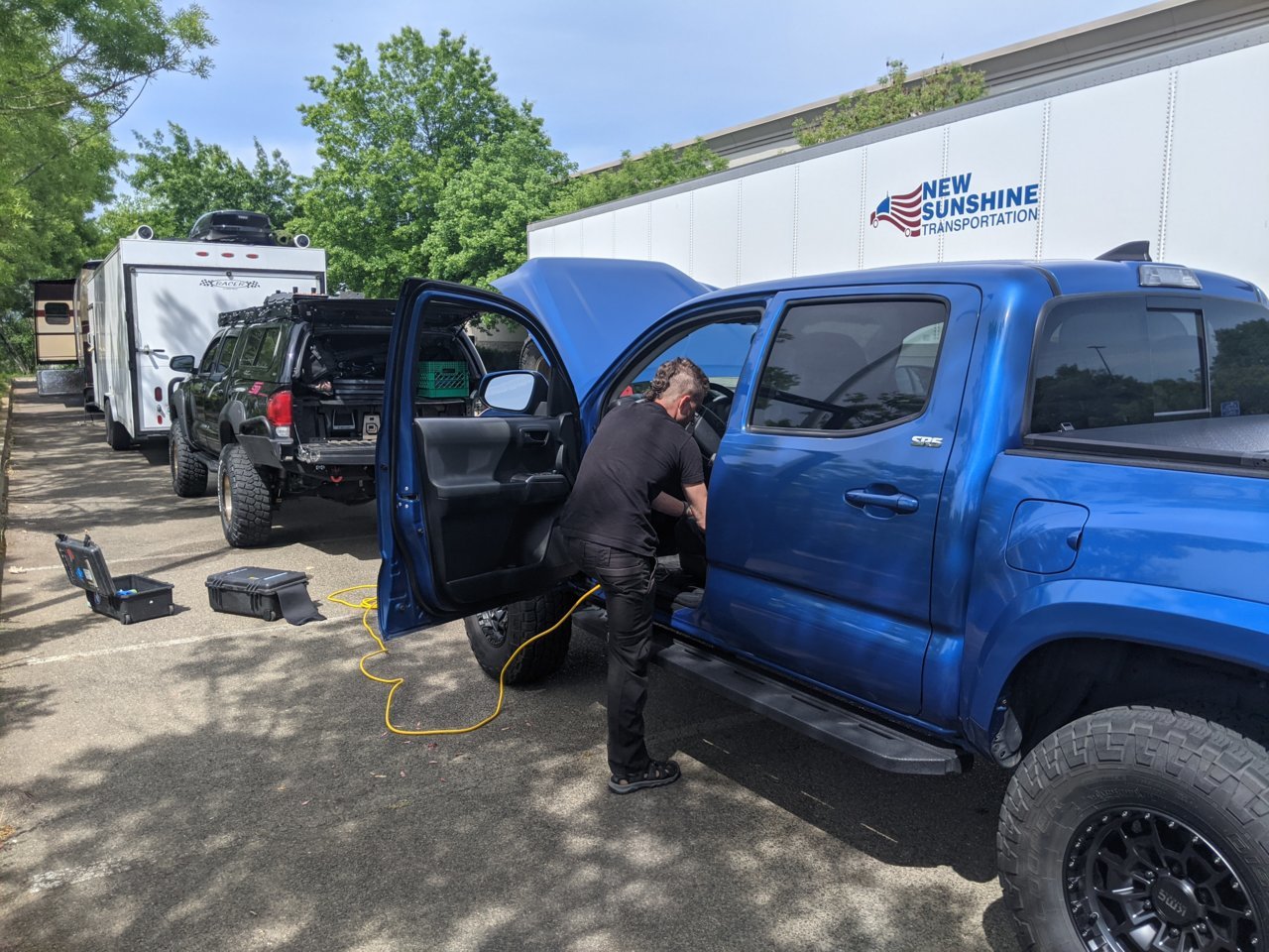

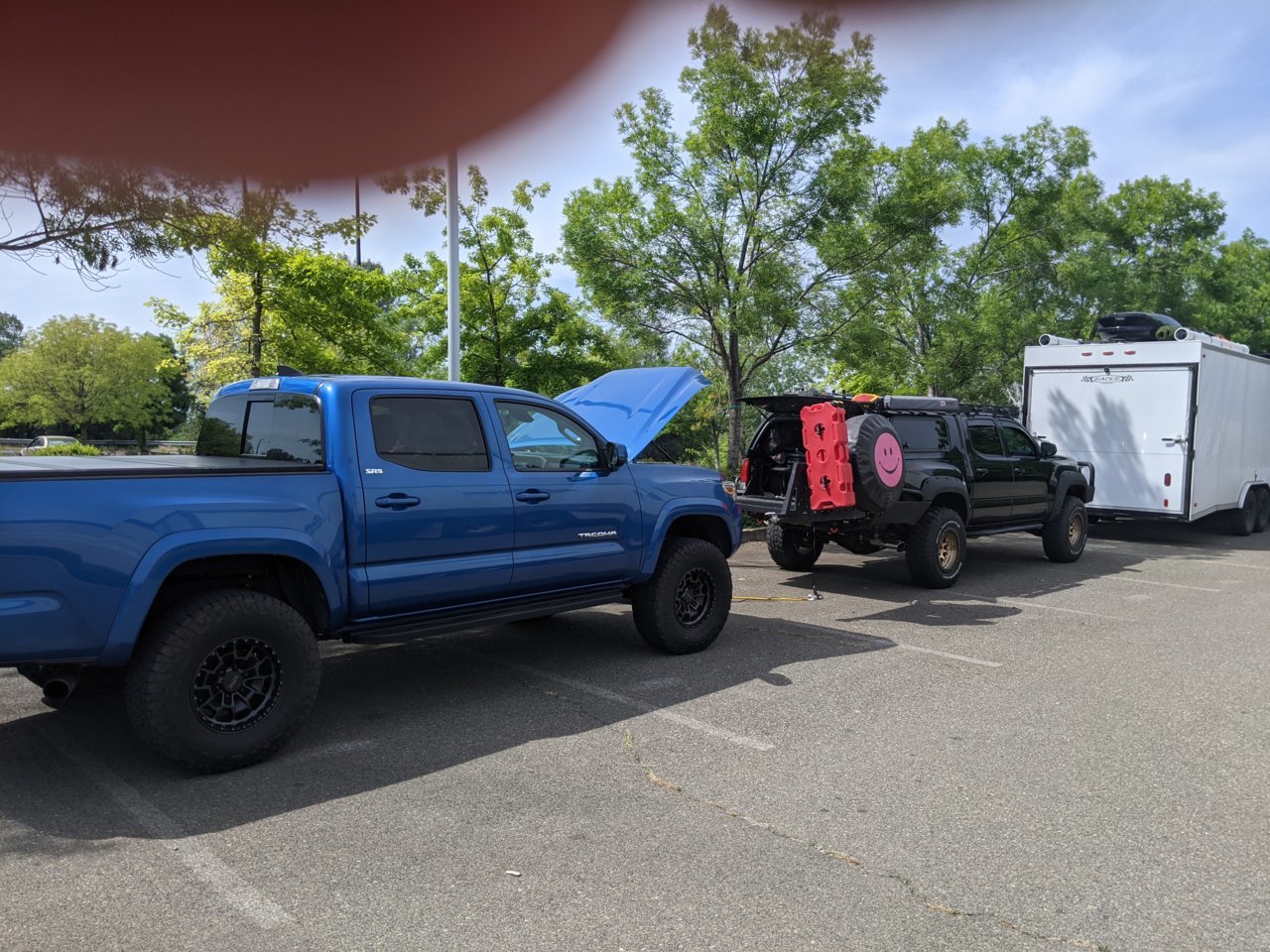

    Just had the KDMAX 6.0 done by @SubaruTheTacoma . Reg. Fuel. SLT. It's fantastic. Shifts better than my Shift Sense. And it rips. Thanks Rhys. PXL_20210423_182611771.MP.jpg PXL_20210423_182630505.MP.jpg
