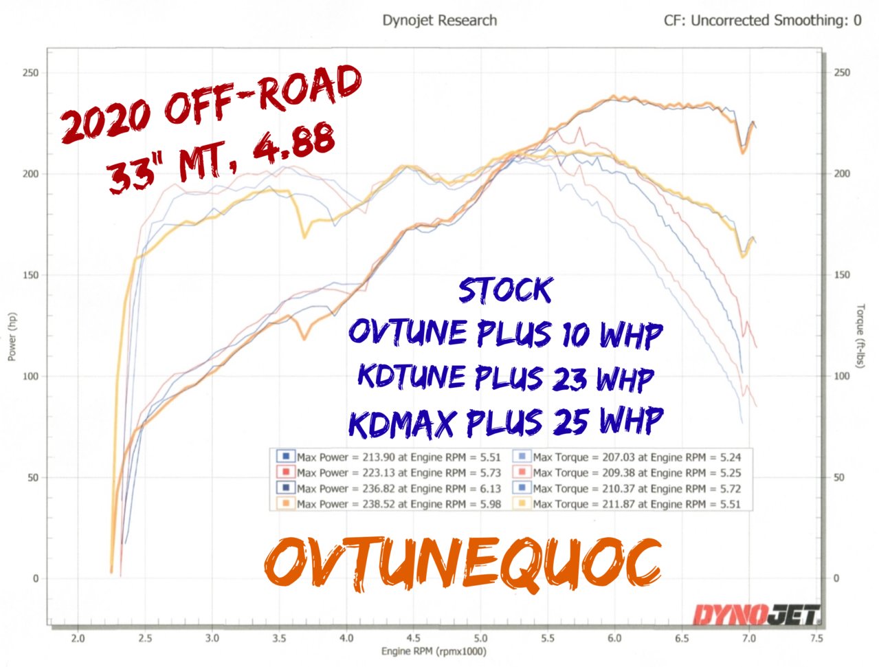

    I saw the graph on page 61, but are there dyno numbers that show normal driving rpms? It looks like the dyno posted shows rpms at 4000 and up.

    Like this?

    Cool, thanks. Didn’t want to sort through 60 pages if it was quickly available.
