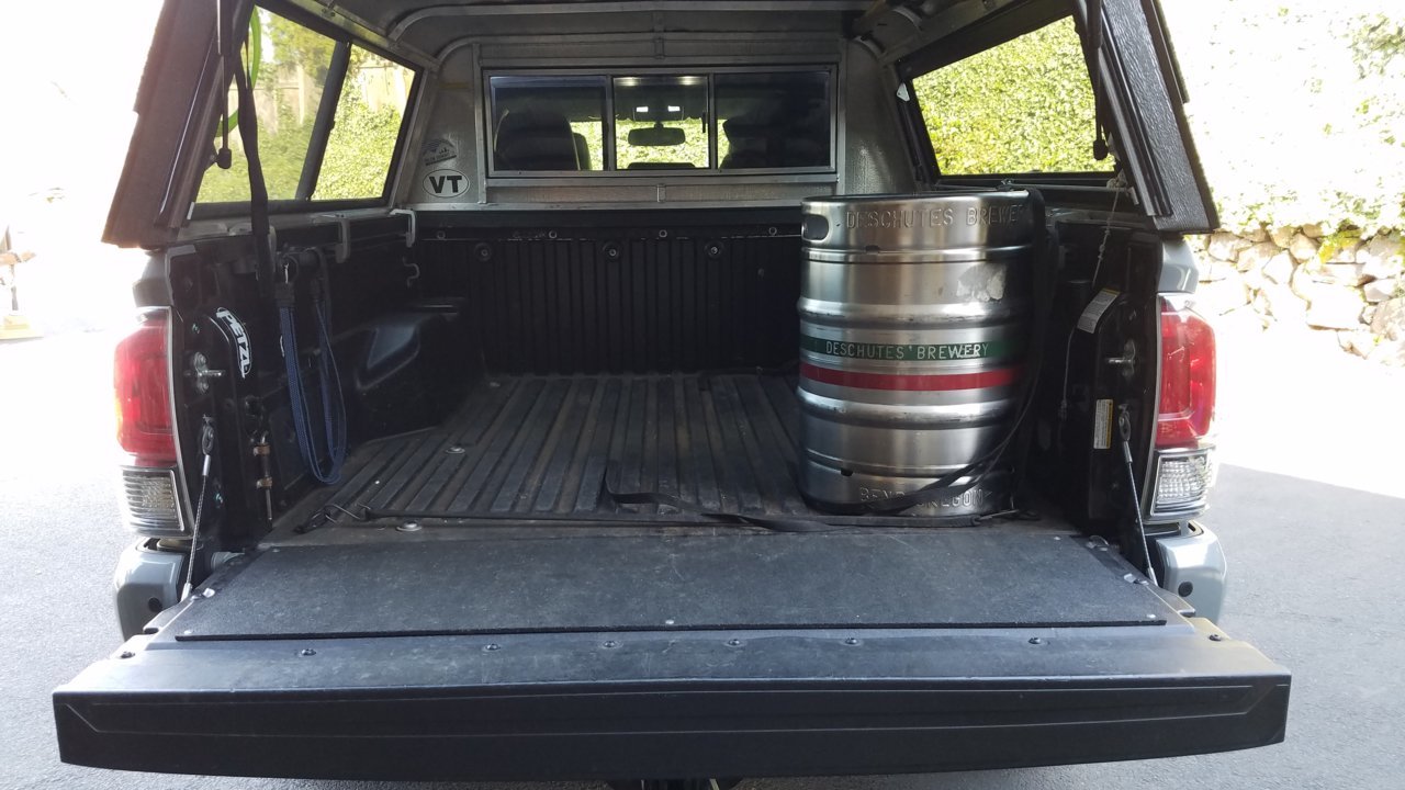

    20210326_165758.jpg Works so great I forgot to add an image. (Yes, it's tapped and that's why I forgot an image) Nice work Pappa. Beers on me when you make it to Oregon!

    Deschutes Brewery NICE! Went there for the first time in 1996. WAAAAAY back.
