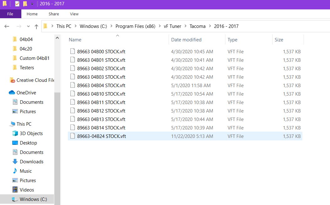

    The stock tunes come with vftuner in the program files.
    Also, you can Read your ECU before you tune it and save a copy.
    And yes, you can put it back to stock at any time.

    Perfect! Yea I’d be in if I can save the original file.
    stock tunes comes with vftuner?
    can you elaborate a bit, unfamiliar with Toyota ecu

    In the VFTuner folder in Program files, there are stock tune files for your truck. You can use them at any time to flash your truck back to stock.
