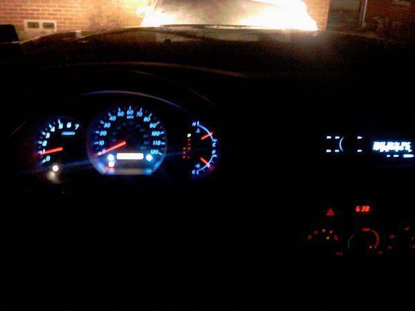

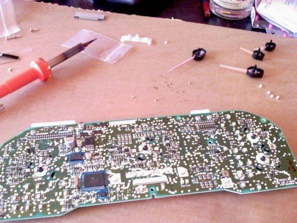

    I decided to tackle the gauge mod this sunday. It was a PITA! but well worth it.
    I soldered the leds in backwards at first..not paying attention...so after trial and error I figured out my mistake. then I got two of the bulbs too hot and had to reuse the green blinkers on the right hand side. I will be redoing those after I get some more in.
    im going to do the needles in white and the odo too.

    alright I finished my gauge mod this weekend.

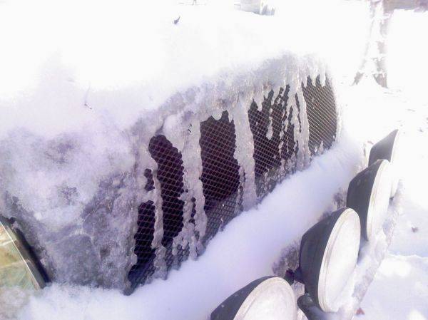

    ^ once its gets below freezing stand outside with a water hose and just spray where you want. You could even get the all new IHLM (Ice headlight mod) or the ITLM...haha

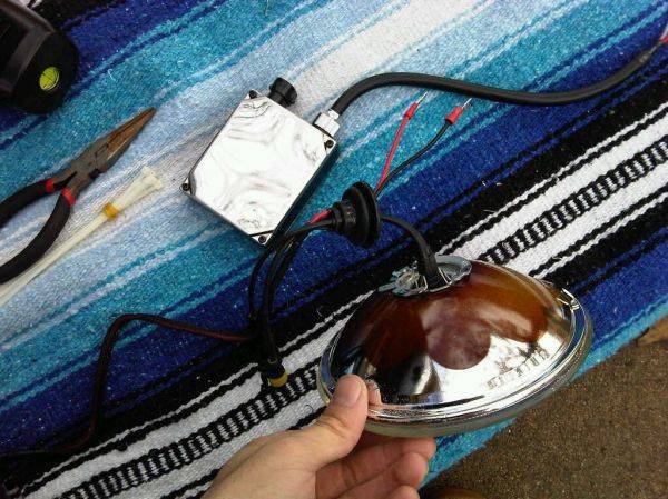

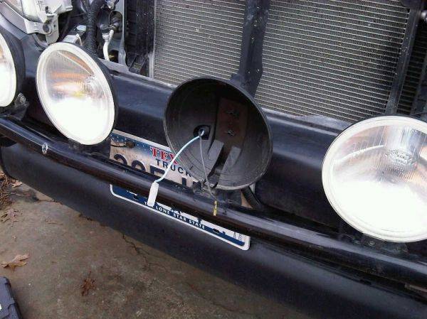

    Last weekend I converted my Hella 500's to HID's and OMG they are pretty much Anti-Aircraft face melting lights!:cool:
    I used the 55W 5000k kit from DDM tuning.
    The wiring harness that came with them are too short to reach from the lights to the ballasts to I had to add in longer pieces of wire. I went ahead and soldered them so they wont come apart.
    the power wires no longer come out of that small hole on the side, I drilled a 1" hole right in the middle for the new wires to come out of. (not pictured)
    [​IMG]:cool:
    It took about 3 hours, only b/c I had to figure out how I wanted to extend the wires and where to mount the ballasts.
