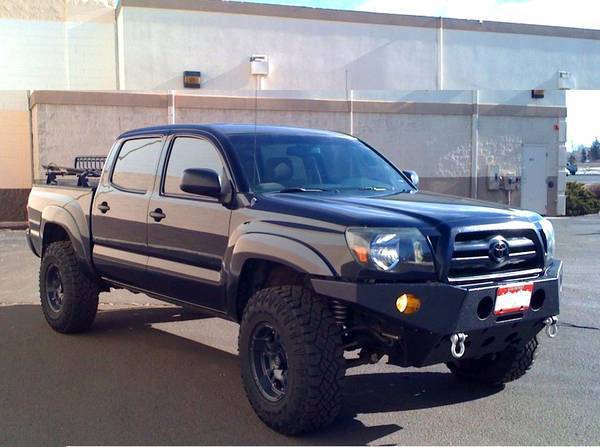

    So, I'm trying to decide whether or not to upgrade my suspension or leave it the way it is. I have 5100's @ .85/ eibachs. In theory I should have 2.45" but with the bumper I feel like I have much less. The rear only has the tsb. The truck sits pretty much exactly level but I had some rubbing with the new 285's. I already cut the cab mounts and it hasn't rubbed on the road but I am worried about on the trails. My thoughts on an upgrade would be 1.5 AAL and toytech adjustable coil overs with uniball UCA's. Thoughts?
    My goal is to get a smoother ride on and off road and not produce any new problems. Thanks!

    Eibach coils. 5100's all around. AAL. WickedFlow
    What bumper is that you have?
    I've got your same set up, up front. With a 2 inch AAL. I've been looking to get a full 3 inches out of the front. And add a plate bumper. An option you can do is get small spacers from toytec to achieve a full 3 inches up front. Obviously new UCAs are a very good idea at that point, as u mentioned.
    It would be a cheaper way to go initally, and see if you like it.

    It's the old All Pro sprayed with line-x. I thought about that route, but I am worried about making the ride really rough by preloading even more. Anyway, thanks for the input. I have some time to decide.

    Sell me your bumper and that'll help with te sagging a little bit.

    That thing is gorgeous as is, wish my BSP looked like that!!!

    ha. I had it for sale on here before the LineX. Looked pretty crappy with the factory "powder coat" The guys did a great job making it look like new. But, it's staying on the truck now! sorry
