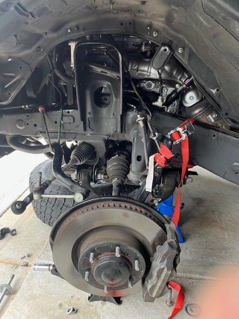

    I'll do it myself. I'll disconnect the two lower control arm bolts, then the shock bolt , sway bar bolts and loosen cam bolts - that's the route I'll go since I'm not replacing UC's on this rig.

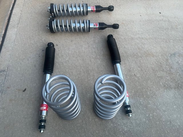

    Here's the Eibach lift I ended doing in my garage - If this isn't what I think it'll be, hoping to get what I lost back after installing the bumper and winch and then an additional 1.5. Not sure what I'm hoping for in the rear - I ordered both sets of springs from Alldogs - I'll go back this same Eibach kit. I honestly like the color matching of the Eibach kit against the Celestial Silver body vs the Red TRD shocks.

    I’ve taken the coilover out both ways. Dropping the LCA is easier but torquing everything sucks since 4 bolts are over 200 lb/ft. Taking it out by disconnecting the UCA, you have to fight the axle to keep it in the joints. It’s not super difficult, but can be annoying getting it to set back in the joint.

    I've also done a few of these going the LCA route and it's been VERY easy, when I installed my Alldogs springs the shock reservoir got in the way doing it that way. Just an FYI but I had to remove the LCA bolts to install which made it a pain to do.

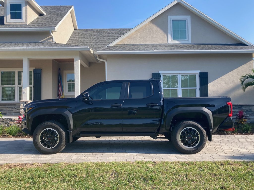

    I installed the AllDogs front springs on my 2024 OR. They are the same length as the stock springs while removed from the vehicle.
    They provide a little shy of 2" of lift, and *almost* level the truck completely, leaving just a tiny bit of rake. (perfect, imo)
    I've offroaded twice since installing and had no issues. The on-pavement ride feels identical to stock, to me.

    I've had spacer lifts before, and know what you mean by a stiffer ride to gain height. I didn't want to to that to this truck, and went the route of swapping out springs. It may very well ride stiffer than stock, but it's not "stiff" by any means.
    Maybe it feels "stock" to me because I was so keen on avoiding the stiff spacer feel, and this definitely accomplished that. Most of the offroading here in FL consists of sandy fire trails, with lots of bouncing, but no hard jarring (no rocks or large roots down here). That could also be contributing to my impression of performance.

    I have a Hybrid too and only got 1.4 of lift on the front, had to add a 1/4 in spacer to get a little more. Looks good!

    I like that look of your Tacoma. My issue is that I added a 90 lb front bumper and a 65 lb winch and therefore got a little sag in the front. I'm hoping to get rid of the sag and gain an inch or so by adding the ADO springs. I ordered the ADO rear springs when I ordered the fronts - all arrived yesterday - I may end up posting them on here if it may make my Taco look really weird after install on rear. Sidenote: I just put in a set of Lasfit all weather mats and I'm super impressed with the overall coverage vs the Toyota version of All weather mats.
