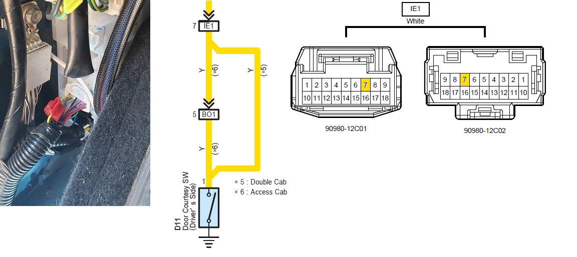

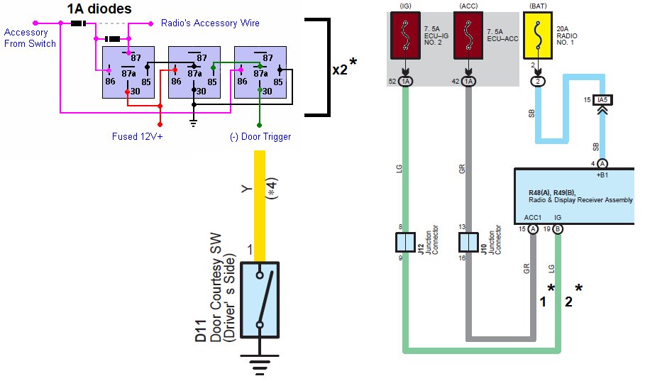

    Just thinking how this could work. Seems like you would need a time delay relay to the radio and connect it to the door switch circuit. This would allow the radio to be on for a short amount of time after you turn off the engine. Radio would stay on until the door is open or times out so it doesn't kill the battery. :confused:
