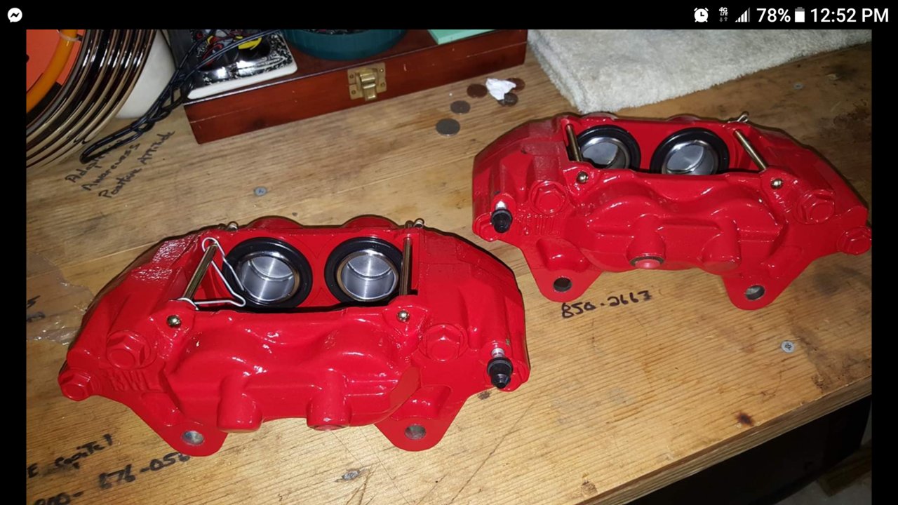

    I've got a nice new, red set of 13wl's sitting in the garage for you.
