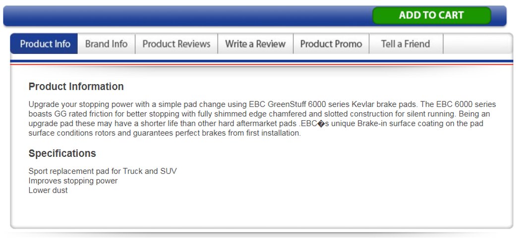

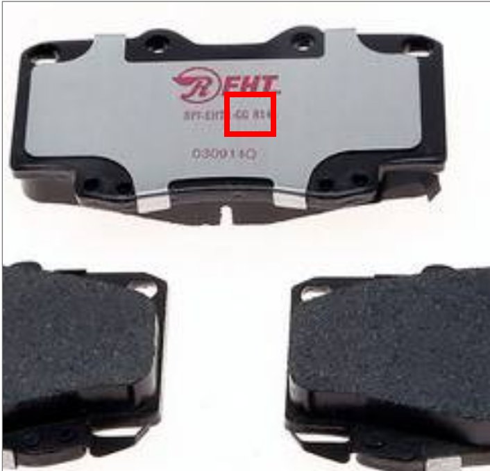

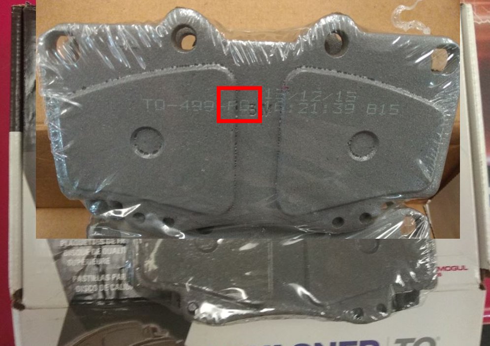

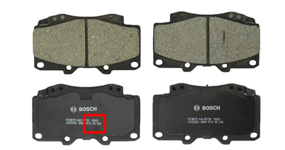

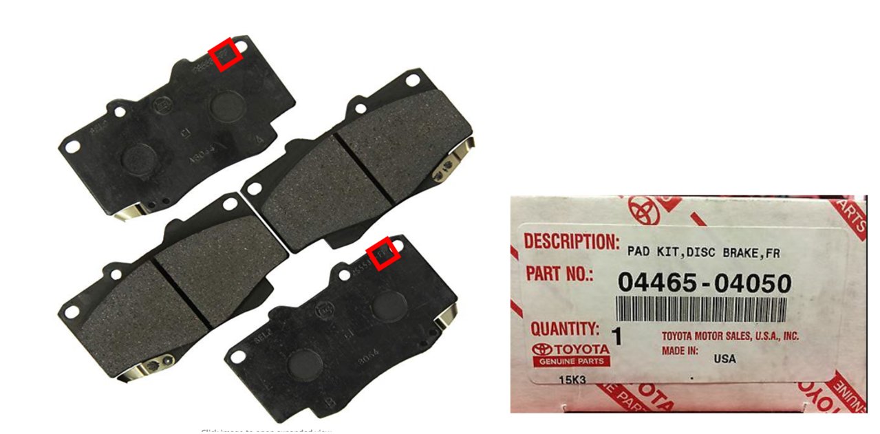

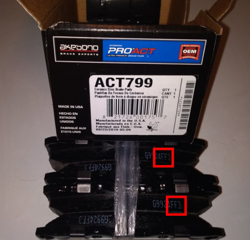

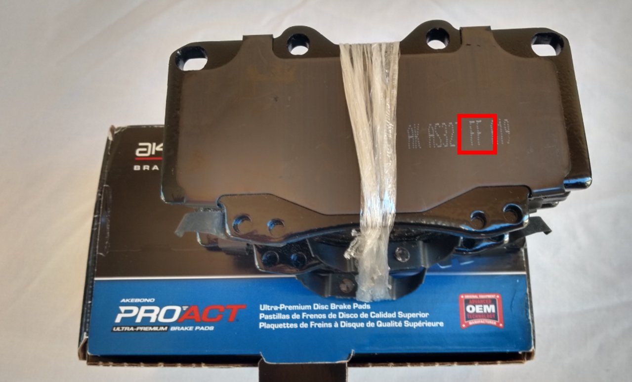

    :thumbsup: During the holidays I bought and returned an assortment brake pads to photograph edge codes for a write up about how front pad performance and how to spot different grades.
    More to come about material types and brands in a thread about brake pads. There a lot of good brake pads out there. Just some early observations from popular pads that I have been collecting.
    I consider OEM as the "baseline performance" mark with a DOT friction rating at FF.
    Just a quick note about ratings, GG rated pads were introduced by the Europeans for cars that drive at Autobahn speeds and for severe duty applications like law enforcement vehicles. FF is the gold standard for OEM performance in the U.S.
    Of course, they all have their "secret sauce" that makes their pad better than all other brands. Sometimes I think it gets down to deciding on a particular hairstyle over a quantifiable difference between products with similar performance ratings.
    This post is about how to identify edge code ratings and doing your own research over starting an argument about "this pad feels better" than brand X pads.
    Toyota 04465-040505 at FF
    Akebono ProAct 436 at FF
    Akebono ProAct 799 at FF
    Wagner Thermoquiets at FG
    Bosch BC799 at GG.
    Raybestos EHT799H at GG
    EBC GreenStuff 6000 Kevlar at GG.
    tsb and cruiserguy[QUOTED] like this.

    I had never noticed a GG rated pad from Raybestos or Bosch before
    But I did save that little chart with the brake grades but then it's easy to just remember, minimum of FF and can go a letter up in each digit as the pad improves lol easy peasy :D
    CS_AR[QUOTED] likes this.
