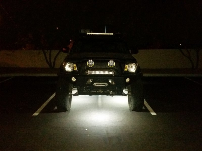

    Here is a couple pics of the rock light kit installed by @JeepAndrew. Awesome!!!!!

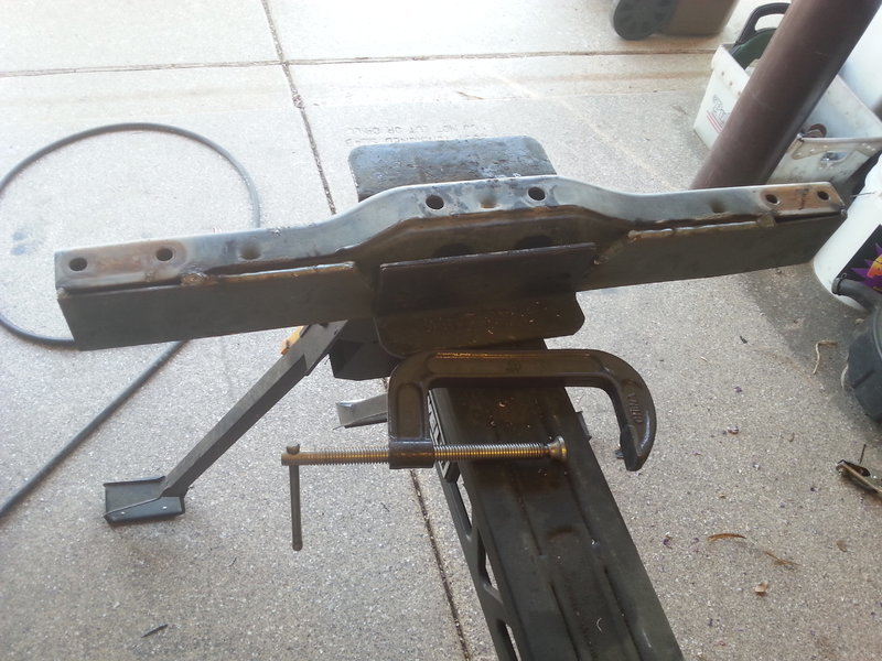

    Somebody was over here today *cough @05tacomabro cough* for a little custom job...

    My week ass transmission cross-member got the royal @JeepAndrew treatment today. Beefcaked the shit out of it! Only got one picture after the first plate went on but ill add more tomorrow when there's light. He covered the whole bottom with one solid piece of 3/16 and then two more 5" plates on the ends where the factory welds stop on the pre '09 cross members and are prone to cracking. I feel like I could lay the whole truck down on big rock, right on the cross member and never worry about it. We now have plans to plate the cross-member braces on the frame as now that is the new week point with all that beefiness that it has to support!20160515_144026.jpg
