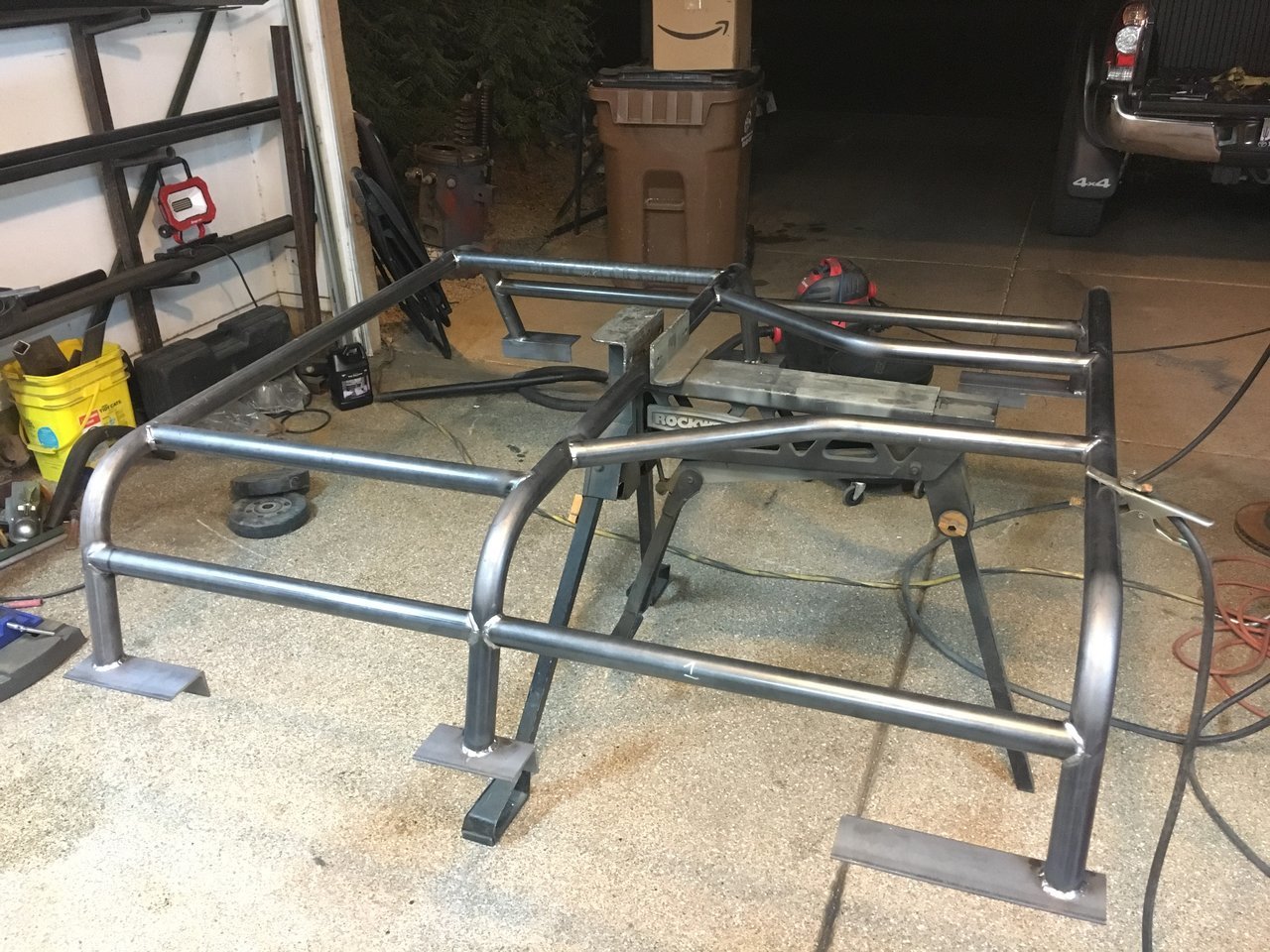

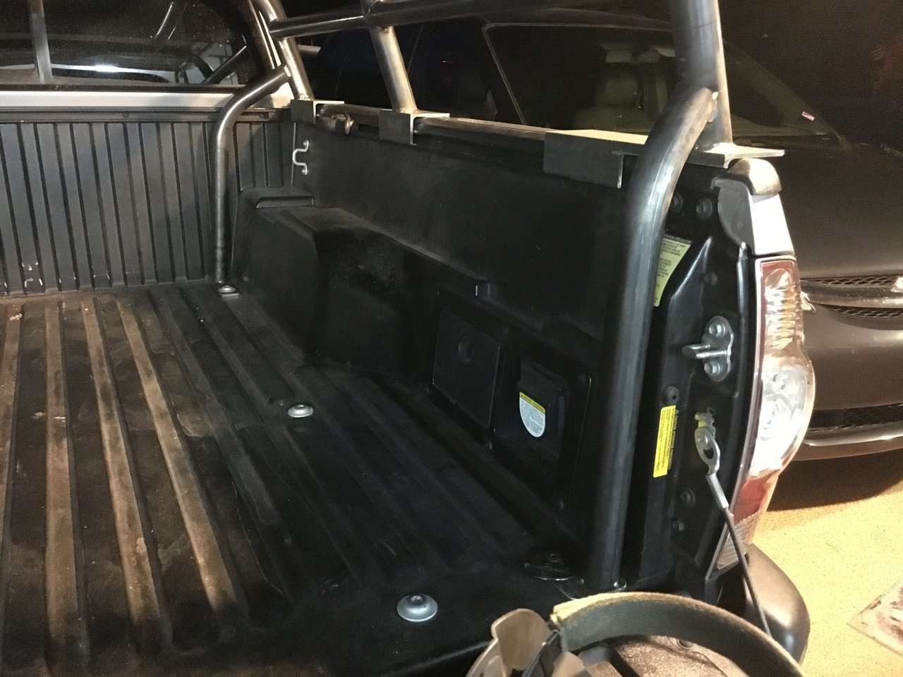

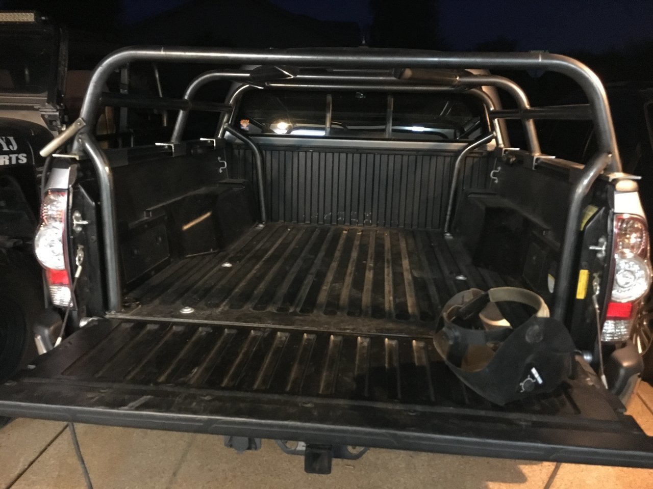

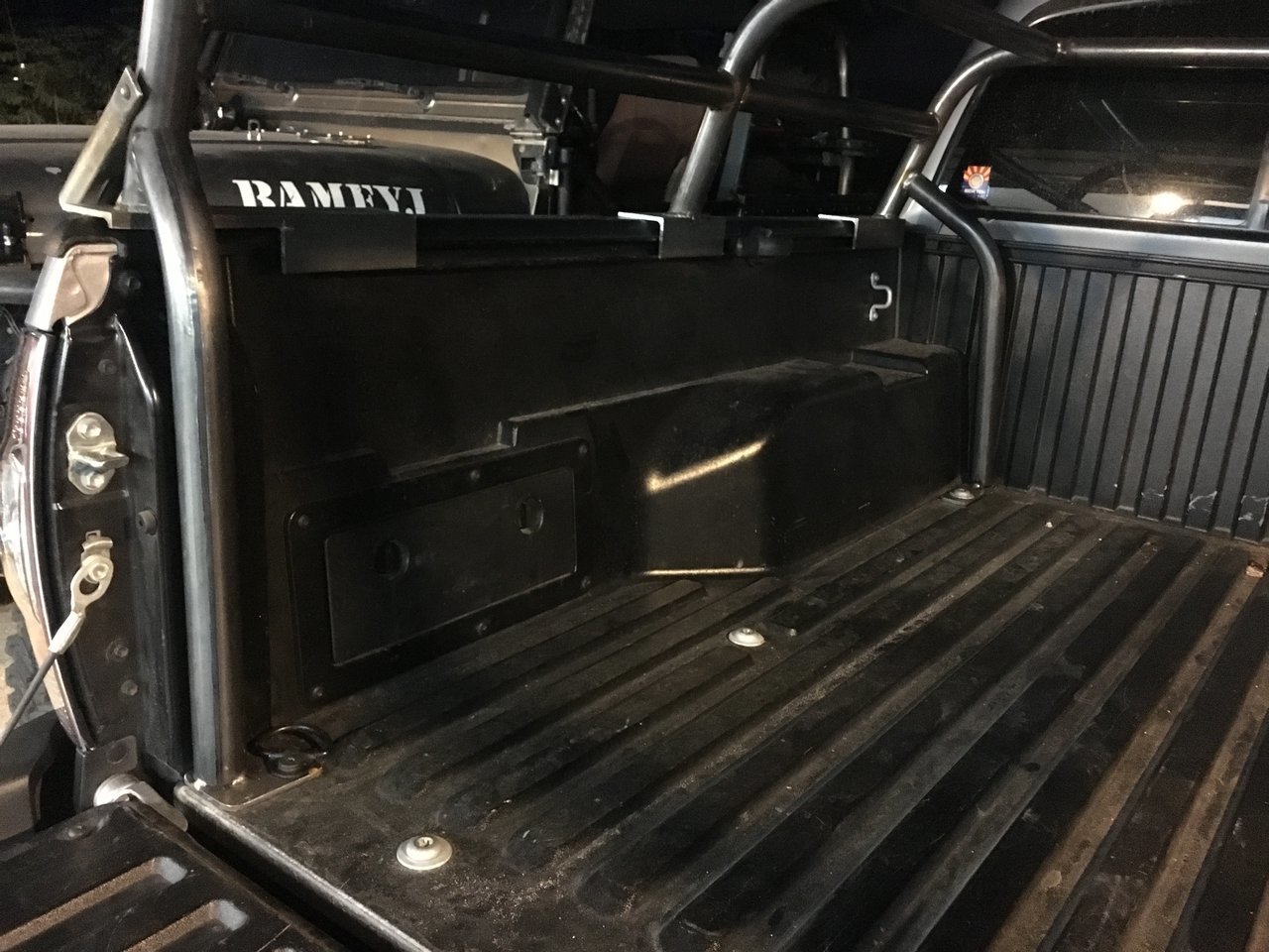

    Alright so here it is, the first ever KMF bed-bolt-tied 3 hoop full SB length RTT rack!
    I gotta say, it’s great having a 2nd gen on-site at all times, makes prototyping much easier!53F6E82F-23AE-41A2-BE80-7B56048D1CC2.jpg92D6F0DB-45E3-4FC3-A287-C1E1D1DF49F1.jpg4C62B3F4-0DD9-4C04-8E39-D8A30E6A0B47.jpg
    I’ll post some final pics after finish welds, cleanup and paint are done.

    That is sexy!

    Love how you did the upper cross bars! That will be nice for loading the bed from the sides

    Thanks man. Might become standard issue for the future!

    My only suggestion would be to run the rear post bottom plates over to the actual bed bolts with a gusset rather than just to the d rings. That would give you a full four points tied to the frame rather than just two. Mine is tied into the rear bed bolts and I really think it helps, however, it's still not tied to the front two which I may be hitting you up to change. I actually have some other thoughts too that could make this rack a really big hit for people still wanting to run a shell or soft topper. Either way, beautiful work as always brotha!

    I’ll definitely do that in the future. Plenty of meat where the tie down point is but I get what you mean! And sounds good man!

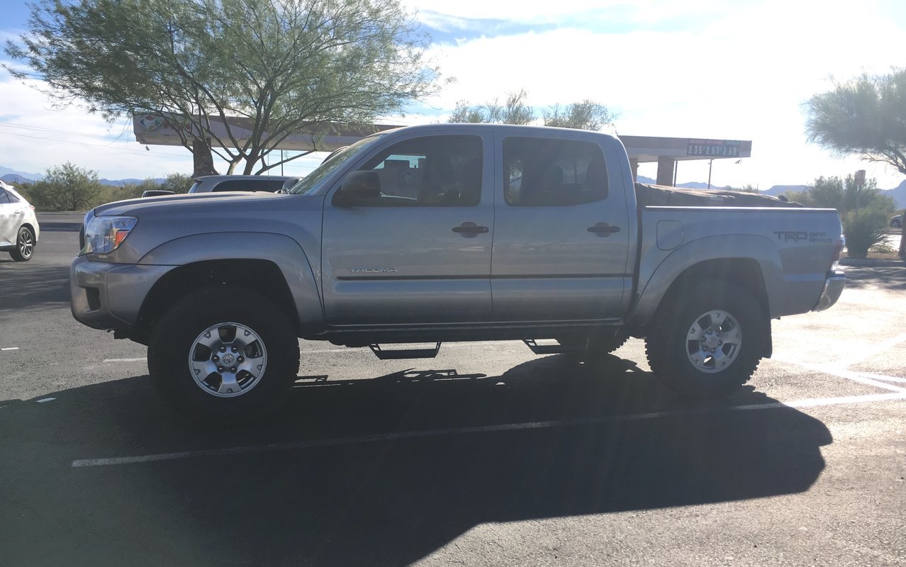

    KMF Frankensprings handling 600lbs of cargo; camping gear, large ice chest, 20 gallons of water, and firewood.
