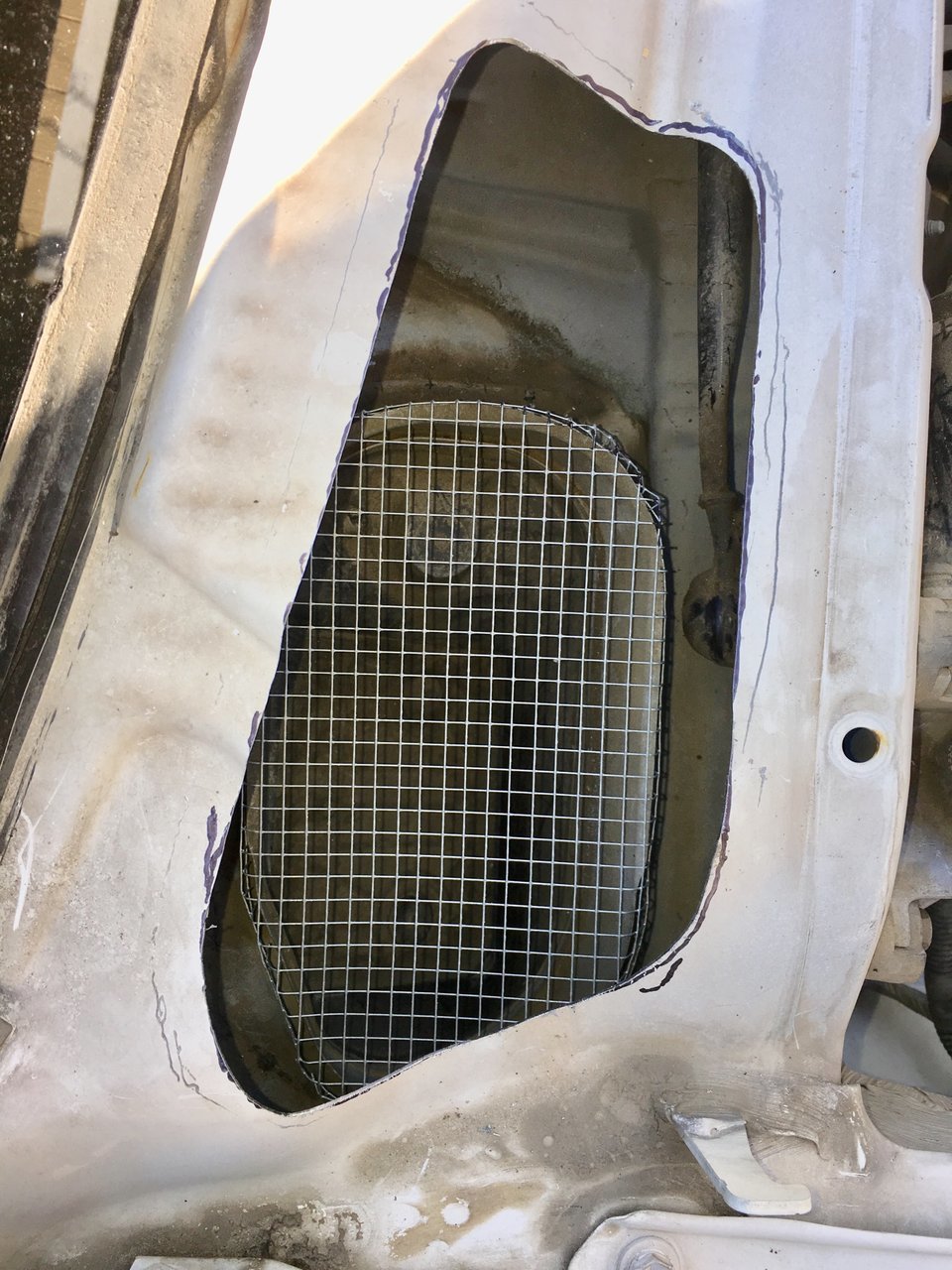

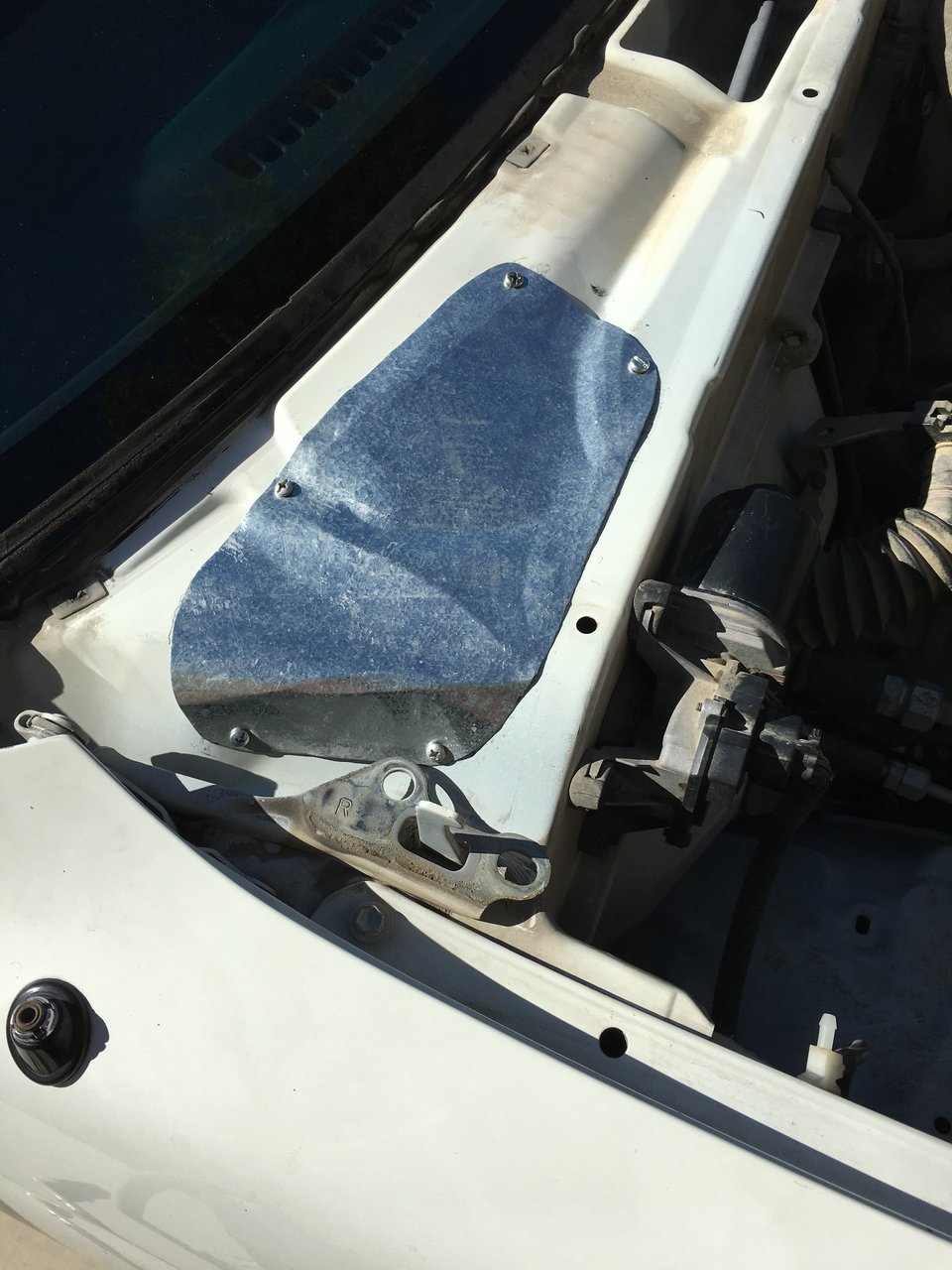

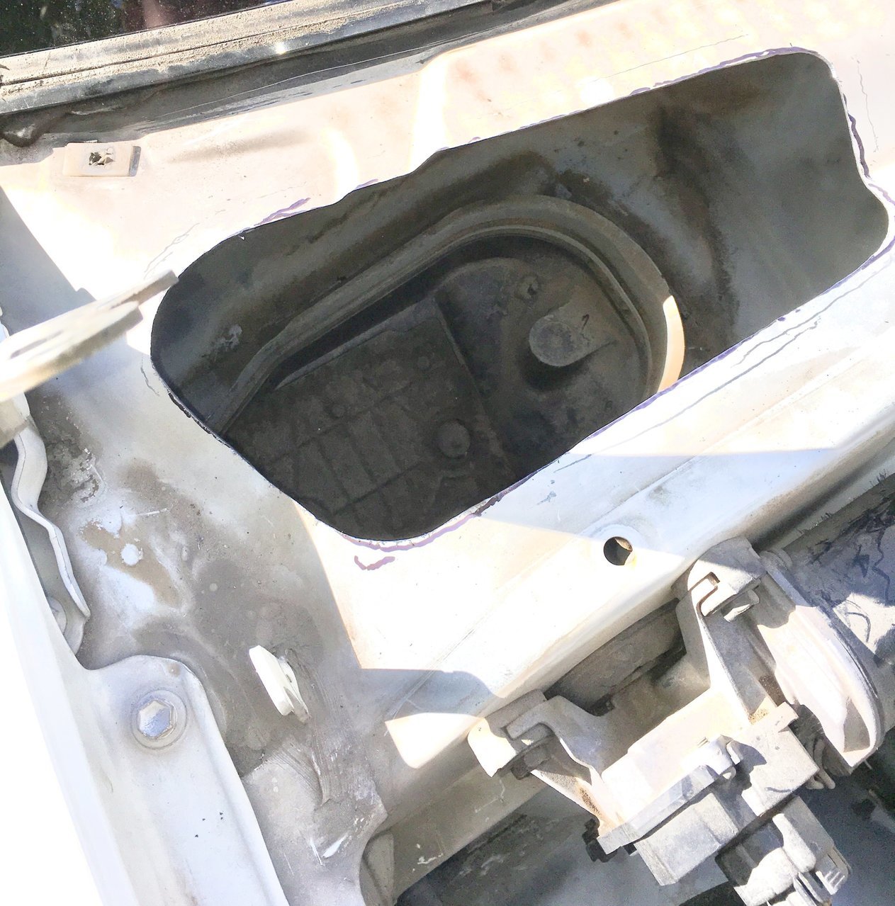

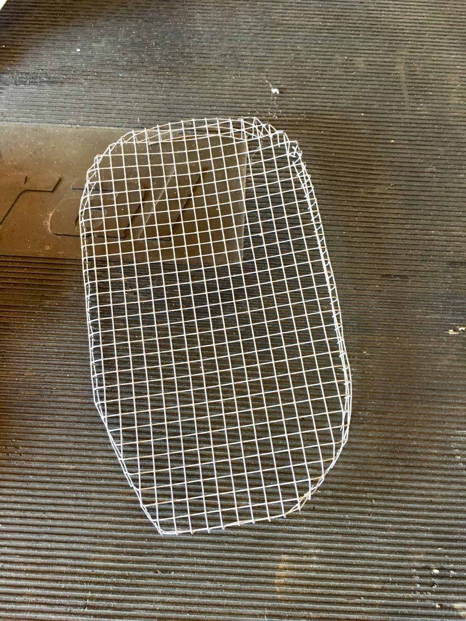

    i had problems with mice coming in from under the fender and making a nest on the fresh air flapper door above the blower motor. Today I decided to put an end to their nest.

    Well I'm stealing this and turning it into a cabin air filter mod. :thumbsup:
