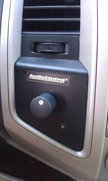

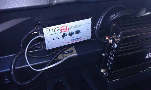

    San Diego
    2010 DCSB MGM
    i dont know if ill be much help with this...but more info the better right??
    i have my stock head unit and stock speakers. i used AudioControl LC2i to get the low end signal. you simply tap into the two rear speakers and it processes the mid range into low range. it also has a nice feature of automatically turning on and off without the need of running a remote line. it also has a switched output to switch your amp on and off. there are 3 different knobs to best tune the system on top of whats available on the sub amp for tuning. it then has a remote knob the adjust the sub output in the fly since the stock head unit obviously doesnt have a sub level adjustment.

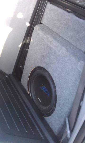

    my alpine 10in hits harder then it did when it has hooked up in my old truck connected to an Alpine head unit! and it does not rob any power from the rear speakers what so ever! i couldnt bee happier with the outcome
    so im not sure if this is any help to you or just a wast of my time lol but hopefully someone will find it informational
    the high to low processor
    the knob to adjust sub output that i mounted where the 4x4 switch is usualy located
    and of coarse the custom sub box
