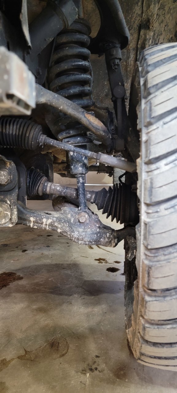

    Post a picture of the CV angle, on the ground.

    For one thing, parts store CV axles are junk for the most part. Compared to OEM they don't hold a candle. You have a 6" lift and I'm betting your CV angles are likely wayyy too steep and causing the CV axle to bind up and break.
    Cheap parts store axles will bind up much sooner than OEM axles will which is why they are breaking so much faster, but either way with too steep of angles on the CVs even the OEM ones will blow up sooner than later.
    Pics will help of your suspension setup and angles of your CVs

  7. Jan 13, 2022 at 12:07 PM
    eon_blue
    eon_blue Most Improved Member
    Mar 4, 2016
    #180213
    66,882
    So that's not as bad as I was thinking, but it is still pretty steep. You can see the inner boot fins all crunched up together

    BTW the pic is the factory one on the driver side same angel tho but I just don't get my tires arnt as wide now with the 14.50 I have Rev bomb and dropped the clutch on about all surfaces with the autozone ones rosted the front tires off on dry Asphalt trying to pull trees out and lots more before one broke now smaller tire breakes all the time as the other day tried it on my drive way to make sure it worked cause it was new work good got on a job 2 days ago that was muddy started to spin and sink so I stopped and put it in 4x4 low 1st gear let the clutch out slow not giving it gas so it would just creep wheels strait as soon as the front wheel spun over pop and it broke so I was stuck same thing happen 2 ago on a big mound of gravel was idling in 4 low turned stated to spin and broke just don't understand ever thing same same axel and ever thing use to last for a will now u turn the button and its broke

    That CV boot is plainly pinched & is not new.

    He said the photo is the driver side, and the oe shaft. Its not a photo of the side thats fucked. But, seems like both will be fucked together sooner or later.
