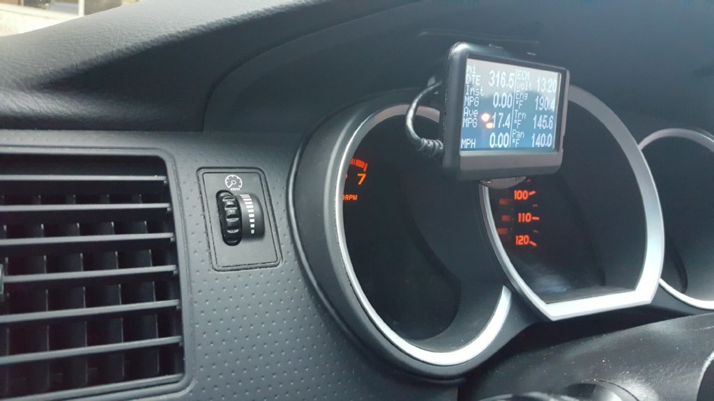

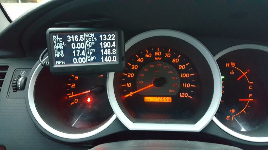

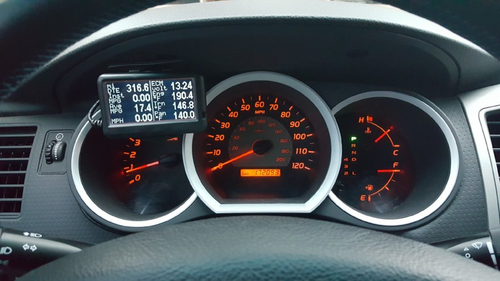

    Mounted my Ultragauge that I bought for monitoring trans temp while towing my new (to me) boat in front of the RPM gauge. I can still see up to 2500 rpm and there are no idiot dash lights in the top section of the rpm gauge so nothing is blocked besides the higher rpm which I normally never reach anything over 3000rpm. Also, I tried in the bottom left and upper left of the windshield and near the rear view mirror but didn't like that my visibility was hindered or that the gauge would be in direct sunlight and in view of thieves. Here it's much less obvious and can't be seen through my tinted windows unless you are specifically looking for it. I used the horizontal surface mount and routed the wire around the outside fo the rpm gauge and down through the steering column.

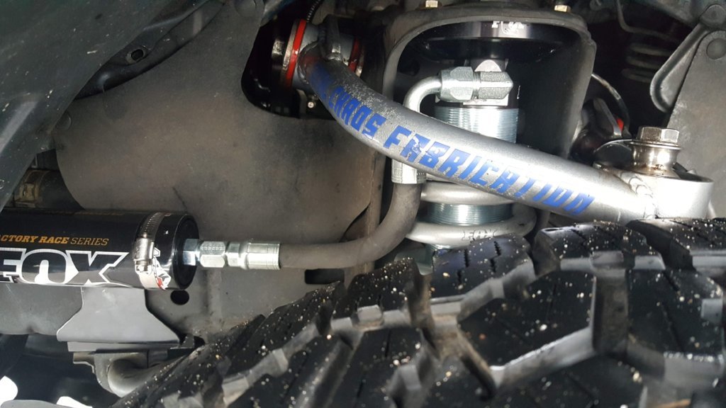

    Installed Fox's to replace my 10 year old (180k miles) ICON's that were leaking. A few weeks later, replaced the uniball in my TC UCA's and the bushings because they were causing an aweful clunking noise and grinding. Then the Fox rears finally showed up after 6 week backorder and installed those too. The lower rear shock mount is a major PITA to line up especially with a bushing that is too wide to fit between the mounting tabs.
