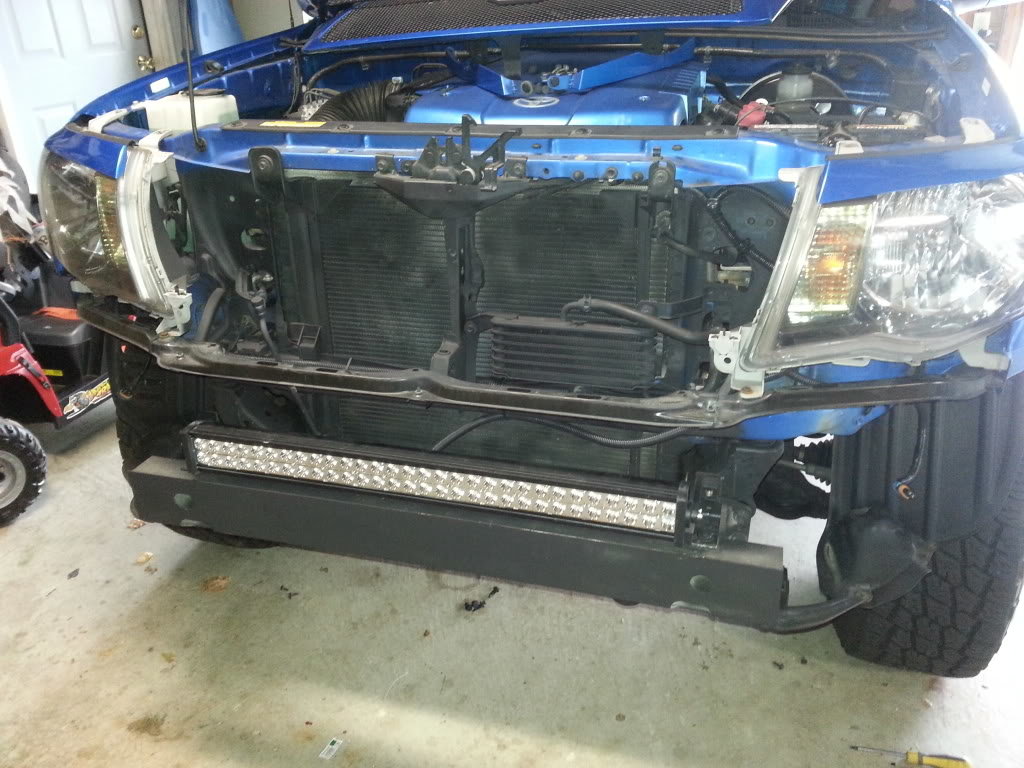

    Where and how did you mount the LED bar. Ive got a 30 incher Im putting in the same spot.

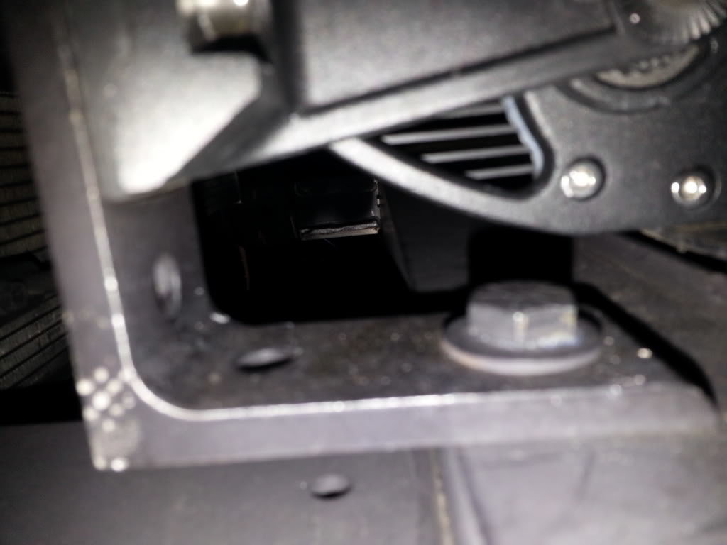

    It's mounted directly on the aluminum crush bumper with "L" brackets. I will get some pictures when I have a chance. Should have gotten pic's while installing but I didn't.

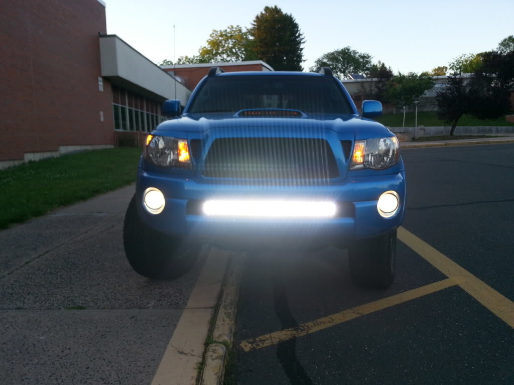

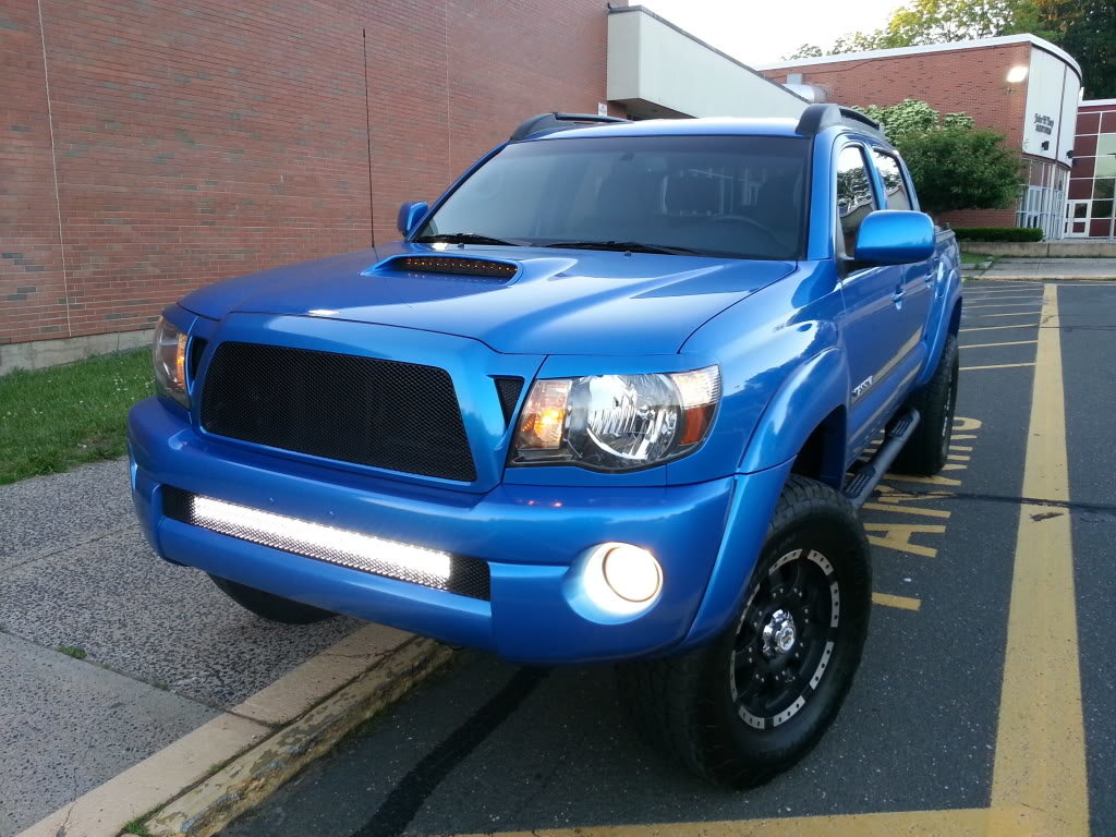

    33" LED light bar

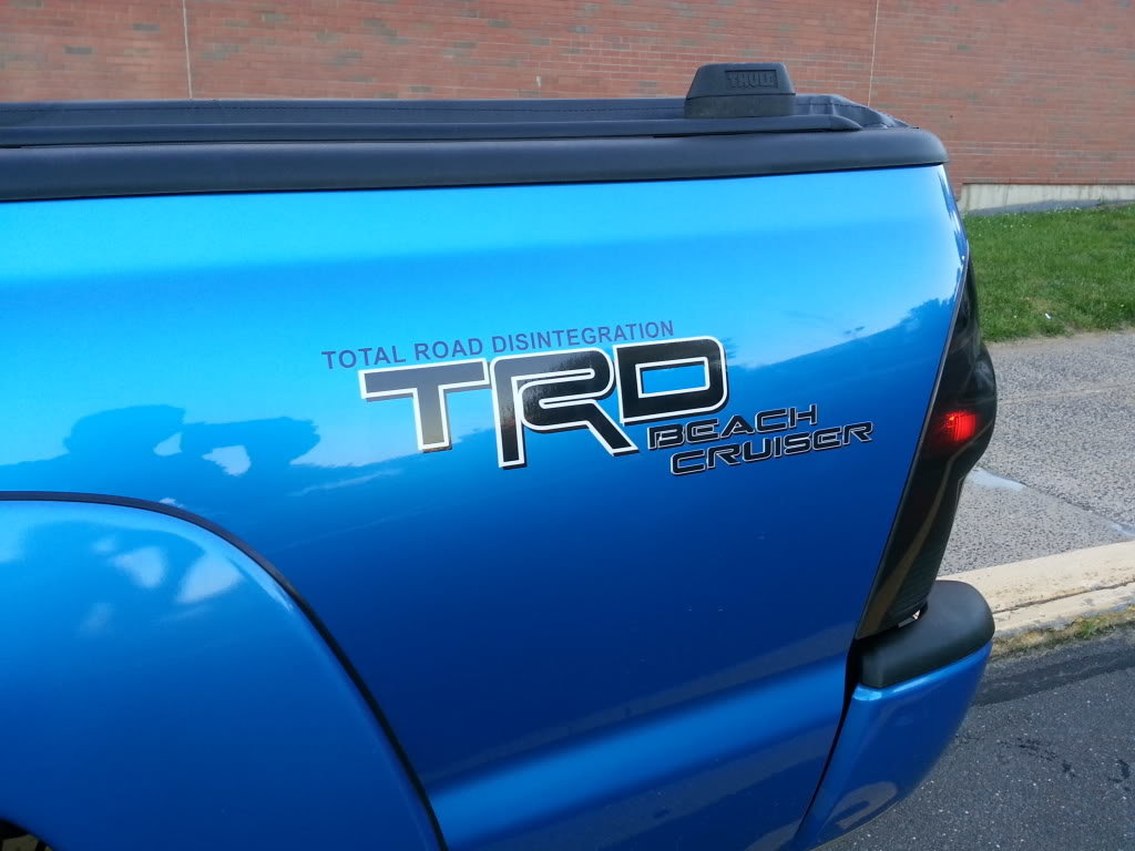

    Beach Cruiser decals

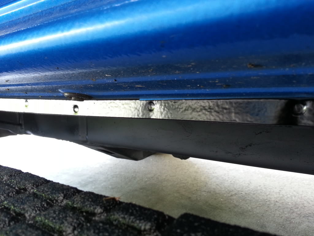

    Line-X'd nerf bars (ends were rusting and step pad was cracked and falling apart)
    Painted pinch weld while nerf bars were getting Line-X'd

    Here is a pic of how my light bar is mounted.
    This is a view from the end of the bar.
    Lights face the right side of this picture.
    Bolt on bottom right is throuh my "L" bracket into the aluminum crush bumper.
    Bar is mounted to the other end of the "L" bracket at the top left of the picture.

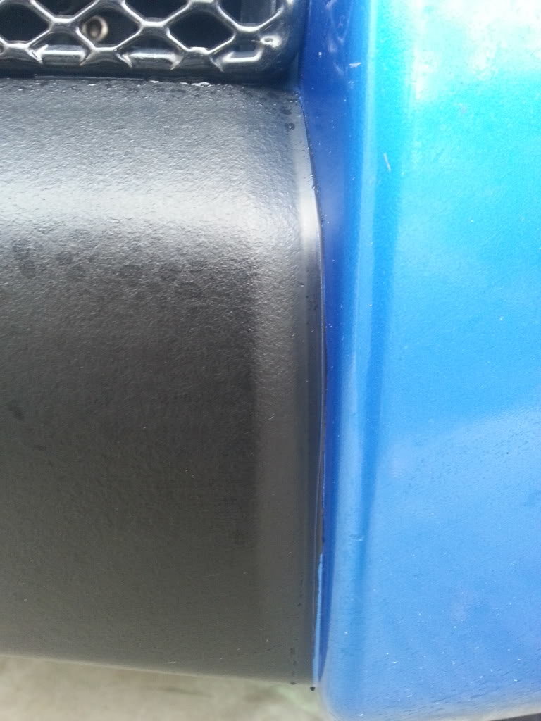

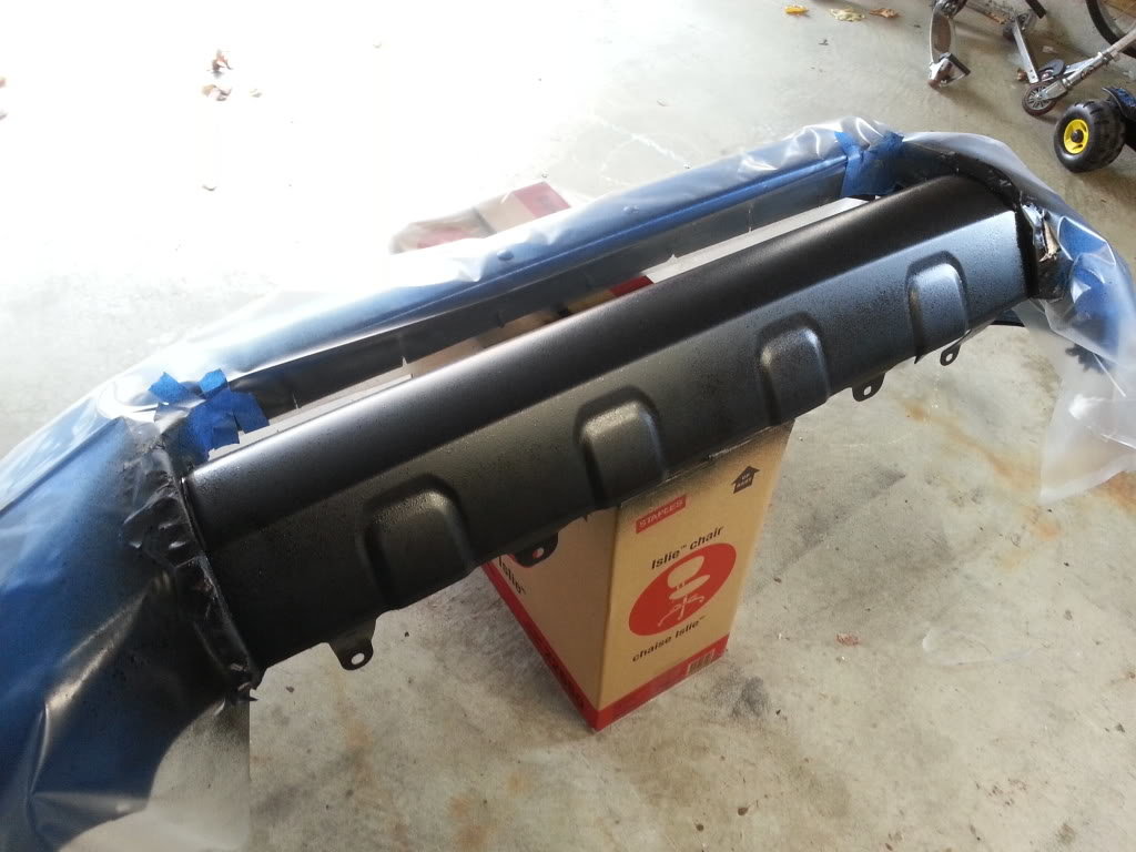

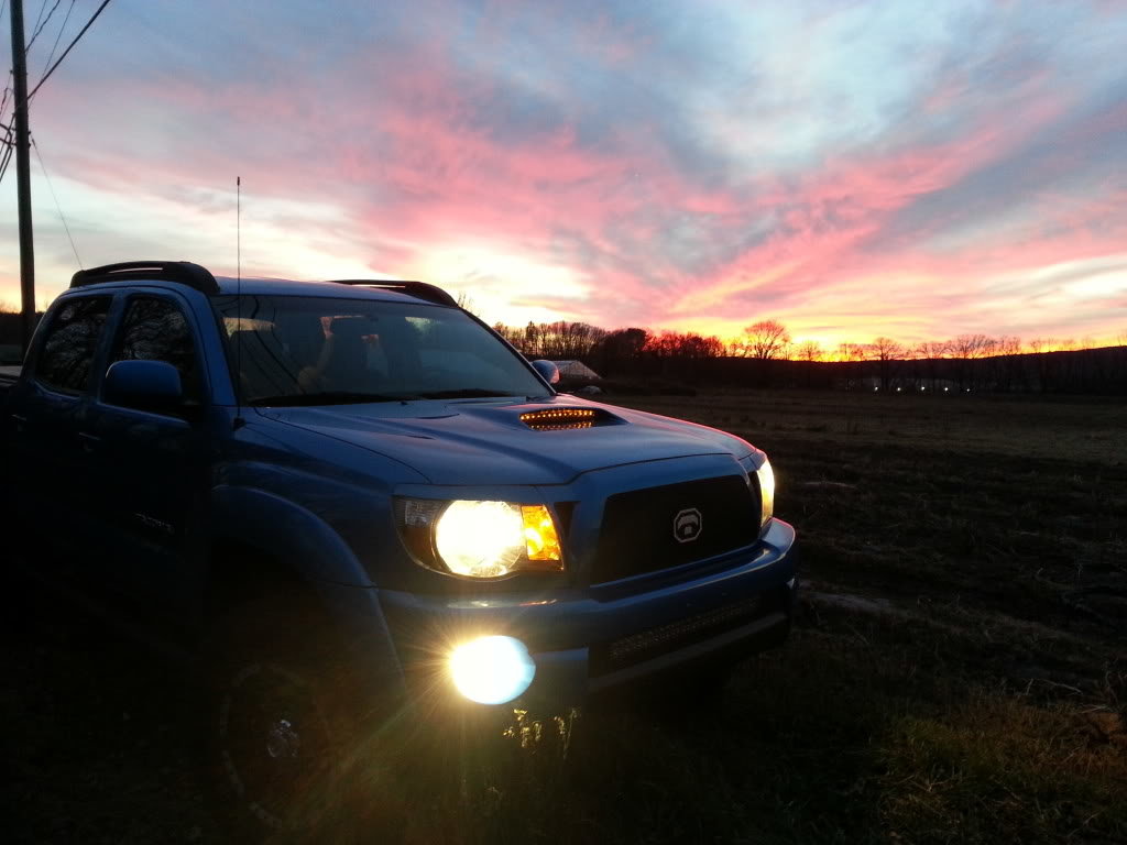

    Some new photos from Nov 2013. Added old school Toyota Truck badge (aka model-T) and plasti-dip lower front valence.

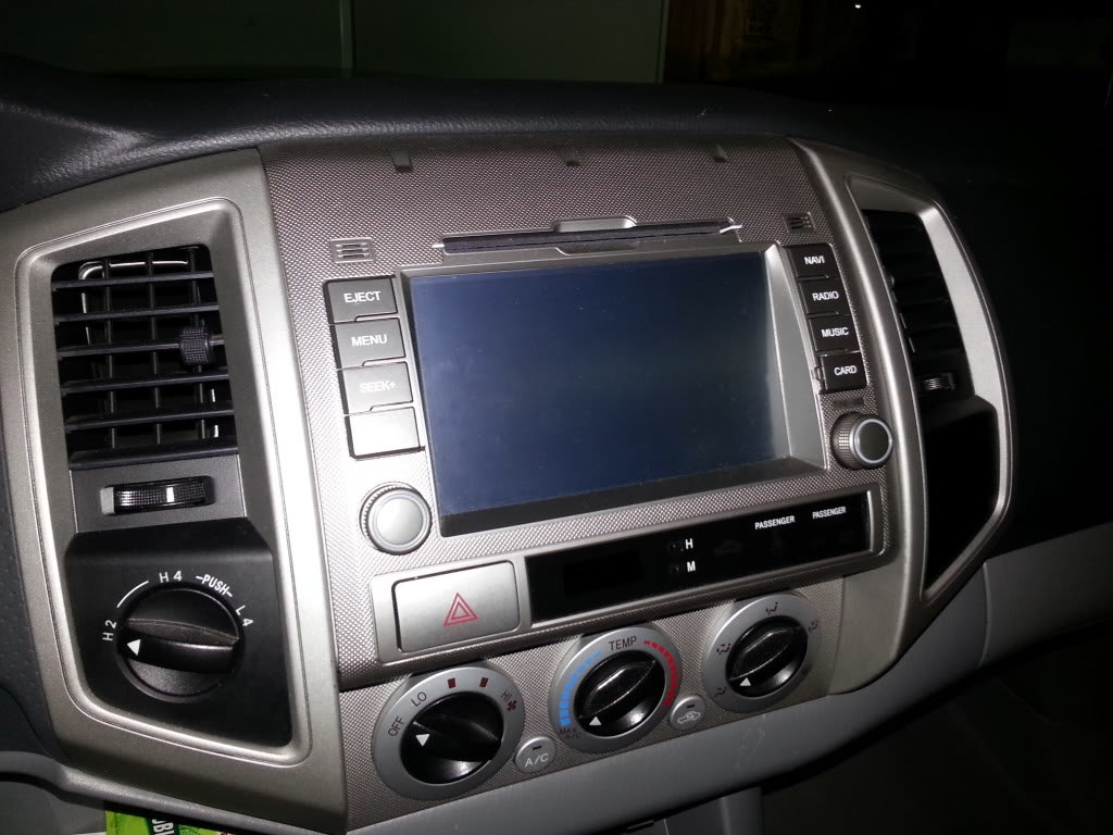

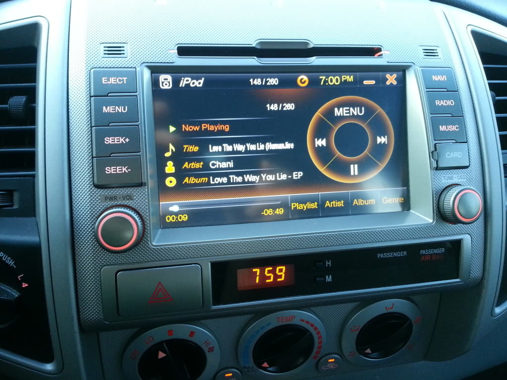

    How do you feel about your OttoNavi headunit? I have been researching the OttoNavi & the Astrium GEE-5985. So hard to gauge from what little information I have seen on the internet. Thanks in advance! Nice looking truck by the way.

    The ottonavi is certainly not cutting edge. It has it's quirks like sometimes the sat/ipod connection fails in which case I need to pull the fuse and re-insert to get the connection back. (I've located the fuse holder under my center console cup holder for easy access - cup holder is easy to pop out and pop back in). Sometimes the ipod display does not show the correct artist or song title and sometimes I can't search by artist or playlist etc... Easy enough to scroll through using the tuner knob. Takes some time to start up after the truck first starts and usually goes to the home screen with no music. Volume for sat/ipod/music is lower than radio so if you don't turn the volume down before shutting off, and go right for the radio when you start up again, you can be blasted unexpectedly by very loud radio. Other times it goes back to where it was when last turned off. Also, can't leave a dvd in the player when off or it makes a horrible sound on start up.
    The pros: It looks factory, bluetooth/DVD/music on s/d card all works flawlessly, navi works great. I located the antenna for navi in the a-piller and gets a signal instantly. Initially antenna for navi was under the dash and took a long time to get signal.
    I would do it again but then I'm not all that into tech. You get everything (navi/bt/sat/dvd/ipod....) in a factory looking unit for $800. To get all this in other aftermarket units would cost double that. It works for me. I can live with the hang ups especially since I have developed work arounds for them.
