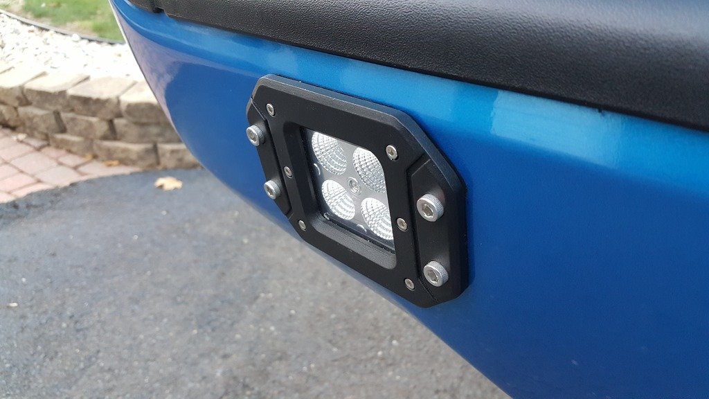

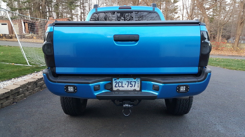

    Ended up keeping the amber fogs. Since last year, I have switched out the G2's for Bridgestone Revo II. Turns out the noise was not the tires but rather my wheel bearings. Once that was fixed, the tires are quiet as can be. Replaced my tonneau vinyl a few weeks ago as the old one was starting to show it's age (7 years).
    Also recently decided to finally install my LED back up lights (flush mount in the bumper). Put it off for over a year as I was apprehensive about cutting up my bumper. They do not sit 100% flush due to the curve of the bumper but I knew that going in and was part of the reason for waiting so long. I'm going to fill the top gap with black RTV sealant for appearances. I covered the bumper cut areas with painters tape, marked my cuts, used a 3/8 drill to mark the corners and then an angle grinder cut off wheel to make the straight cuts.

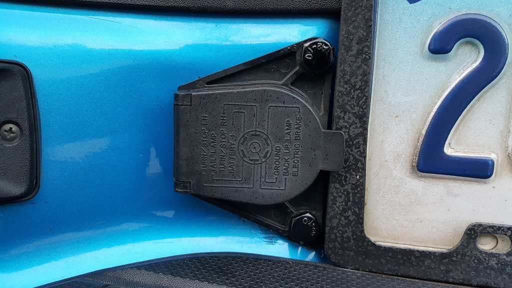

    Also relocated my trailer wire harness as long as I was cutting up the bumper anyway. I used the OEM plug but since it only has the 2 bolts on one side, it did not feel firmly attached when disconnecting the trailer wiring. So I added 2 #4-40 bolts under the cap in the two little triangular areas to snug it up. I used a 2-1/4" metal hole saw to make the cuts. As you can see below, the saw jumped and I scratched the paint a little (even trhough the painters tape which was very little security anyway) below the outlet but used some touch up paint to cover it.
    Lastly, I removed my custom TRD beach cruiser bedside decals since they were not good quality to begin with and were starting to bubble and flake and replaced with 2016 model TRD 4x4 Sport decals. Pics in next post.

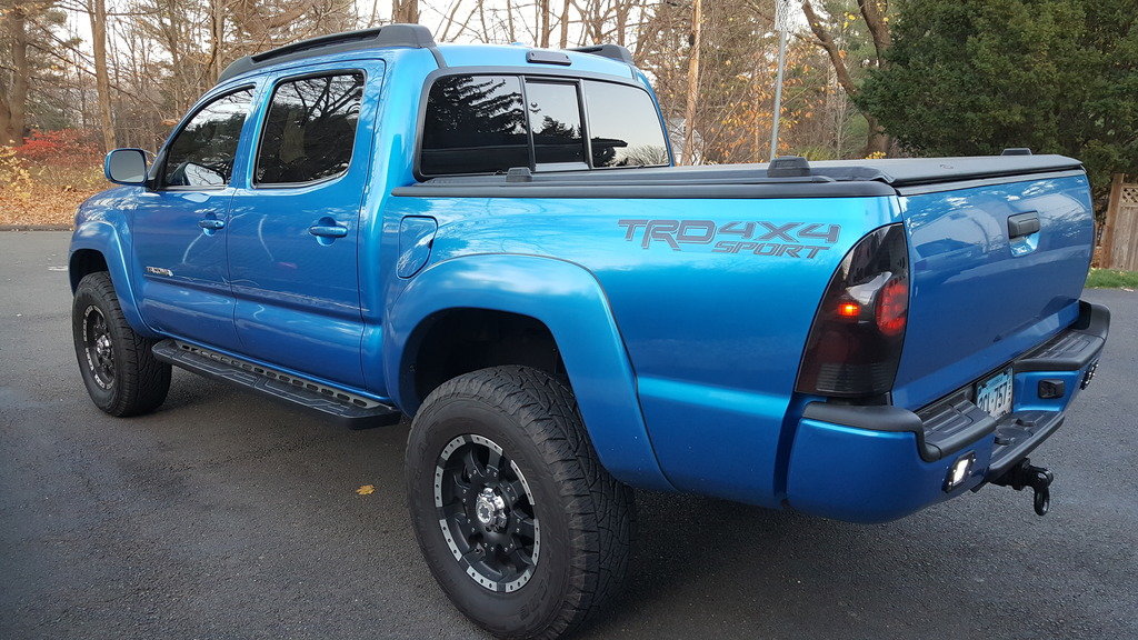

    And some updated shots:
