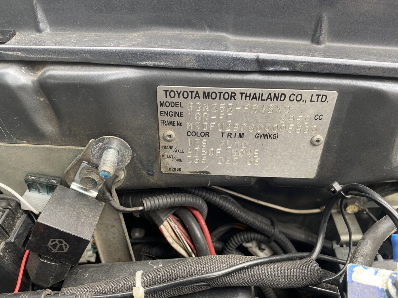

    Hi all,
    I would like some advice on kelford cams and springs .
    I am from Australia and have a trd hilux. I have smaller pulley bolt on mods to suit.. can the group please help with some advice and results of cam and spring install. Do I need to upsize the injectors, I have rebuilt my engine the only mod other that new parts was the thicker head gasket to Lower compression. I have a mechanic mate that keeps telling me it will work against the supercharger. I have discussed this with Kiel from Kelford and would like results if possible.

    What motor is in that Hilux? And please, grace us with some pictures as well please.

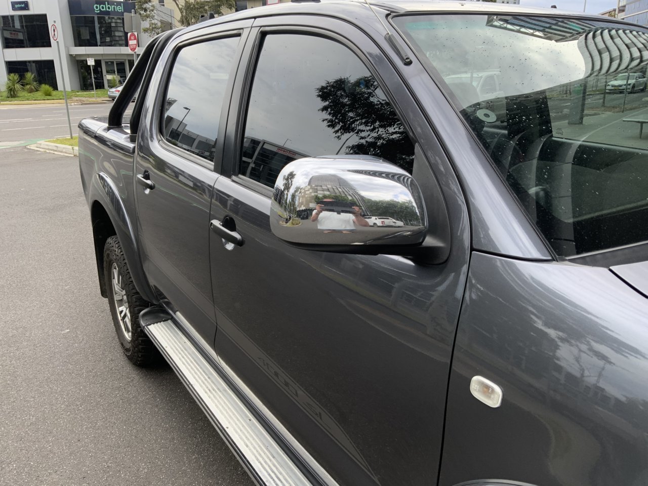

    1grfe ohc vvti2EE27FA4-1B39-42EA-B703-3656491AA43D.jpg 4.0 v6 s/c

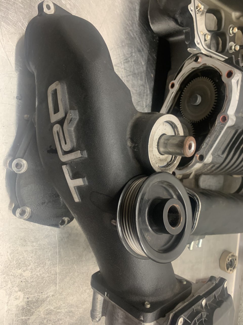

    More pics I have other pictures of rebuild will posts later , have vid 20sec of running having issues posting might be too big

    Okay well, here's some points based on my experience.
    1. Installation while the engine is in the truck is painstaking but very doable. I had to make my own spring compressor though. I also did it without removing the timing chain which took a little creativity.
    2. You won't need bigger injectors unless your pulley is so small that it almost doesn't exist. But you will need a tune for sure.
    3. It certainly does not work against the supercharger. Torque is improved at all RPM.
    4. If you're expecting huge gains, then consider this modification carefully - we're not talking more than 5% more power/torque unless you do a bunch of other supporting modifications. Some will find the price of the camshafts to be prohibitive in that case.

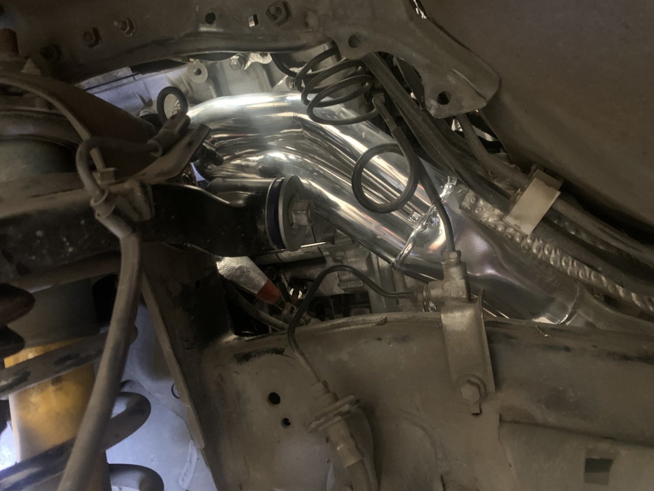

    If your extractors were equal length, then that would give you some extra kilowatts. Hard to tell from your picture, but doesn't look like those are equal length.

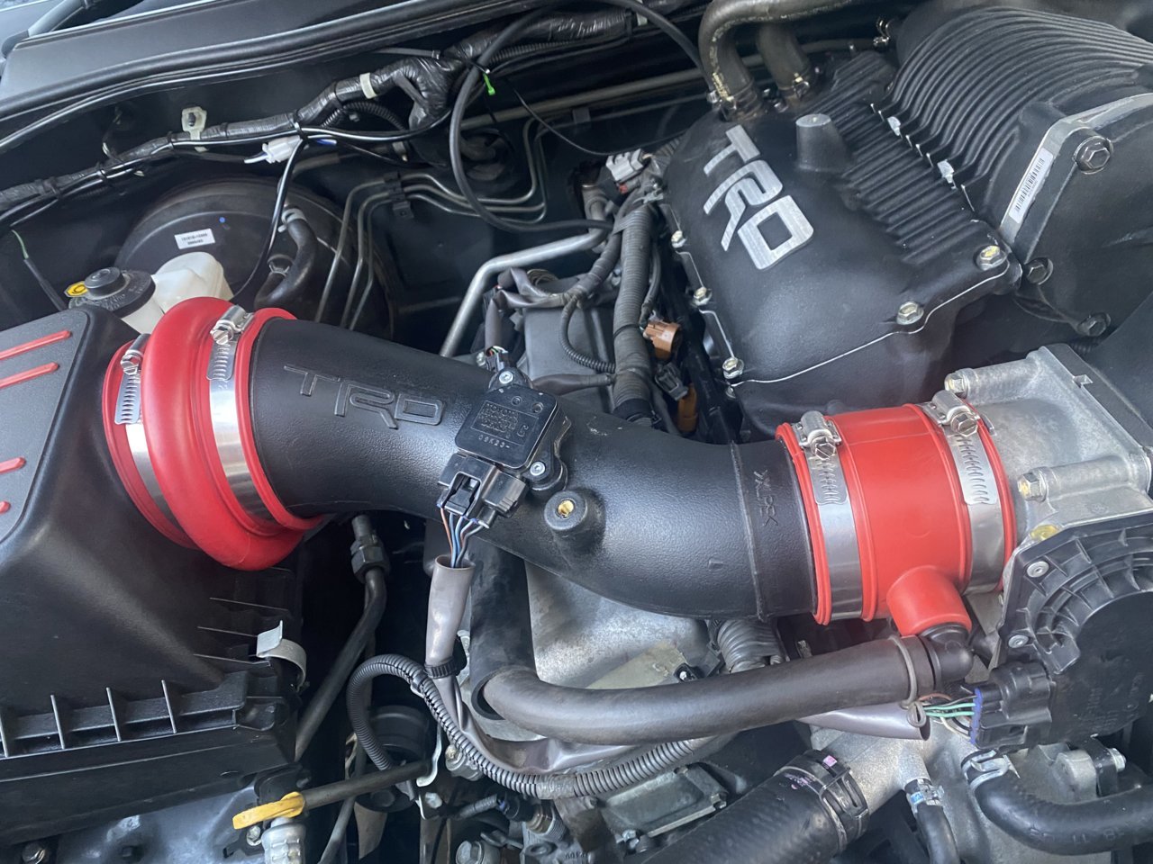

    A slightly larger throttle body off of the dual VVTI FJ or 4Runner. That might be the Prado, over there. I am not sure.

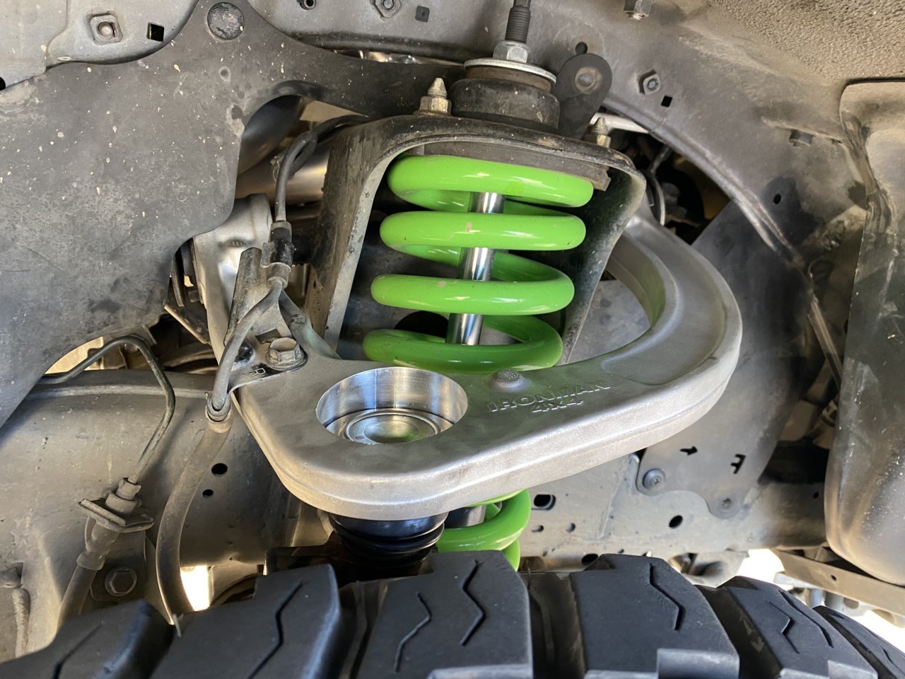

    Also, those UCA's are slick. Very nice.

    Upgraded fuel pump , headers are equal length will look into throttle body but the inlet to the supercharged is the same as the throttle body will that make any difference

    It would have to be port matched.

    Actually what @Torspd meant is to match the throttle with the supercharger inlet. Many have done it this way. The stock throttle does restrict airflow even though it looks the same size as the supercharger pipe (it's about 20% less flow area)
