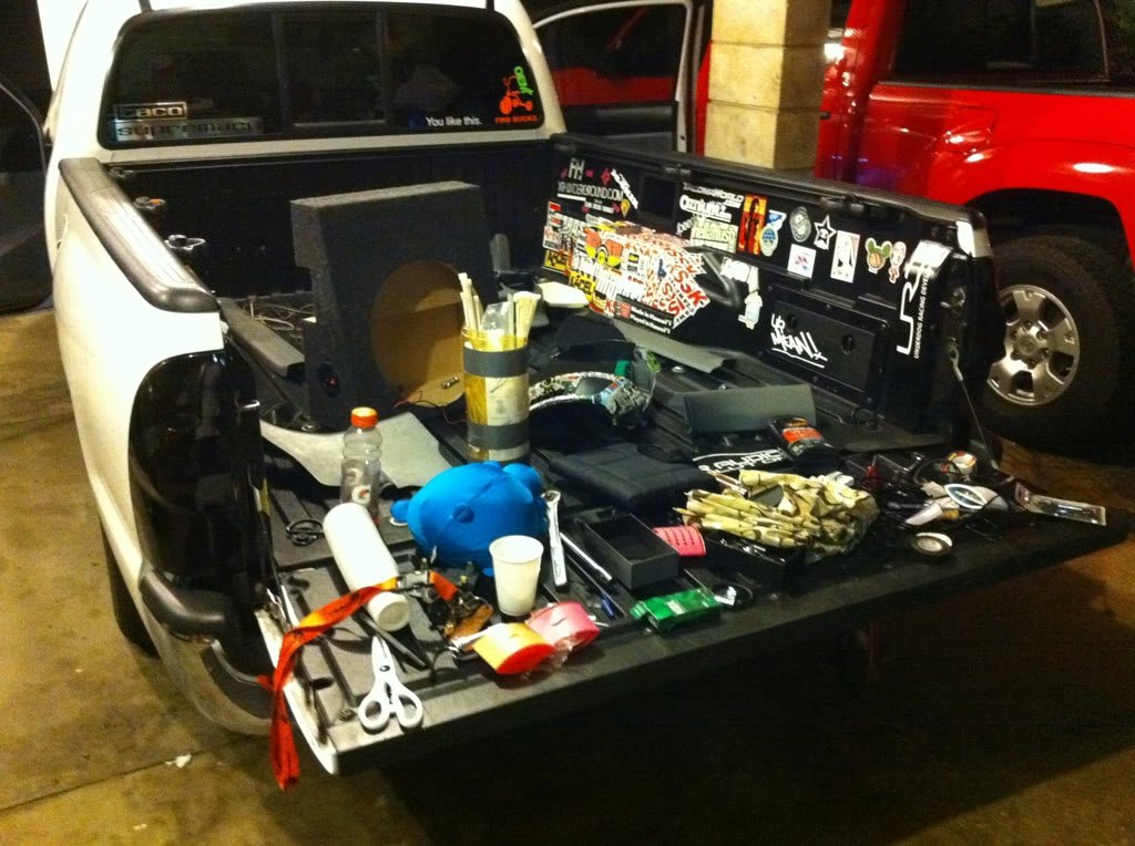

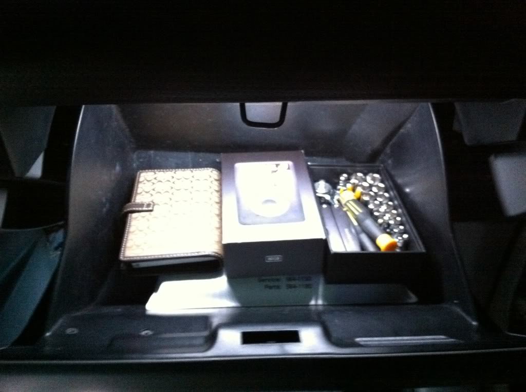

    got bored at work, did this.
    also re-did my glovebox light
  6. May 17, 2011 at 8:25 AM

    i dunno if i had pics of it. i had it for a little while, kept coming off so i took it off, finally decided to re-wire it and make it all nice :D

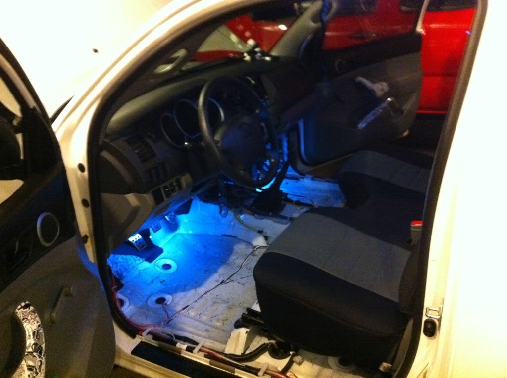

    umm it doesn't exist? lol. i have it connected to the rest of my interior LEDs for now, so when i open my door it turns on. its just run a wire from the battery, fused, to a relay, relay has connections to that, spliced into the door trigger wires, output (to my footwell lights, cupholder lights and the glovebox) and ground.

    instead you could just wire the lights to any 12v power source in your truck and put it on a pressure switch so that it comes on when you open the glove box and not when you open the doors. I'm doing a simliar set up on my center console as soon as I find time to.
    edit: and run a ground somewhere of course and also recommend a in line fuse

    x2. i already had the wiring in place for the footwell/cupholder lights and it was just easier for me to do it that way. your way would work better if your just gonna put a glovebox light in, no need for a relay and complicated stuff lol.

    Yea i try to avoid relays as much as possible. I got fog lights 3 weeks ago and I have yet to get them working lol.

    isn't the relay for that already hooked up? lol

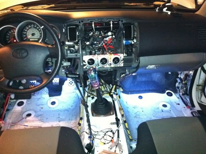

    yayyyyyy. wires wires everywhere! lmao

    oh sweet Jesus lol. So you had to move the clock/hazard lights bar up top to fit the ipad in?

    it was actually behind the setup, but ive zip tied it to the top for now since it's out along with my sounds lol.
    i've been debating on where to relocate it...i was thinking in the lower console right before the cupholders or in the glovebox...still not too sure yet.

    I would just try to relocate the hazard light button. The rest is unneeded IMO and maybe then you could even cut down on the overgrown electrical forest you have back there!

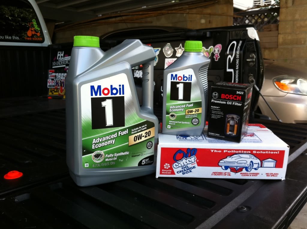

    changed oil today, used oversized Bosch 3422 Filter. gonna post it up just for reference. & so i can remember what size it was for the next time lmao.

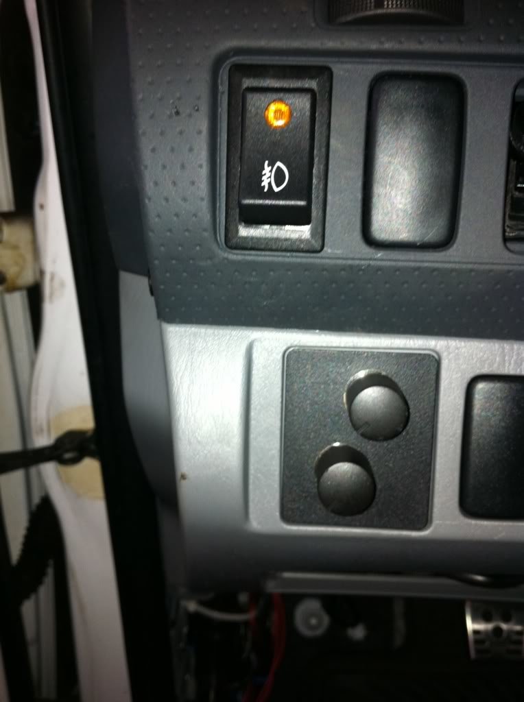

    also installed a new foglight switch and mounted my volume and bass control knobs all nice

    That looks good man. I was just looking at some switches like that the other day on ozinum.com but I didn't see any that had any decals on them. Where did you get them from? Nice and clean spot you chose for the knobs too

    that switch i got with the foglights that i bought along with a whole bunch of other stuffs from some guy here on tw. i found it somehwere else too...let me go look for it on the internets.
    k i think its on ebay just search for toyota oem foglight switch.
    & yeah i like the knobs alot where they are, unfortunately i have no sounds for now since everything's out lmao.
