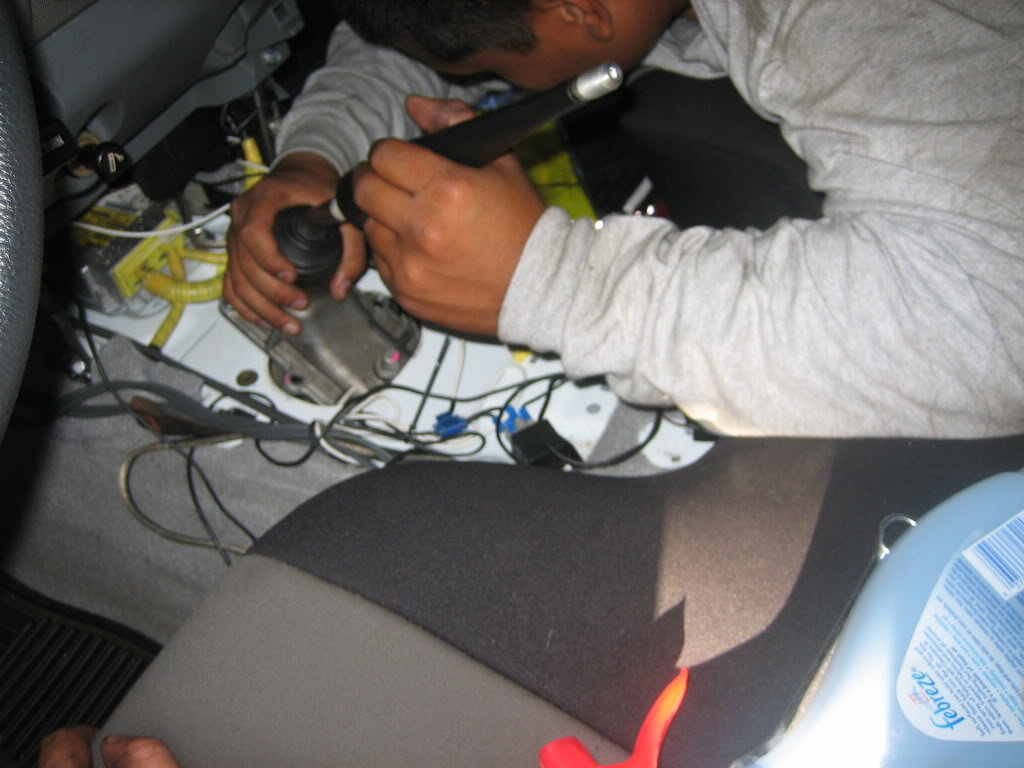

    bought the URD short shifter kit awhile back...the guys from TACOSupremacy helped to put it in on last sunday...here are a few pics and installation tips. not a full on writeup, but some good tips to know. for full installation instructions, go to gadgetonline.com/shifter.pdf
    it's for the 6 speeds but it is generally the same as our 5 speed ss kit install

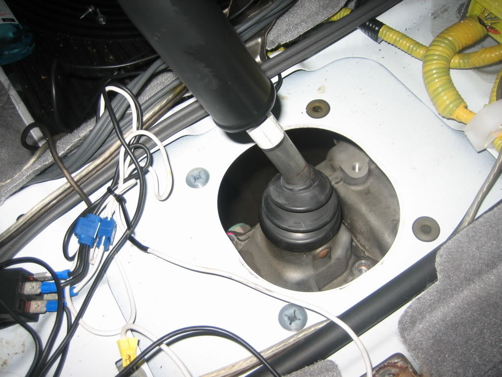

    here are a few differences:
    if you notice, the hole to access the transmission is quite small compared to the 6 speeds. this might just be a regular cab thing though.
    ...and the shifter assembly is quite large.

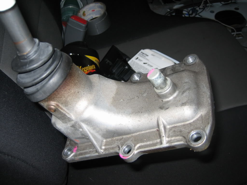

    to get it off, you need to take of the 6 bolts holding it down. you will only be able to reach two of them from inside the cab, unless you have hands the size of an infant. and if your fat like me, and your truck is dropped, you will not be able to fit underneath without jacking the truck up, so plan accordingly.

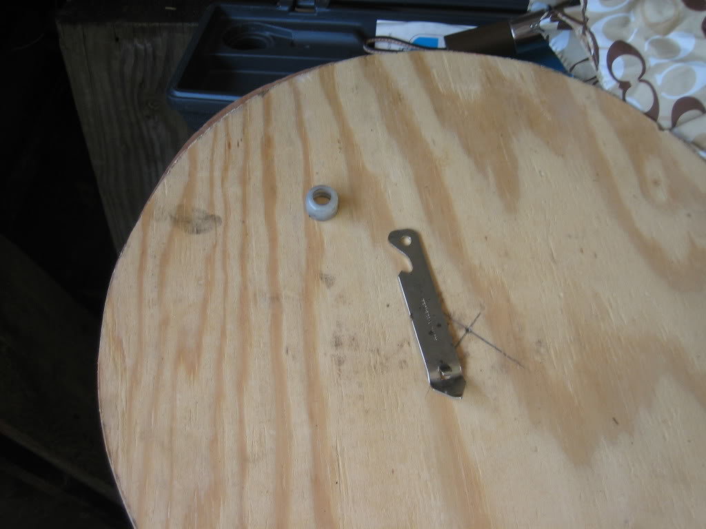

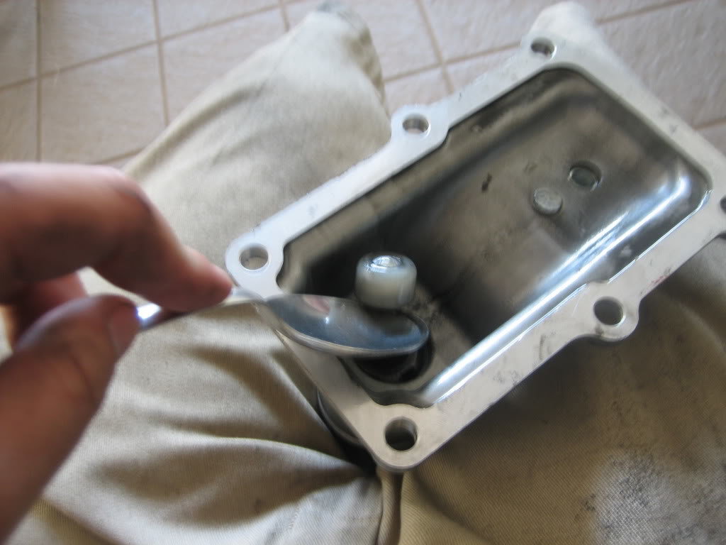

    ok. so moving on, you need to take off this stupid ball thing. don't use a spoon, it doesn't work. so, don't do what im showing you in this next picture.

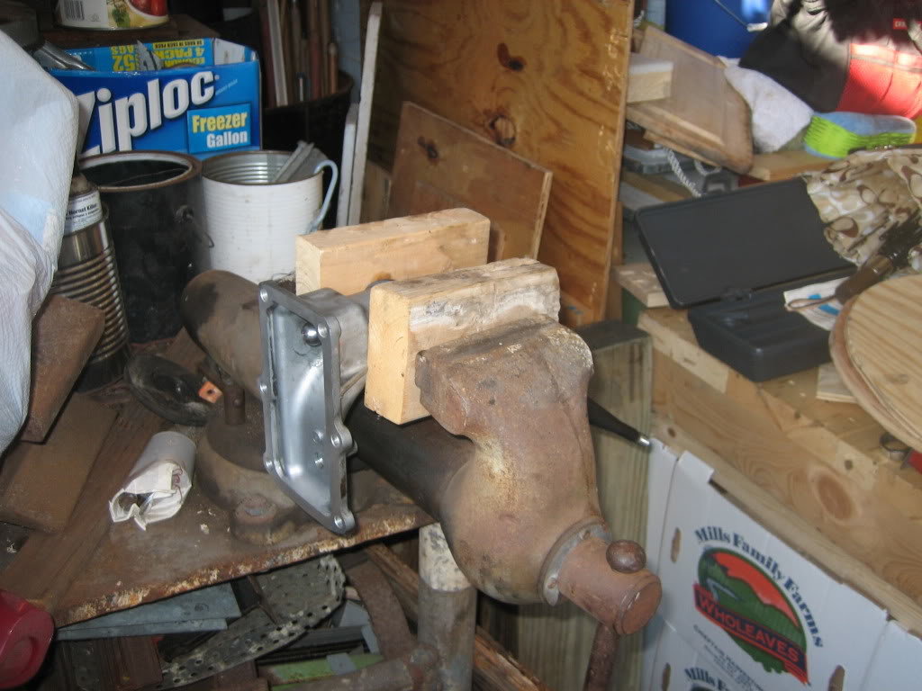

    what your going to want to do is place it in a vice, makes things much easier.
    use a bottle opener, works like a charm.

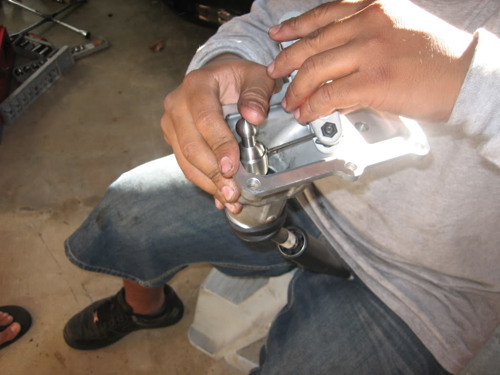

    this is just like the instructions. put locktite on the little bolt and use an allen wrench to put it on the shifter. don't forget to put the little plastic ball thing that you took off earlier.

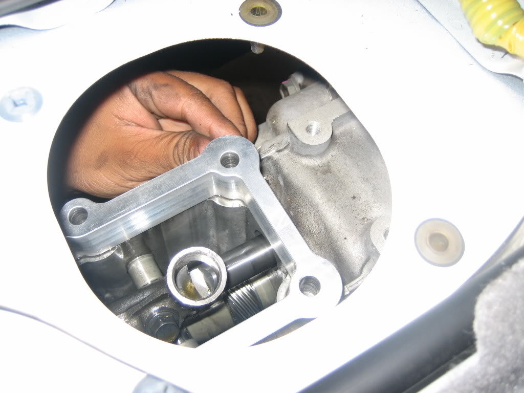

    test fit the spacer, put the RTV silicone on it, put bolts back on. allen wrench is needed for the new bolts supplied in the kit.
