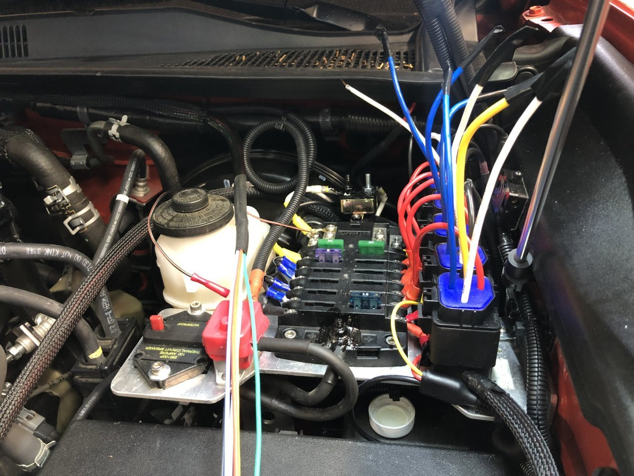

    @Kens04Taco Hey Ken thanks for the relay help.
    This is the board now with things coming together. If I could do this all again I would probably use a busman relay box so it would look less crazy with wires all over.
    I wired in the ditch lights and hood scoop light. Since I’m still waiting on my switch panel I have only tested them by grounding the switch circuit. And we have light.:yay:
    Quick question. I have always understood that changing wiring gauge mid run can lead to over heating. For instance I butchered a ditch light harness because it was not long enough, but to make use of the Deutsch DT DTP connectors. The first ten feet is 16g and then the last three / four feet is 18g. Is the draw on LED lights relay enough to cause problems here?

  5. Dec 8, 2019 at 6:56 PM
    #185
    Cudgel
    Cudgel “Tonka”
    Mar 28, 2017
    #214640
    4,315
    Live in: An Ocean of Plastic Trash
    2017 OR DCLB
    ICON8 Lift -285s. upTOPoverland rack.
    Technically you may consider fuse down at that connection. Be sure your line fuse is gauged for the 18 as if it was full length. As far as draw, the lights will be rated so you need to calculate the line as if it was all 18g for that load.

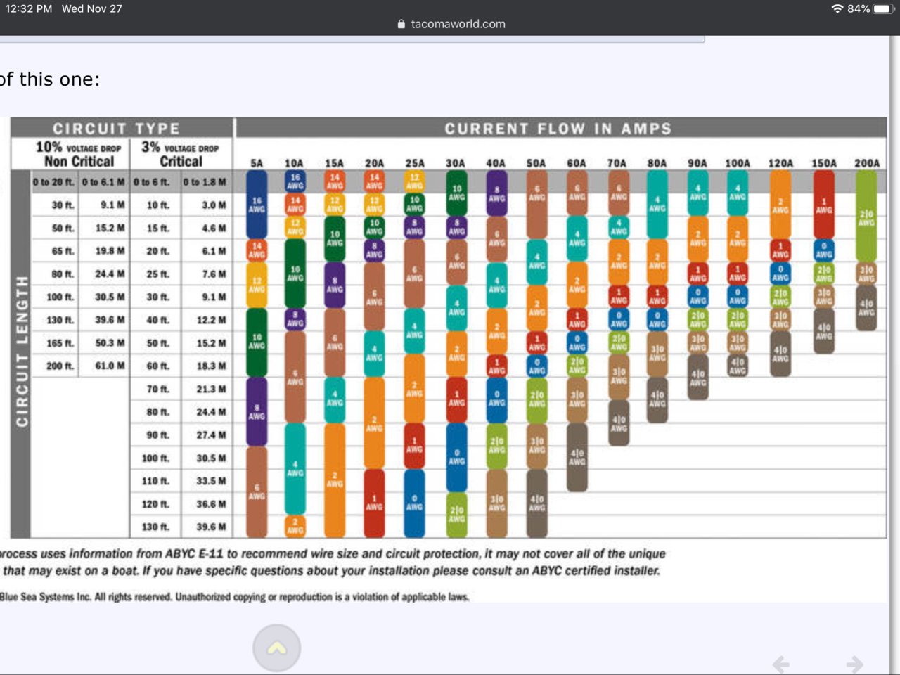

    You can feed a 80 Amp circuit with one wire. With regards to size you’ll want to use a chart to determine wire size based off load and length.
    However... can you give me the specifications of your compressor? Because if you have two independent circuits or dual motors do not do this. You could fry your motor and never pop a fuse.

  11. Dec 8, 2019 at 9:35 PM
    #191
    Stopmithering
    Stopmithering Well-Known Member
    Oct 5, 2016
    #199003
    398
    Stuart
    17 Tacoma TRD Sport ACLB MT
    Okay so I have two Cali Raised pods rated at 27w each. They came on a harness that appears to be 18g with a 30 amp fuse.
    But if I understand right 27wx2=54
    54/12=4.5 Amps
    Is a 5amp fuse appropriate?
    I extend the harness 10 feet. Is the proper way to do this , to open up the pods so there is a larger gauge wire running all the way?
