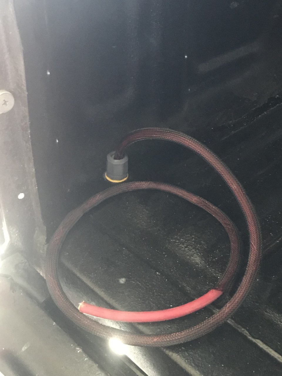

    This is a picture of a way that I route large gauge wires through sheet metal that will exposed to the elements on either side. If it’s a small wire you can a grommet and black silicon to seal it.

    You're incredibly helpful!! the one time i want some ground clearence is when i crawl under the thing lol. ive got the split plastic stuff and its so damn stiff maybe walmart garbage wont be best. Im gonna order some better stuff.

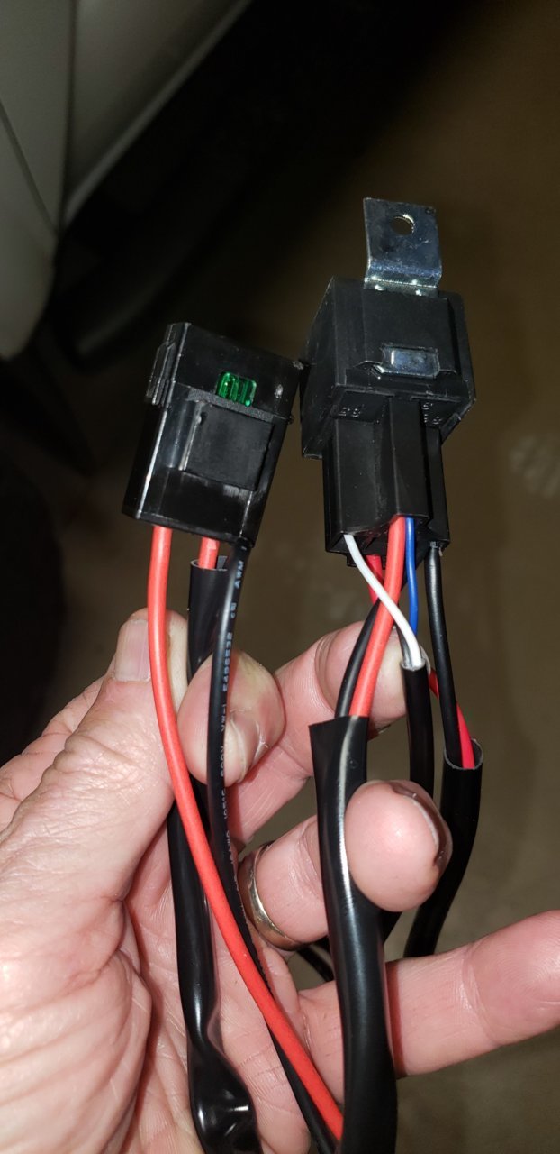

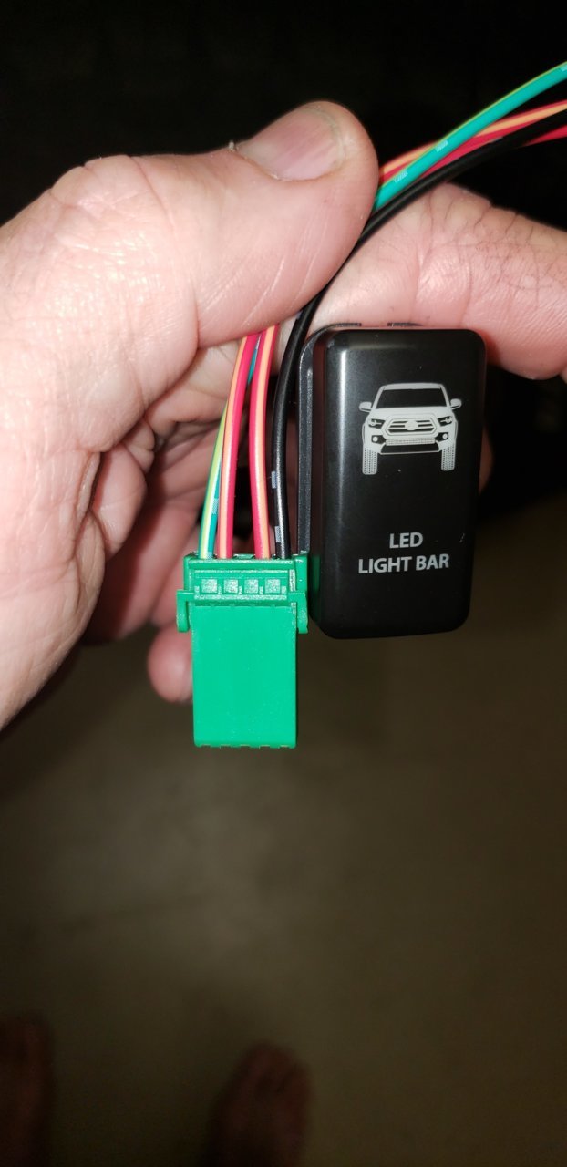

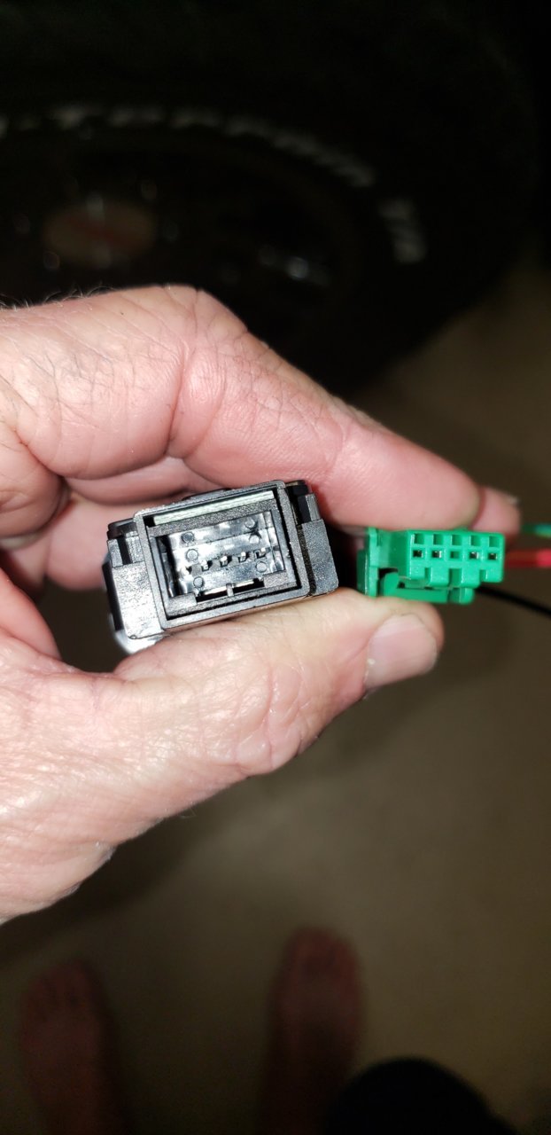

    So I'm a wiring idiot and would like some advise/help. Have read all the post and realize I know even less than I thought. All this talk is WAY over my head but I won't elaborate. So here's my issue. I installed a 32" hidden light bar that came with a wiring harness and push button switch. It has an inline fuse and relay. I cut off the push button switch and plan to use a ch4x4 switch installed in an open slot. I have the light bar wired to the harness and have the wires for the switch run through the firewall. The harness has 3 wires, the switch 4. I attached black to black, green to white and red 1 to blue. When I connect the wiring to the battery the light bar lights up when I push the switch like it should. When the light bar is off the truck on the switch is lit up. I don't have the red 2 wire hooked up yet but did test it and the led light bar words on the switch do light up when the light bar is turned on like it should. But here is my issue. I DONT want the truck to light up on the switch when the truck is not running. I don't mind it being lit when the truck is running but would prefer it to light up only when my headlights are on like my other switches. So this is where I'm stumped as to what to do in order to resolve my issue. I don't have an aux fuse box so planning on running straight to the battery. So does anyone have any suggestions to steer me in the right direction or am I stuck with a switch that's always on? Not sure how much battery it uses to stay lit but I don't want a dead truck. I'm hoping there is a solution and I'm lost at this point and if someone does please try and explain in baby talk as all this electrical talk blows my mind...lol. I have pics attached if that helps. Thanks.

    All you have to do is get power for the switch led from the drl circuit. Basically anything in the truck that lights up when you rotate the headlight switch to day time will work. The leds pull very little power so you’ll be ok.
    I’ve used the shifter illumination circuit, dash lighting circuit, cigarette lighter illuminated ring circuit. It all depends on where the switches are located. If you need help past here lemme know

    I understand that part as I played with that by attaching the red 2 wire that lights the "led light bar" light in the switch to the tail lights. It only comes on when the lights are on. But the light bar will only work when the red 1 is attached to the blue wire hence lighting up the "truck" design in the switch which I'm trying to avoid. That's where my issue is. I don't know how to keep the switch working the light bra without being lit 24/7. Hope this makes sense.
