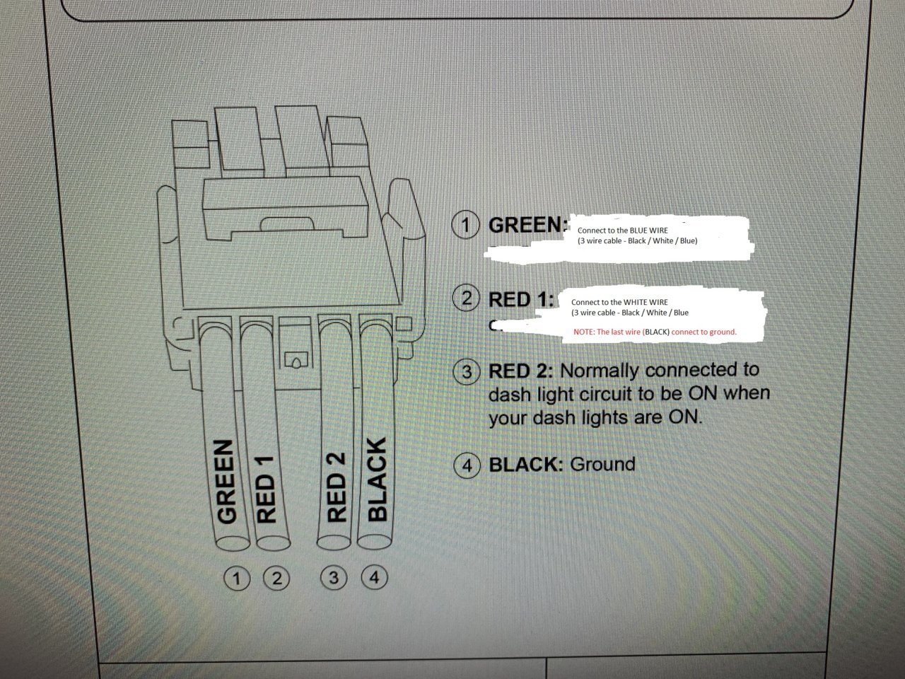

    You have the WHITE and BLUE wires back wards.
    The wiring diagram for this switch (/\ /\ /\ ) can be found here (\/ \/ \/ ).
    https://www.ch4x4.com/product/ch4x4-toyota-small-push-switch-tacoma-3rd-gen-led-light-bar-symbol/
    I changed the descriptions to make it a little easier.
    (1) - Green will connect to the BLUE WIRE on the small cable pictured in your post above (BLACK / WHITE / BLUE)
    (2) - RED 1 will connect to the WHITE WIRE on the small cable pictured in your post above (BLACK / WHITE / BLUE)
    NOTE: The BLACK WIRE on the small cable pictured in your post above (BLACK / WHITE / BLUE) will connect to ground (any screw connected to metal).
    (3) - RED 2 will connect to a DASH LIGHTING CIRCUIT ( find a wire behind the instrument panel that supplies power to the dash light, use a T-TAP [OR] splice these two wires together.
    (4) - BLACK WIRE will connect to ground (you can use the same screw that was used in the - small cable pictured in your post above (BLACK / WHITE / BLUE).
    Hope this helps.

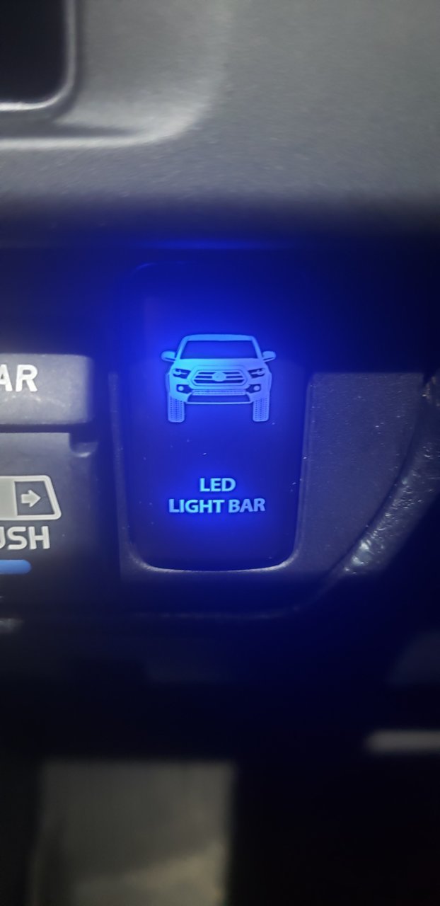

    You are the man. Simple explanation for those with simple wiring minds. Worked like a charm. Attached the red 2 wire to tail light fuse so it would illuminate with the headlights on. Pic 1 headlights on, pic 2 light bar on and light bar. Sorry the pics aren't great. Parked in garage and not much room plus nasty weather out. Appreciate the help Bud. :cheers:

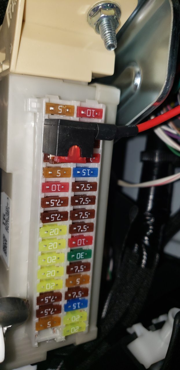

    Can we get a pic of the fuse hook up if possible

    Here you go. Tapped into the rear tail light fuse so the switch would illuminate with the lights on. Hope this helps.20200125_112705.jpg

    Sweet.... thanks for the help.... 1 last thing are you able to put the fuse box cover on with the add a fuse?

    You're welcome. Unfortunately the stock fuse box cover wont fit because its not deep enough but meso customs makes one that's deep enough. May end up getting one of those at some point. Good luck with whatever you are installing.
    https://mesocustoms.com/products/extended-fuse-cover?_pos=2&_sid=94f7beacf&_ss=r

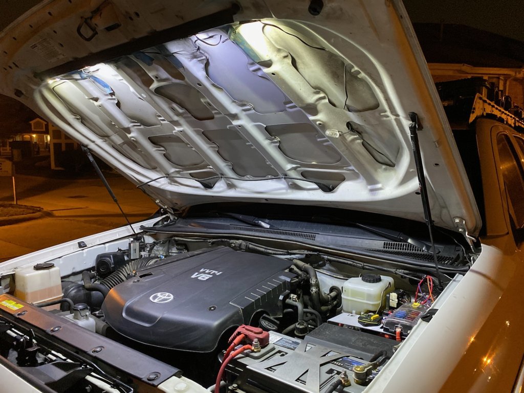

    Ok. Not sure if this has been done here and I apologize if theres a thread about it that I haven't found....

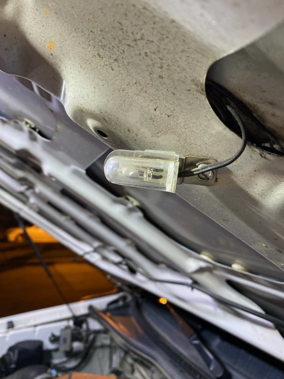

    I'd like to wire in some under hood LEDs that are ran off a relay and switched with a tilt switch attached to the hood. That alone I think I could do. Here's the tricky part. I'd like to have a 3 prong lighted switch in the cab also. That way, if the tilt switch gets stuck closed, the lighted switch will illuminate and tell me it's on. Also, I'd like the switch in the cab so I can turn the lights off if I were working under the hood during the day for an extended period of time.The whole idea is to just keep the switch in the cab on all the time unless I didn't want them on and use it as an indicator to tell me if they were on.
    I think I've figured out the diagram and was wondering if someone could look it over and tell me if it would work and more importantly, is it safe?
    Thanks

    you won’t need the relay to run leds. You’ll just run redundant switches. The power wire will be
    Battery—-fuse——positive lead on led
    Inside the truck you’ll find a good ground point.
    Ground——input side of switch——output side of switch——input of pressure switch under the hood—-output of pressure switch—-ground wire on leds

    Thqnks for the reply! Ok didn't know if it would be safer to run a relay... I'd like to keep the lighted switch in the cab on at all times (except for when i want to turn them off during the day) and use it as an indicator light so I dont end up with a dead batt like I see so many others struggling with. I guess I just dont trust the tilt/mercury switch and it'd be nice to have a switch to turn off the whole system.

    If you’re really worried about it you can get a single led and wire it in parallel with your leds under the hood. You can get a blank switch cover that goes into the factory holes in the dash and drill a small hole and mount it in there. Or mount it where ever u like. If the led is lit the lights under the hood are on

    I like that idea. I know there are simpler ways to run under hood lights. I think I've read every post haha. I was initially going to just run a simple switch under the hood. I wish I was the type of person that would never forget to flip the switch off but I know I would probably forget. So that thought was the catalyst of trying to figure out a fail safe option

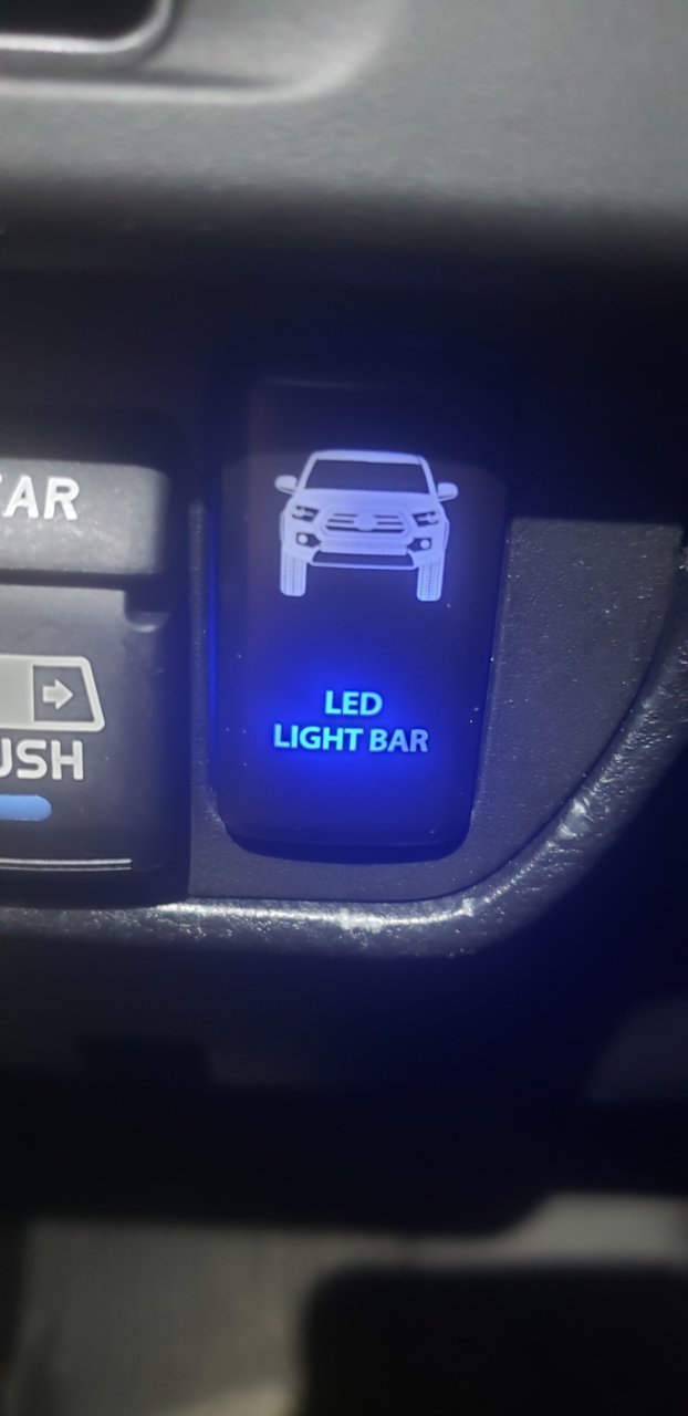

    I haven’t read all the pages to know if this can be addressed but can you explain diodes? And how do you know which way to install for current flow?
    Here is my problem...I installed some overhead CH4x4 Toyota Style push button illuminated switches for my light bars, etc. the switches internal illumination is wired into my dash lights and do work with the dimmer. BUT...the level of brightness is way higher than my other lights and I’d like to get the light level a closer match and I’m wondering if a diode added to the wire feeding those 6 switches is the answer.

    This may be late...but I used a mercury filled switch and it’s worked flawlessly for 5 years now. I think I got it on Amazon
    angled just right...off when down and on when up.

    A pin switch on the right side will work just fine. My plan is to install a pin switch with a typical rocker switch close by basically using the pin switch as a fail safe in case I forget to shut off the under hood lights. Others have installed a switch in a hole that already exists and it works great.

    Ok yeah my tilt switch is also a mercury switch. I might just wire up the hg switch and if it ever fails me, I'll wire in a tattle tell light.
