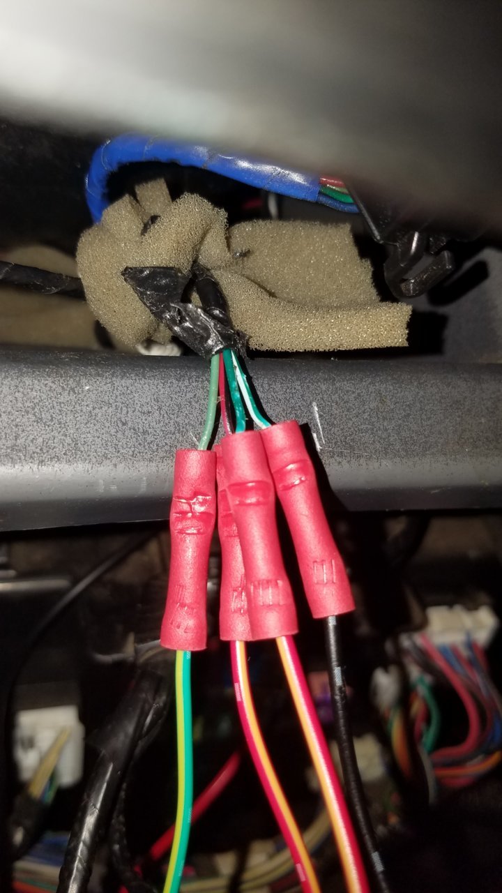

    So today I went back to clean up the connections and tuck everything away. I heat-shrink soldered, went to test and low and behold, the same problem - M2 is blowing on low again. So I get the ohmmeter out, suspecting the same problem (bad connection) as last time but the wire is getting a solid connection all the way from the control dial to the resistor plug. Maybe my "fix" last time was false and the real problem still remains.

    also, it's my first time using these heat-shrink solder connections...maybe they aren't doing me any favors?

    My experience with those is that you need something that gets the perfect temperature. What happened when I tried to use them was i would end up melting the heat shrink as I got it hot enough to melt the solder. Double check that you didn’t melt through and they are making contact. Lemme know what you find

    Will do - I may just solder it traditionally. The wires are definitely in contact at the moment, but maybe not enough.

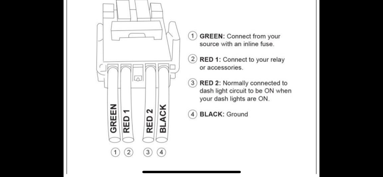

    Hey ken, could you give me a bit of advice? Hooking up a ch4x4 on/off switch for my rear diff locker and it doesn't seem to work. Maybe I just need another set of eyes on my wiring. The only thing working is the lower text LED. When pressed, the upper indication LED doesn't turn on nor does the diff lock indicator on the gauge cluster or the actuator respond. The fuse is fine. I'm a bit at a loss. Thought this would have been a bit more straight forward of an install.
    Bit of an update: I didn't realize until I drove around that my power windows, air and A/C, and Clutch cancel don't work. Along with that my ABS and parking brake dash lights are on. I have no idea how this happened, but it was after I worked on this switch. There was a point when I got to wires wrong with the switch. This is turning to be a real pain in the ass.
    Another Update: Never mind all this... blew IG1 No.2 fuse. Everything works now

    Hey bud, first off I enjoyed the play by play updates as you problem solved. Sorry for getting back so late I’ve been really busy at work and I don’t get too much downtime. Glad you got it working and congrats on your locker :thumbsup::mudding:
