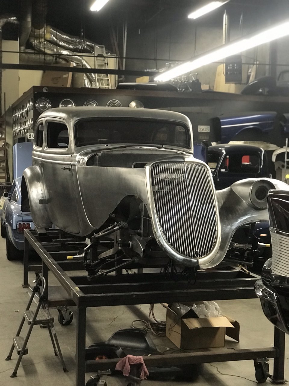

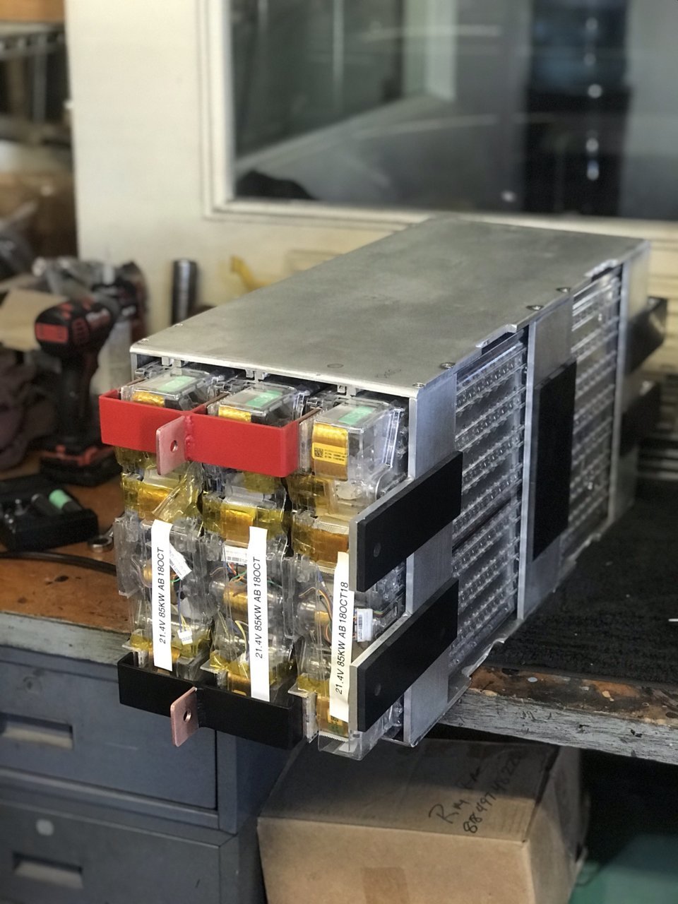

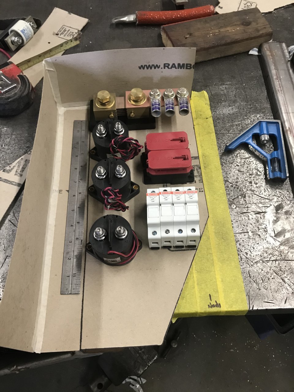

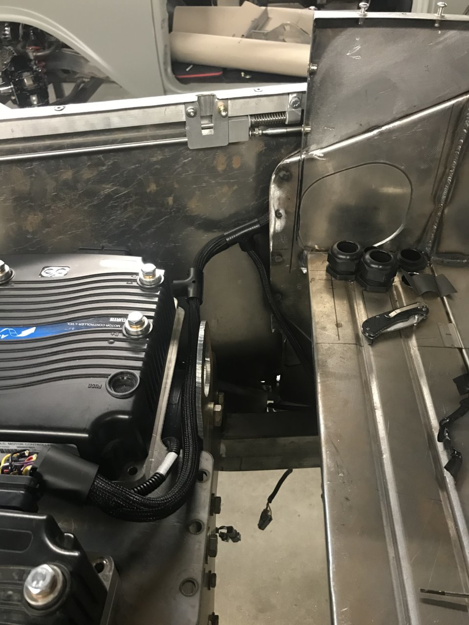

    Here’s my current project. It’s a 1934 custom ford Victoria. This car is getting 3 electric motors and controllers. It’s a full EV conversion that I’m doing for Tim Allen. It’s quite the project electrically but it’s very rewarding and fun. I’m hoping to get her turning the motors on her own power in the next 6 weeks hopefully sooner.
    What’s everyone else working on? Let’s see it
    Controller communication and other related circuits loomed and T’d I still have to install the connector covers and some more tweaking to get it to “flow” the way I want but it’s closer!
    Mock up of a contacter, fuse,shunt, and relay box I’m getting ready to fabricate after I get it set up the way I’d like.
    These are the battery cages that hold the 3 Tesla model s batteries. As you can see they are paralleled at the batteries via busbars I made. Then all 5 packs are ran in series to give us our final voltage.
    And this is the car. Kind of an old pic but you get the idea.

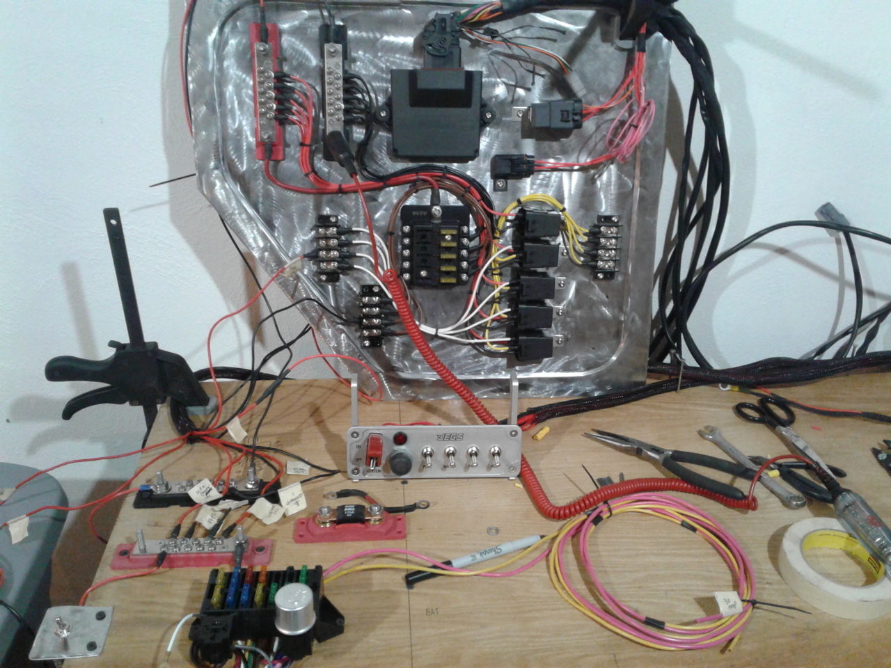

    Ask and you shall be confused by me...lol
    Panel for the race car. 90 Mustang. Ecu is in the center top.
