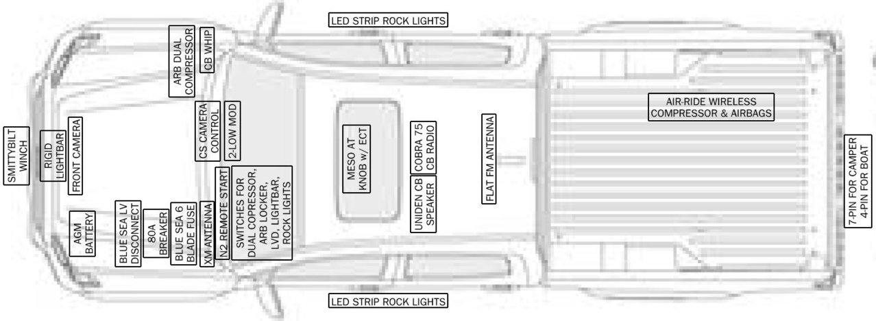

    Thank you for the detailed response. I'm not planning on running everything at once lol, and only a few times a year will I have it fully loaded. Actually, most of the components will be turned on independently, compared to all at once. I'd like to start with a Group 27 AGM battery before upgrading the alternator. The reason for not wanting the dual battery is because the SSO Slimline Winch Bumper up front, and I have the ARB Dual compressor and Tank in the void in front of the passenger side. I'll definitely run everything by my brother (the electrician) as he is great with this stuff! Here's a quick breakdown:
    Thanks again for the help!
    Part list is here for reference.

    I like how you used the outline of the truck with the boxes. Makes my brain happy lol. You could always mount the secondary battery in the back. That’s probably where mine will end up. I would start planning wire sizes and runs. Also thinking about how to distribute power. Don’t be that guy that has 10 wires going to the battery terminal lol. They make some nice terminals and busbars. If you want to make a Bitchen electrical system the way it looks and functions tend to run parallel (pun intended) to each other.
