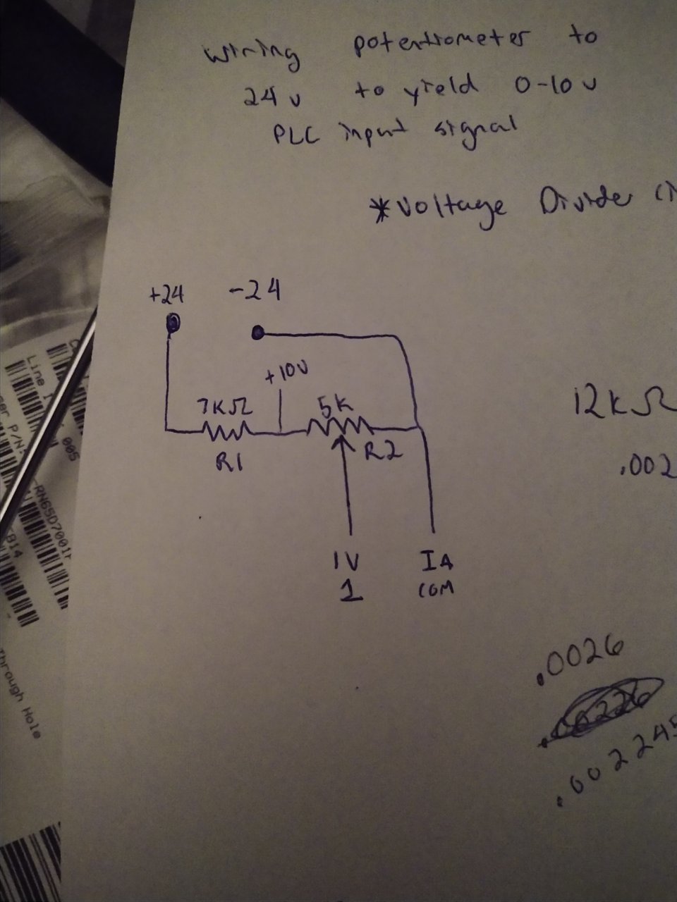

  9. May 28, 2020 at 8:04 PM
    #429
    Blue92
    Blue92 Well-Known Member
    Aug 26, 2017
    #228071
    16,481
    Daniel
    North Carolina
    2018 Sport
    Ive got one for ya. Not automotive related. More or less for clarification, but its stumping me for sure.
    So Im creating a voltage divider circuit so I can produce a 0-10V Analog signal from a 24V DC power supply. Its so I can simulate an analog input signal to a PLC controller. Anywho, this is where my math led me to, and what parts I ordered. (ignore the -24, I meant 0. And the +10V is showing what I should be measuring at that point with the pot turned to 5k)
    A 7K ohm resistor, and a 5K ohm potentiometer. So I can get a reading sans multi meter, I ordered a cheap analog voltage gauge off Amazon. https://www.amazon.com/YXQ-Voltmete...jbGlja1JlZGlyZWN0JmRvTm90TG9nQ2xpY2s9dHJ1ZQ==
    So I got everything soldered up, and connected the analog volt meter to the wiper side of the pot, just in place of IV-1 in my schematic. Fired it up and got a 0-8V range showing on my cheap volt meter and on my Fluke meter, instead of 0-10V like I wanted. After hours of pondering, I disconnected that cheap gauge I got off Amazon and measured with my Fluke 77 by itself.
    9.8 Volts. Perfect.
    But why? Could that stupid little analog voltage gauge really be pulling a 1.8V load just to make the needle come up? I checked it with a 9V battery and its spot on, which is why Im stumped.
    Oh, and with that analog gauge connected, the circuit was pulling 2.24mA at 8V. I havent checked it without the gauge yet.

  12. Jun 9, 2020 at 2:23 PM
    #432
    davidstacoma
    davidstacoma Friendly Curmudgeon
    Nov 2, 2019
    #309695
    4,652
    David
    NC
    2019 Tacoma SR Access cab - Utility
    *OEM Mods: Intermittent wipers, Fogs, Keyless Entry, Lomax
    I’m not Ken lol, but I happened to be here and can answer your question. The analog meter has a much lower resistance than your high impedence Fluke, the analog meter is probably 10 k to 20k ohms (you can check the resistance across the analog meter with your Fluke). So this is putting the analog meter resistance in parallel with your resistor where you connect it. Fluke impedence/resistance on voltage scale is in the Megaohms range so will have no noticeable impact.
    Blue92[QUOTED] likes this.
  13. Jun 9, 2020 at 2:25 PM
    #433
    Blue92
    Aug 26, 2017
    #228071
    16,481
    Daniel
    North Carolina
    2018 Sport
    Ok that clears it up perfectly!

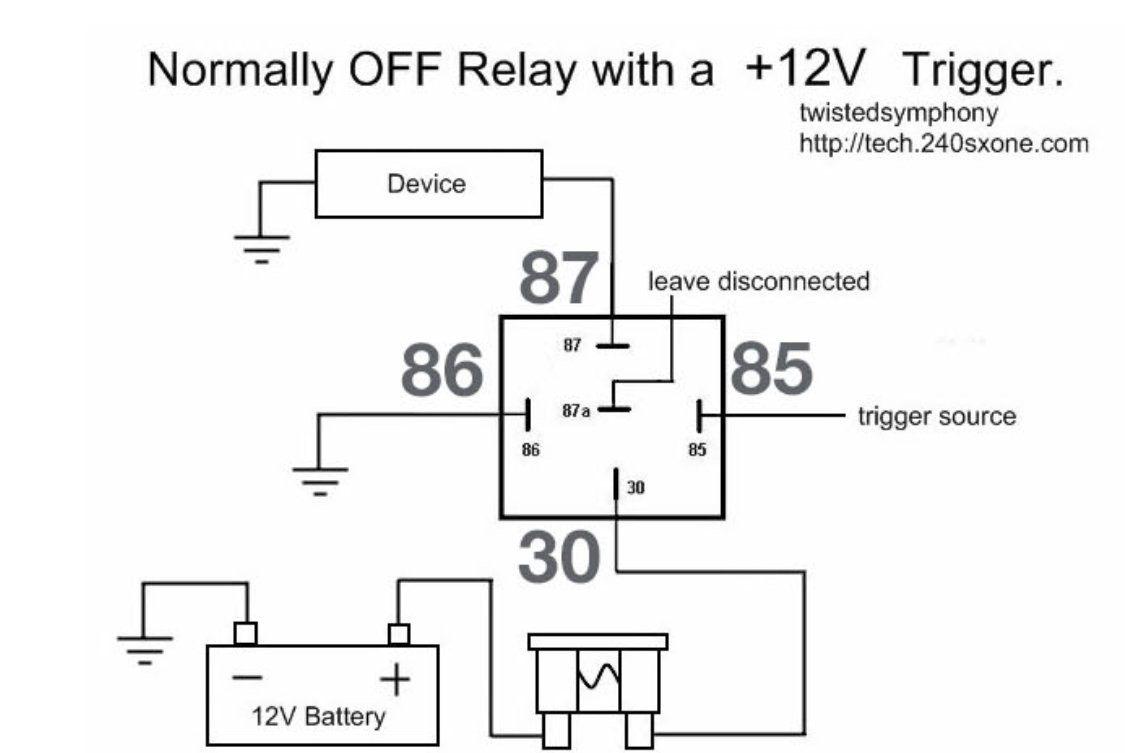

  17. Dec 3, 2020 at 8:45 AM
    #437
    wkndvbz
    wkndvbz Member
    Sep 13, 2019
    #305196
    23
    somewhere in OC
    2016 Grey Tacoma TRD OR
    Hey @Kens04Taco !
    I’m about to build out an independent aux box in the bed of truck.
    Is there any pros/cons of wiring it as normally OFF relay with 12V trigger..?
    added diagram
  18. Dec 3, 2020 at 10:15 AM
    #438
    Kens04Taco
    Kens04Taco [OP] Well-Known Member
    Sep 11, 2016
    #196991
    1,770
    Sunland, CA
    2004 PreRunner 4x4
    kangs and thanngs
    Hey buddy,
    Lets get some more details about what your trying to accomplish.
    When you say Aux box do you mean a switch panel to control accessories? A box with cigarette/usb chargers? an Inverter? all of the above?? Do you have one or two batteries? If you have two batteries where is the second located.
    Normally open relay configuration (87a closed) is the most common relay used IMO. The pros to using this style of relay to power something is the ability to find a replacement just about everywhere you go. It's on every shelf in every autopart store and many other non automotive exclusive stores. Relays don't fail very often but it's nice to know if you get a blem you can easily replace it. When you give me more details about what you're trying to do we can go further into pro and cons and options
