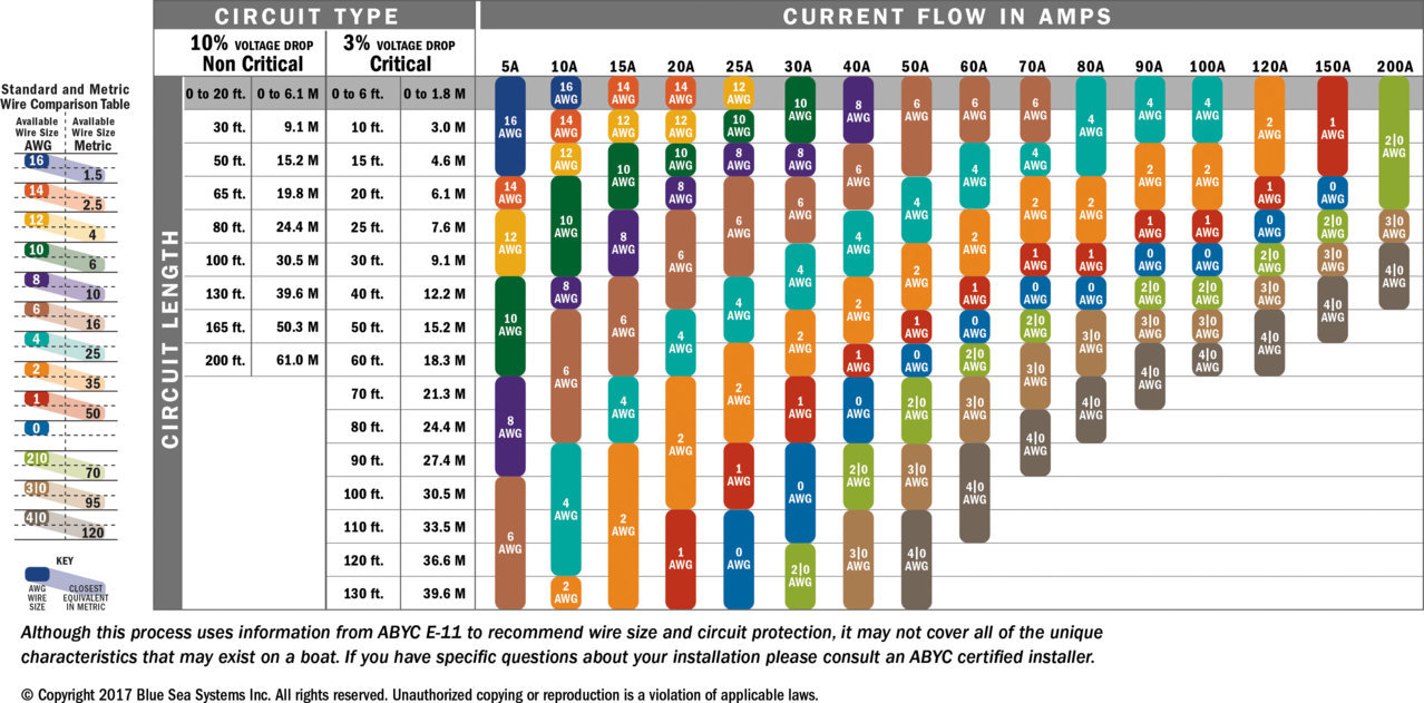

    Ok Gotcha,
    So if I was you this is what I would do.
    Id look up everything that I was going to power from that panel. Id go online and look up the specs and it should give you the draw (amps) or wattage (volts x amps).
    add them all together and that would be my minimum load considering you had it all on simultaneously. Even though you may not ever have them all on at the same time I build my system as if I would.
    Once you have that Id multiply by 25-50% so if I wanted to add more down the road I have plenty of "space".
    Now with this new number (Total calculated load @ 12v + (50% total calculated load @ 12v). well call this Load Net
    I would measure from the battery I'm going to power my accessories off of to the switch panel. Then using the chart I attached I would find the appropriate size for the run I'm going to have.
    Then I would find a service/power switch that met or exceeded my Load Net calculation. [Important! A lot of companies advertise their switches max load capacity, not their continuous. Net load needs to meet or exceed continuous rating ]
    Assuming your dual battery has a isolator/ACR set up.
    I would then mount all of my accessories in the places that they will go. I can then decide how I'm going to route my wires and measure the distances taking into account for corners, having to go under and over things, etc...
    I would record all of my measurements as I'll need them for harness construction later.
    Now I would build my harness(s) for each or all of my accessories. You can build multiple harnesses for each accessory or one big one with branches that go to each accessory. This will depend on your situation and what makes the most sense.
    after I got all of the harness/sub harness wired,loomed, and heat shrunk, I would start tucking/stuff/hiding/mounting/clamping them in place all the way back to my switch panel location.
    I would do my final mount of switch panel, install my master switch, mount any relays or any other components. I would run my circuits to my switch panel and make a service loop here. The idea here is you should be able to remove you panel easily without disconnecting anything. If you have to fight to get behind your switch panel its too tight. Another benefit of the service loop is if its done correctly can act as a drip point in the case that the loom gets water inside of or on it. The service loop should be made in such a way that it water would run down to the bottom and have to run upward against gravity in order to get to the switch where it plug in.
    I would hook it all up, test, and trouble shoot any issues.
