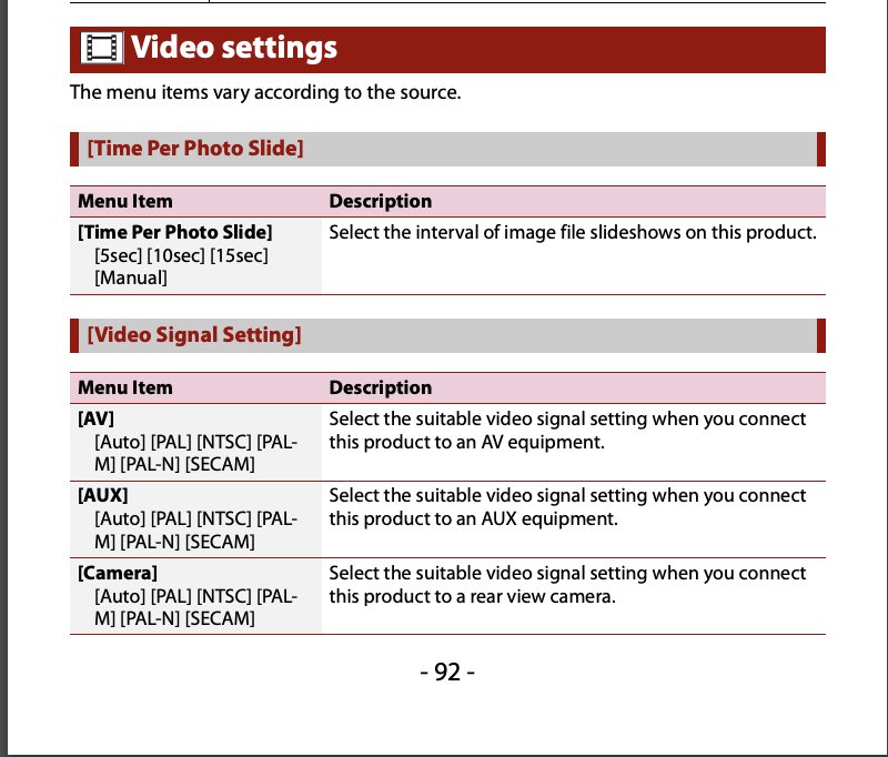

    On page 92 it talks about the video signal going to the head unit. I attached a screen shot.
    On page 105 of your head unit manual on the top right it talks about settings for video equipment. Try to go onto the headunit and play with the settings for the camera input signal. This could very possibly be the issue. Would also hold true with why it worked with other monitors.

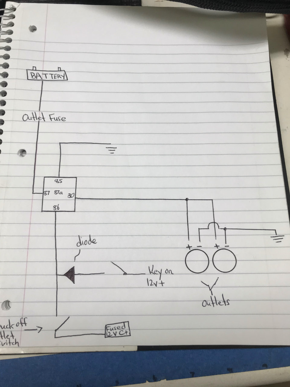

    This is one way that you can accomplish what you are trying to do. You'll have to cut the trigger wire on the back on the fuse panel. Then install a diode blocking back feeding from your "truck off on switch" which allow you to energize the relay with the truck off.

    Would I need to add another diode to ensure power from the switch doesn't back-feed into the truck's ignition circuit?

    In this configuration the 12v ignition circuit is protected by the diode. If we were to feed 12v+ to our key off outlet switch it wouldn’t have any adverse effects. Even if the switch was on we’d just be sending 12v+ to a 12v+ nothing would happen.
    By putting the diode on the 12v ignition side we are insuring that we only power your outlet relay and not the entire key on circuit

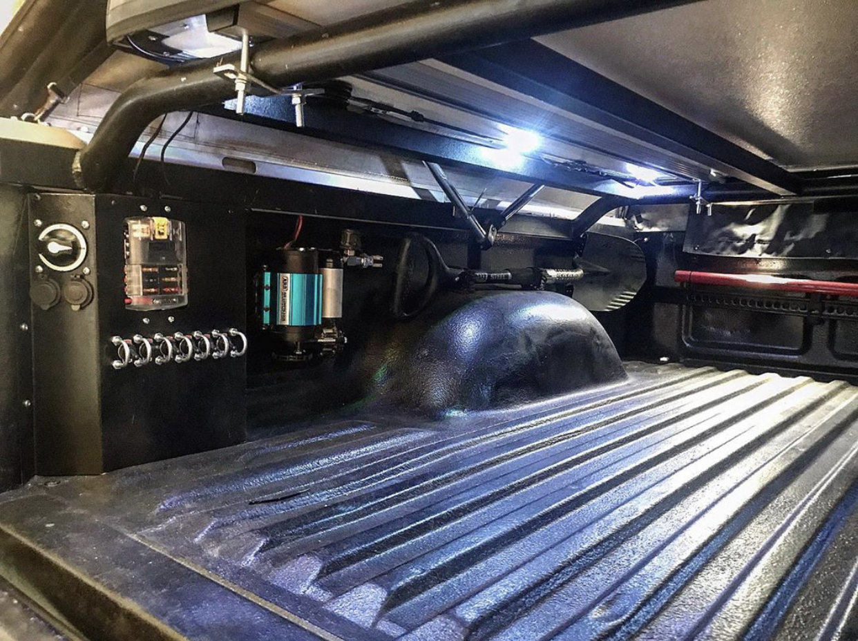

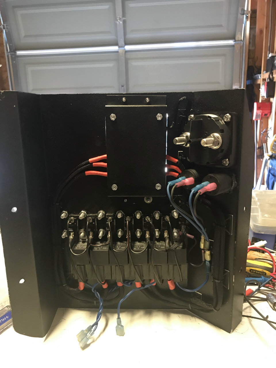

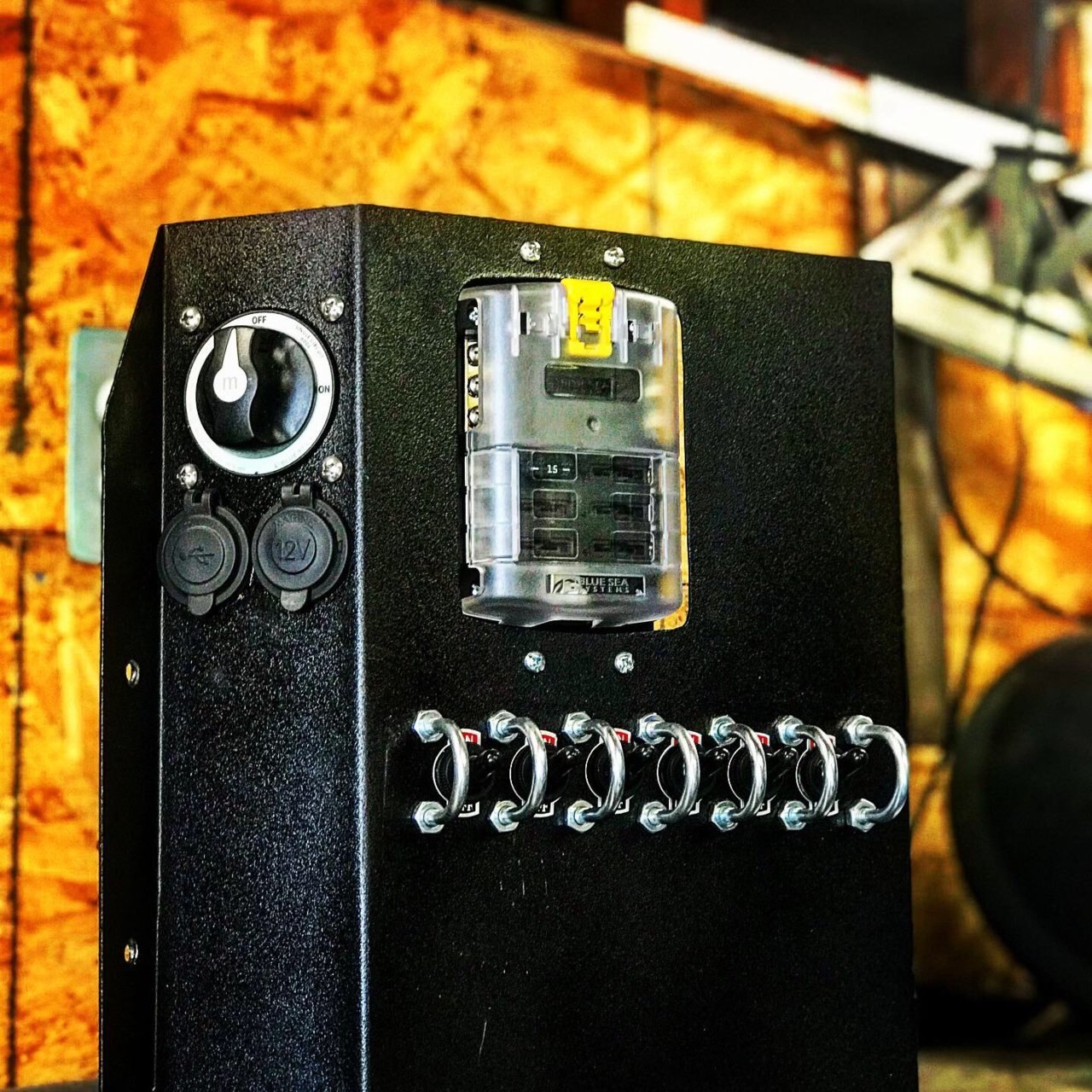

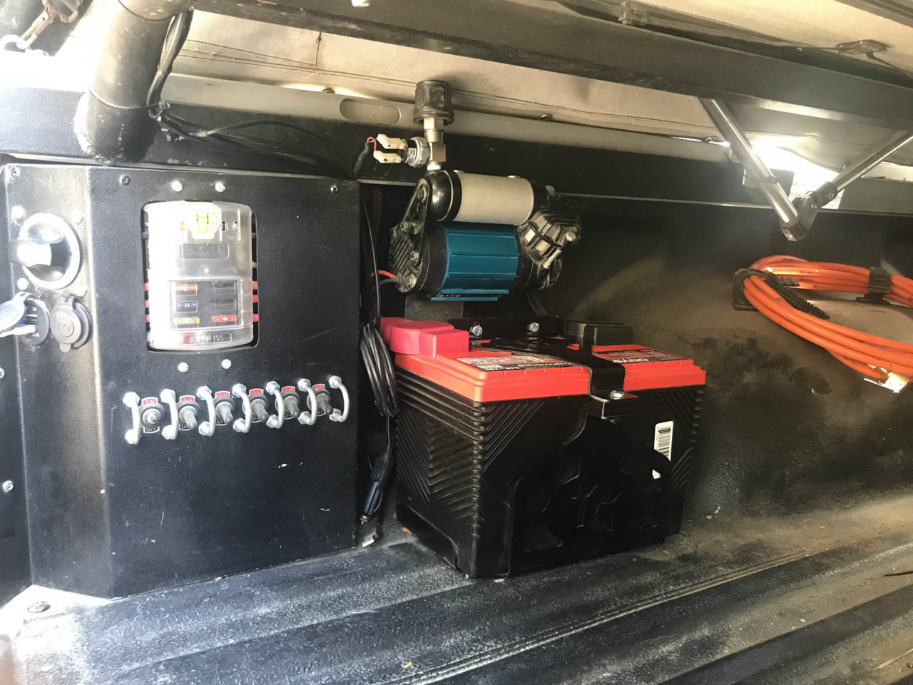

    2. I have dual batteries with one in the bed and I want to clean up my wiring over the holidays. I want to move all my accessories to the house battery, so with switches in the cab, would I just run the AOB (green) to a 14 Ga wire to the bed and locate my relay block there? From there, I will run my load wiring out from the relays.
    I have my dual battery set up with the battery in the bed as well. Heres how I did mine.
    From main starter battery---BLUE sea ML-ACR---Housing battery located in bed.
    I used 2 gauge welding cable to get from the ACR to the battery in the rear.
    I built a switch panel that also works as a electrical box in one. All of my electrical components are mounted behind the switch panel. I've attached pictures for reference. The panel is installed on the driver side corner at by the tailgate. I used rivnuts in the sheetmetal and mounted most of the electronics away from the bed so I can still wash my bed and not fry my stuff.
    This configuration has the fuses,relays,and other required components mounted close to the battery and is the most cost effective and efficient in my opinion. I did lose some bed space but eventually I'll fabricate a box under the bed with a door in the bed for the battery but until then this will work just fine.
    Ideally you want to mount your relays and fuses as close to their battery bank as possible. Then all you have to do is run your 87 relay out wires to their respective accessories and the trigger wires. If you were to use a configuration like this you can run a multi conductor cable from the switches inside to the relays in the back. This would be a nice clean and single wire running from the cab to the rear for switching. I've used CAT6 in the past and has served me well but theres other options out there that are better just cost a little more.
    I also included a picture of how I pass my large gauge wire through the bed and into my main power/maintenance switch. These are affordable and water tight cable glands. just need to drill a hole and theres a metal nut on underside. Easy, safe, cost effective.
