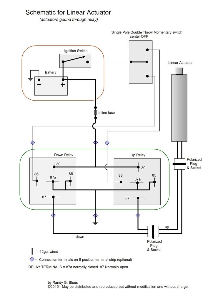

    For the mean time here’s one that was already done and is clear. The outputs going to the actuator will go to 1 and 2
    4 will go to ground
    5 will go to the ground side of one led
    6 will go to the ground of another led
    Both leds will need either constant 12v or switched 12v from the key
    this is one option

    What do you think about this? Would something like this work for you? I think you can do something with a push button that cycles the way the factory does but it might be a little more complicated. But like I said if u don’t like this way we’ll figure it out

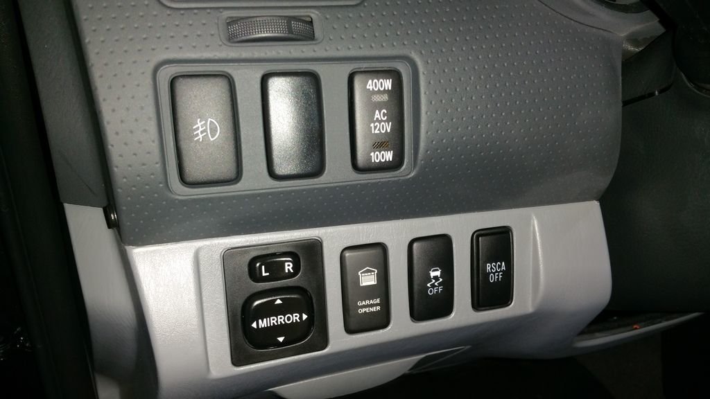

    f852eac2a66557f079aeeedf7c56bbbb.jpg the wiring looks solid, are these type switches going to work like that though?

    you might be able to find one that style but this particular set up will require a momentary on-off-on switch.
