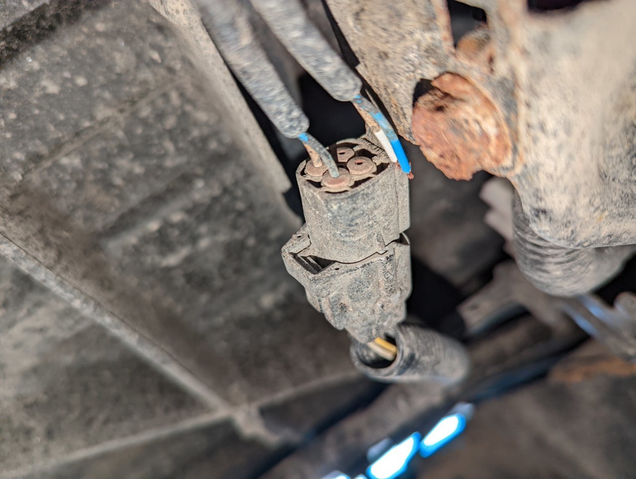

    Random question but does anyone know if a plug like this can be repinned or reconnected? Passenger side rear abs wires pulled out of the plug and drivers side abs wires still connected. Trying to figure out how to proceed on this one.

    yeah you can repin it. I would suggest buying a pigtail and soldering / adhesive lined heat shrinking the wires. If you don’t repin and have the tool with the correct die for the terminals there’s a lot of room for error.

    Thanks for the tip! I got the connector out and it looks like a pain to try to repin so I'm going to do the pigtail idea.

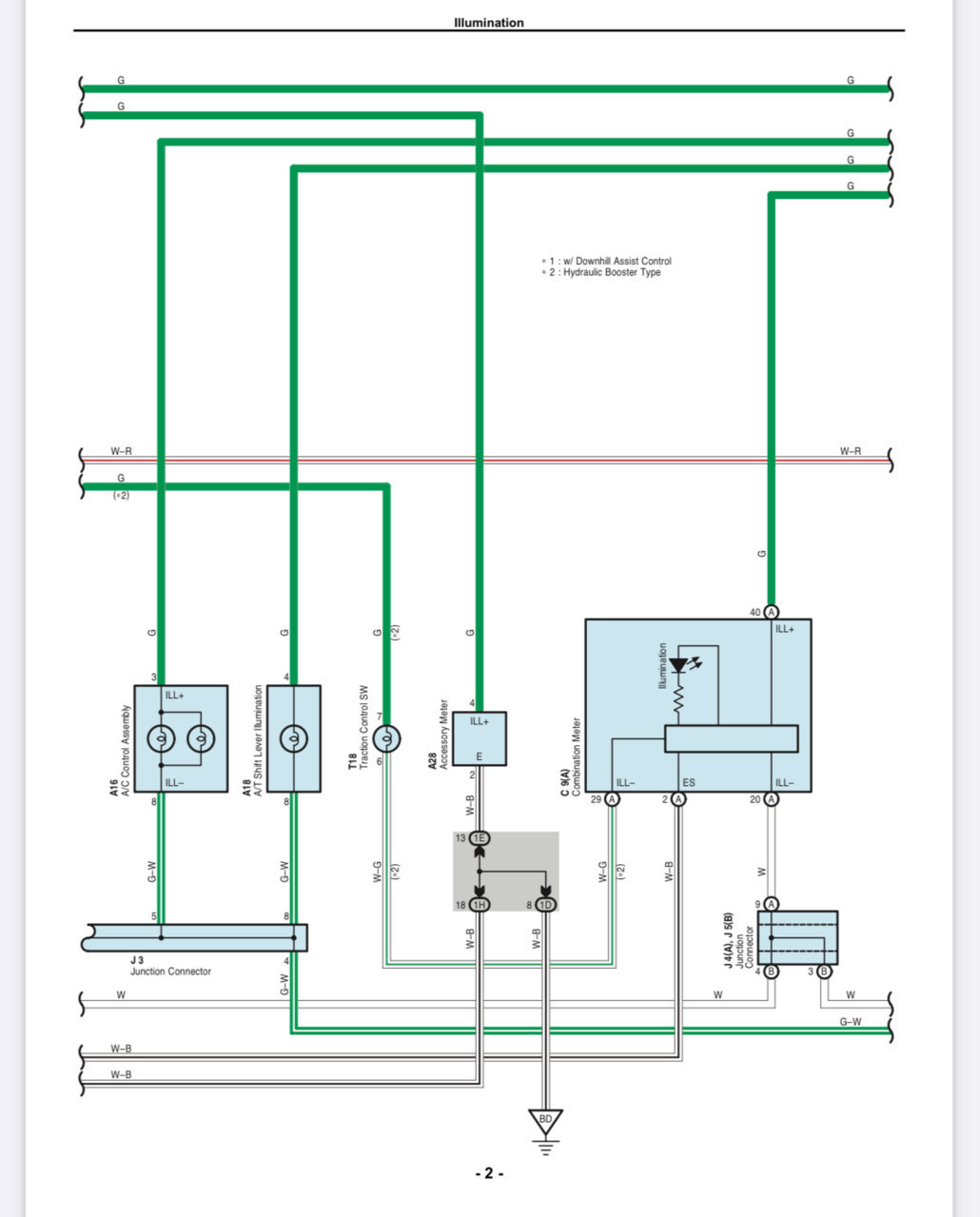

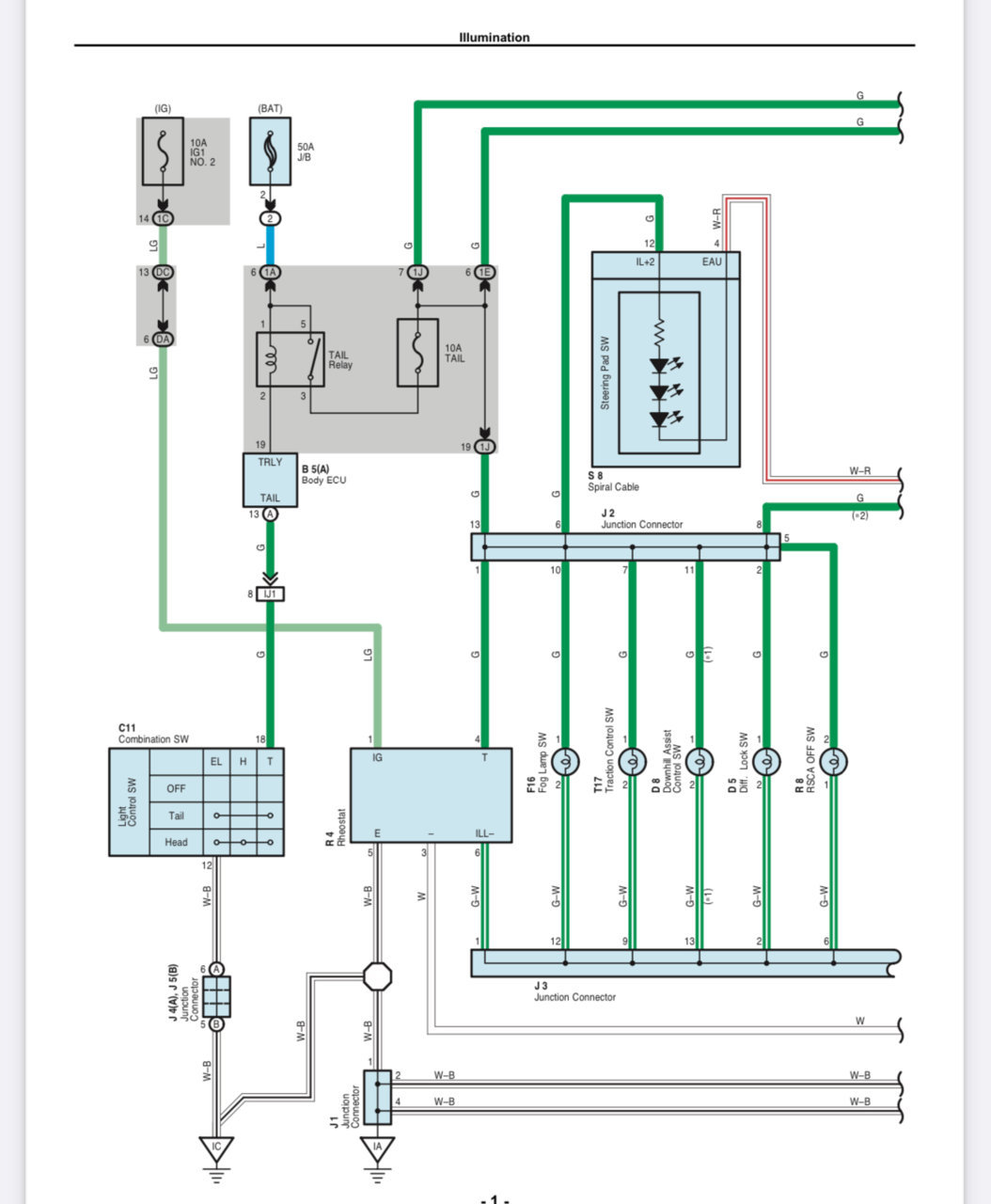

    Hi fellas, hoping for some help here. I have a harrop E-locker in the front, and I'd like to use a CH4×4 switch to power it, but I'm not sure how to make the connection. Here's the diagrams for both ends.
    If you need any more information, I'll post it up. Thanks

    you will not use red 2. Toyota does illumination different than the ch4x4 switch allows. Green goes to ignition, red 1 to the Harrop coil, black to ground. You won’t have variable dimming but you can connect red 2 to any dark green wire for the illumination circuit. It will be illuminated with parking or headlights but not dimmable, tap off another illuminated switch for the green wire.

    you’re welcome. You can see the dark green wire is at +12V when the headlight stalk is in tail or head position. The green/white is the variable ground from the rheostat dimmer, Toyota uses a variable ground and the CH4x4 switch won’t work with that setup it would need a variable positive supply for dimmable function.

    Could I just tap one of the wires on my rear locker, or A-TRAC switch for illumination?

    yes

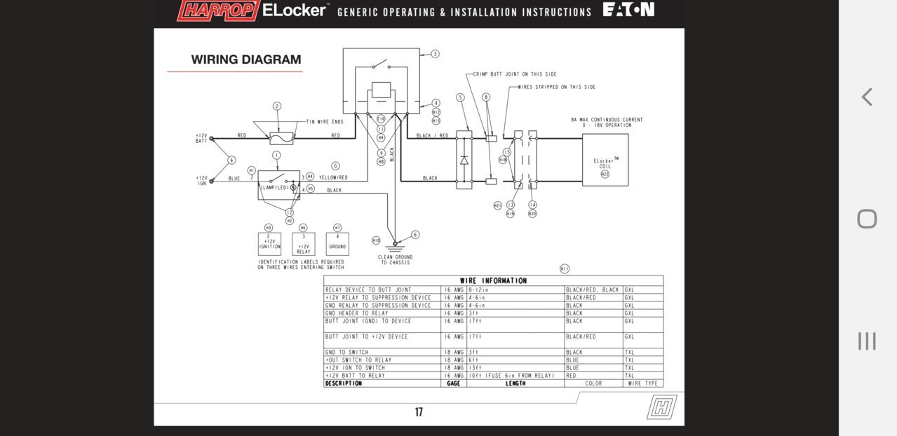

    So, as I was preparing to wire this up, I realized that the E-locker diagram doesn't match the wires coming out of the Harrop switch. The blue wire is labeled ignition, yellow/red is relay and black is ground.
    Is the only change: red1 goes to yellow/red, and the other 2 wires remain the same? Here is the CH4X4 diagram for reference.
