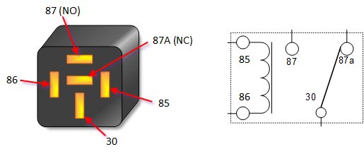

    Umm - Aren't you going to let the magic smoke escape when the contacts close between 30 and 87A ?????

    Seems suspicious to me too.I don't think 87a should be grounded.
    For reference:
    DC92T and PhenixFord[QUOTED] like this.

    30----I I------87
    30----I\I-----87A

    That’s because they drew the diagram upside down.
    that’s why it’s important to fuse relays :thumbsup:

    Maybe he just had a brain-fart? IDK? But someone needs to point it out. :)

    You’re absolutely right good catch.
    you're absolutely right...that diagram is incorrect and would pop at fuse pretty quick. Good catch. I’ll have to edit that diagram.

    @IvanhoeTaco with regards to the diagram. The outputs to the actuator will go on position 30
    the fused 12v will go to 87. As mentioned above it’s drawn upside down in a sense. If you flip those two it will function.
    With the switch in the off position both leads will be grounded.
    Switch up will give you one direction and down the other as the relays will flip flop between positive a negative

    Yeah that was almost a fuse killer in the making. Thanks for the check
