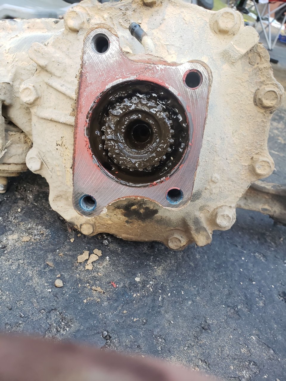

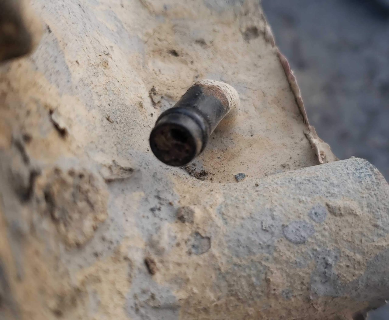

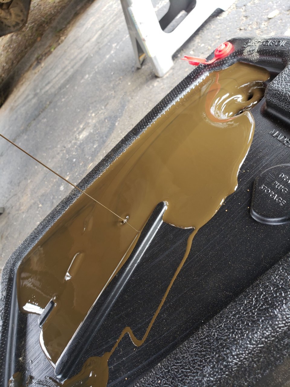

    Make sure you block the old vacuum hose ports on the diff tube. I learned the hard way what happens when muddy water gets in there. It needs to be sealed up with a breather ran as high as possible. 20190202_165807.jpg 20190202_164347.jpg 20190202_103842.jpg

    Isn’t that hardline coming out a vent? Not a vacuum

    It is. That's where I should have attached the breather hose. You live and you learn.

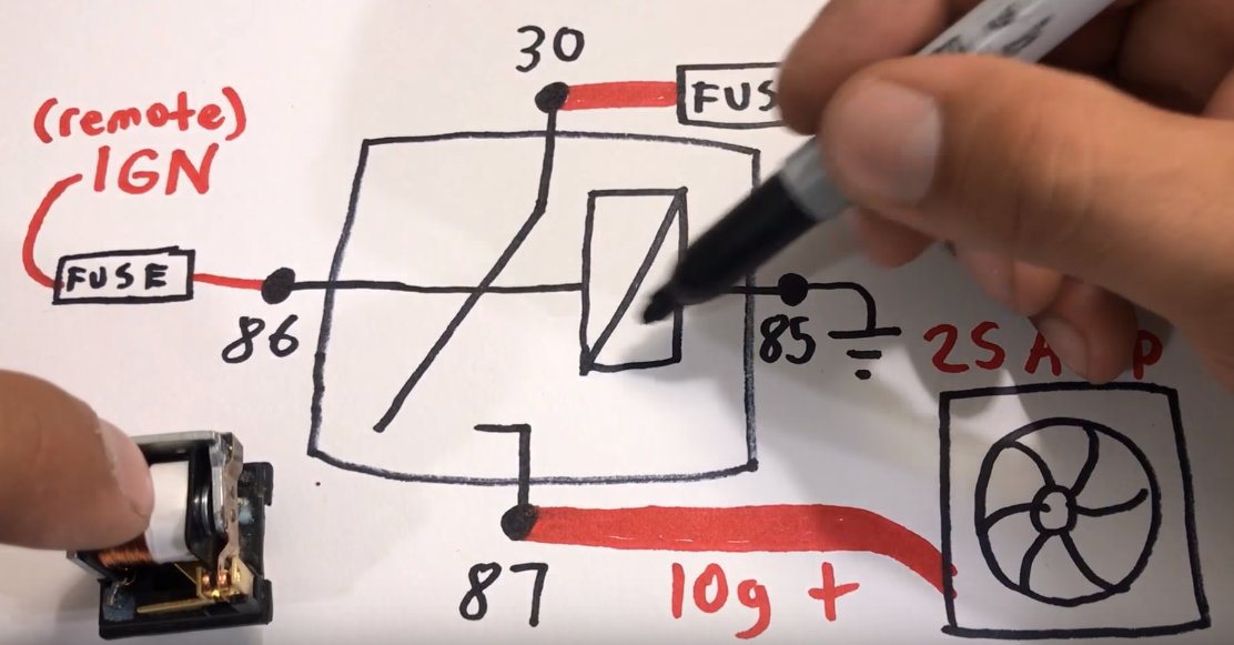

    Been seeing this on occasion while researching an aux fuse panel... how many of you would fuse the relay signal/control wire (#86 on relay leads to pin #3 on most switches)?
    Not everyone does it/mentions it but I've come across a few that do. Wondering just how necessary this is...

    All circuits need to be fused as close to their source of power as possible.

    As mentioned before all circuits should be fused. That being said the amount of current that is required to energize the coil inside of a relay is very small. It’s up to you if you want fuse it and it will depend on the circuit. I use very small multi conductor wire for my relay triggers because it’s nice to have all my triggers run through one wire.
